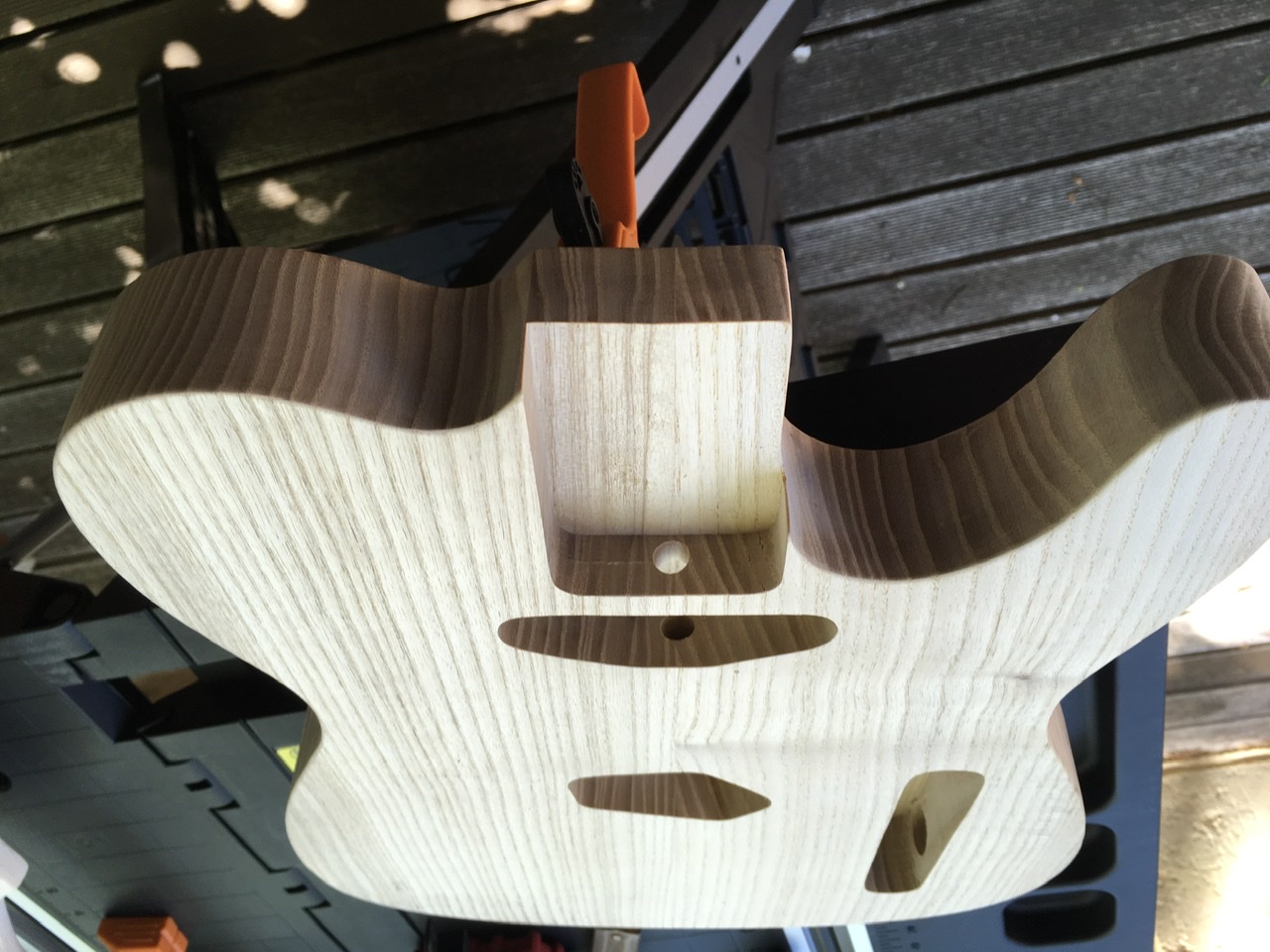

    So. First actual day of building and not just ordering crap from online.

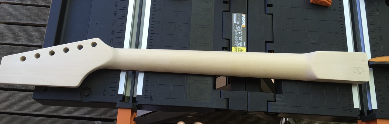

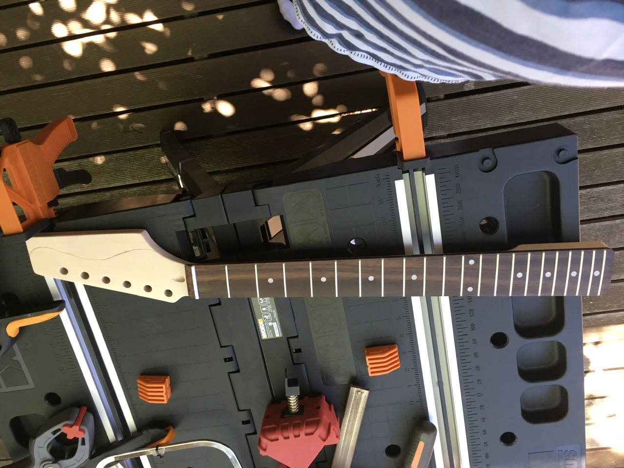

    Have decided my headstock shape (see photo of the outline).

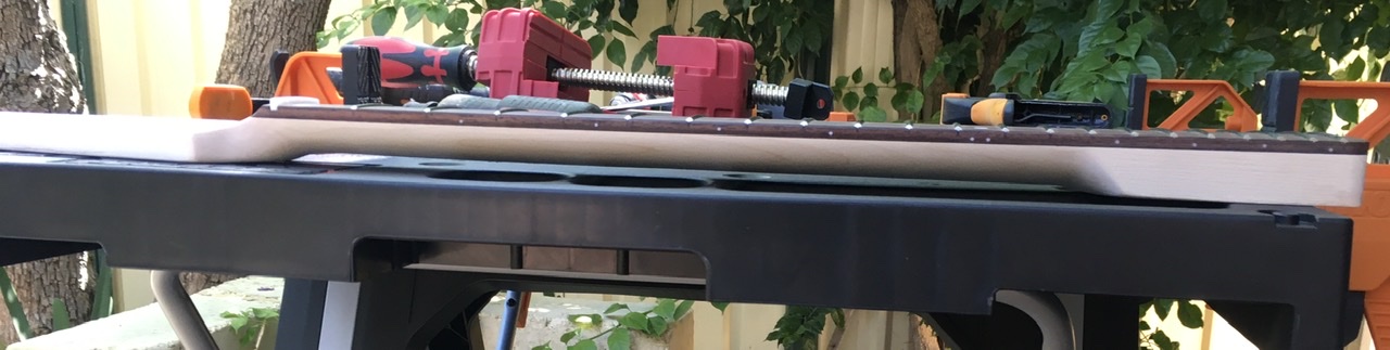

    Checked the neck and body. Alignment seems ok but I will check that properly...now that I have the requisite wooden straightedges to check. Bridge hasn’t arrived yet but should be here next week.

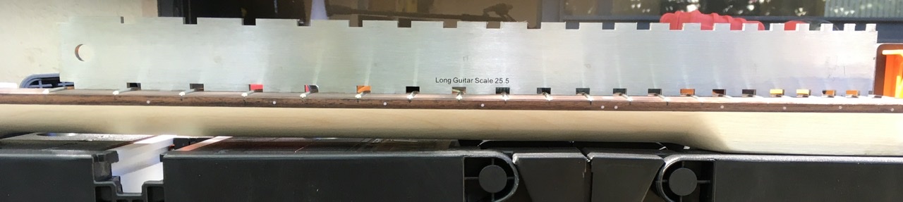

    I have the tools I bought from pit bull and using the notched straightedge, the neck seem fairly straight, with no relief. That should change with string tension but I think straight when I’m doing fretwork is best. So about to cut headstock and tape the fretboard so I can start levelling and finishing the frets.

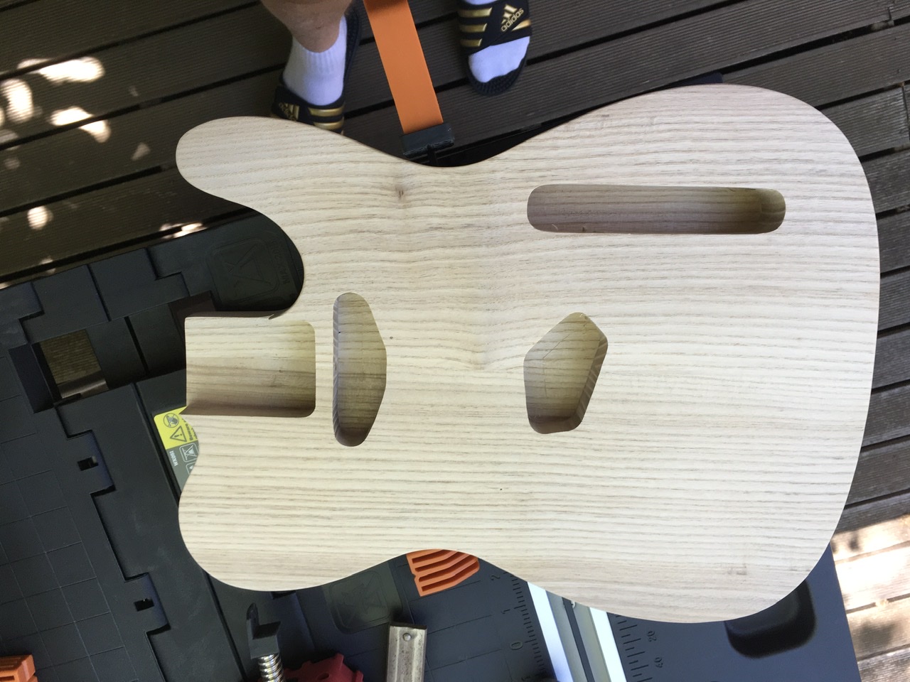

    The body seems ok. Some machining marks but sandable and basically wood quality (so far).

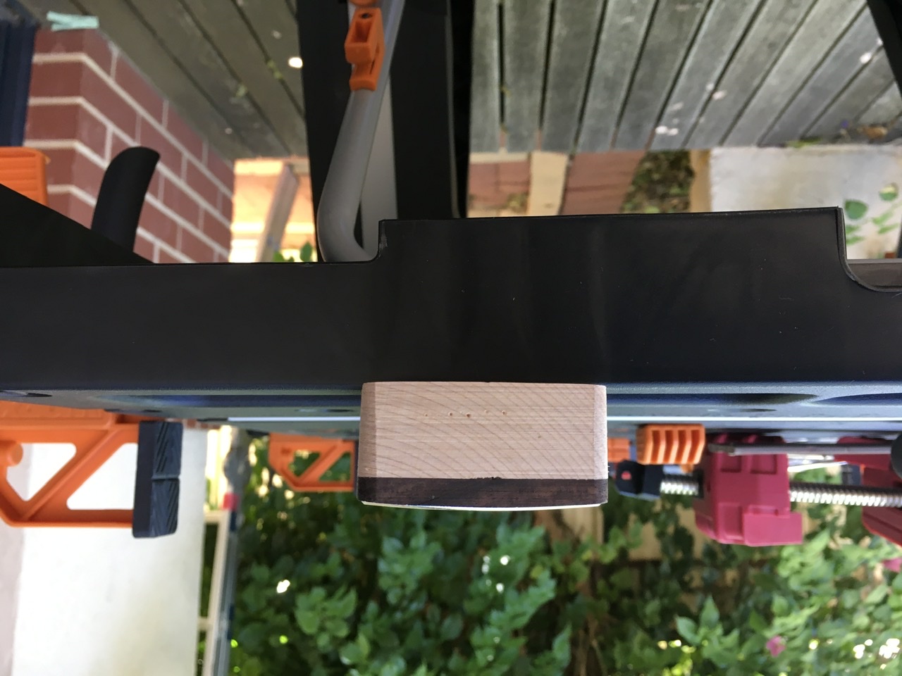

    The neck, as I said, is straight. Some small indentations in the end (see photo) which could be, maybe punch marks or something. Not a problem as it will be covered up. 1 minor scratch in the back but sand able.
    Let the fretwork taping and head stock cut out begin!

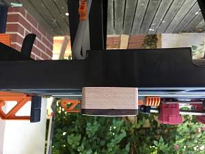

    Here are neck indentationsClick image for larger version.
    Tiny and removable.
    Also, the neck alignment. Seems to fall away a couple of mm at the 20th fret.....I never use it anyway!

    LOL! Thats really a lovely Tele body you scored there,I love the tight parallel grain structure, Should come up wonderfully.

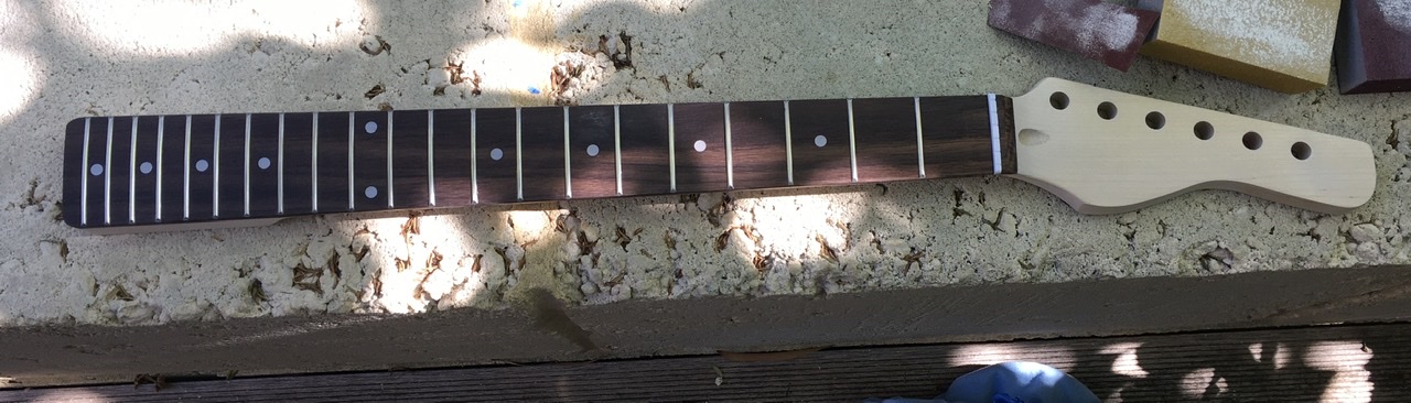

    Neck work finished. Headstock shape cut and sanded, frets levelled, crowned and polished. The fret ends have been sanded and sharp edges removed. Ready to stain and apply finishing oil tomorrow!

    Thank you. It started as a freehand drawing, then much, much sanding until I was happy with it!

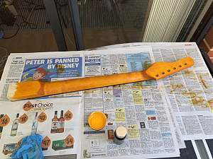

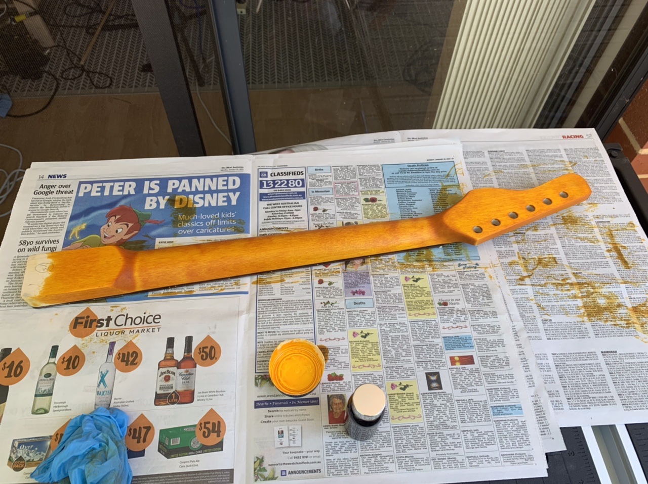

    Neck staining time this morning.
    Sanded the neck to 1200 grit...probably excessive but it sure feels smooth.
    Using the Dingobass bloodwood stain (which has turned out more orange yellow...like Donald Trump’s face...almost..perhaps he should rename the stain “trump face orange?) but it is also like “haven’t had enough fluids my pee is a bad colour yellow..which is kinda the same thing as trump face orange.
    Happy with the result though. Now hanging in my music room to dry for 24 hours (or so.....)
    From this:
    To this:
