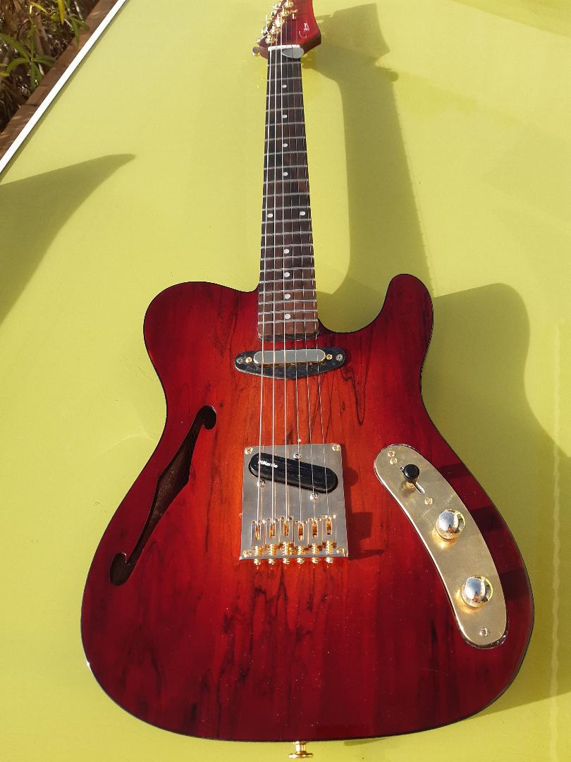

    Tl finished in march
    body and neck made in epoxy resin coloured an PU varnishClick image for larger version.
    banana platte custom made in a brass plate
    micro plate was made in a carbon sheet

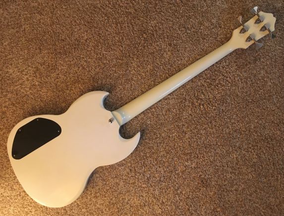

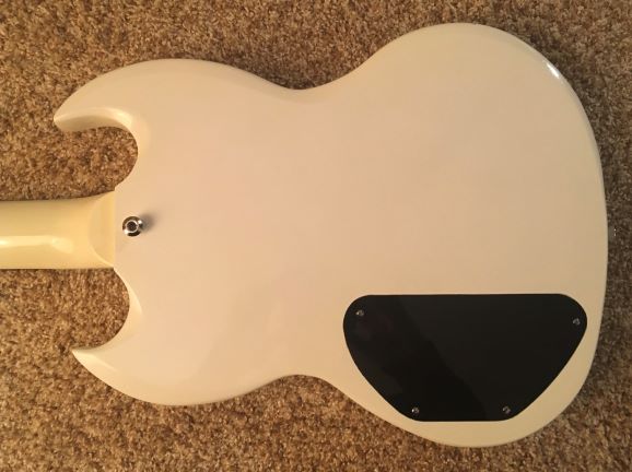

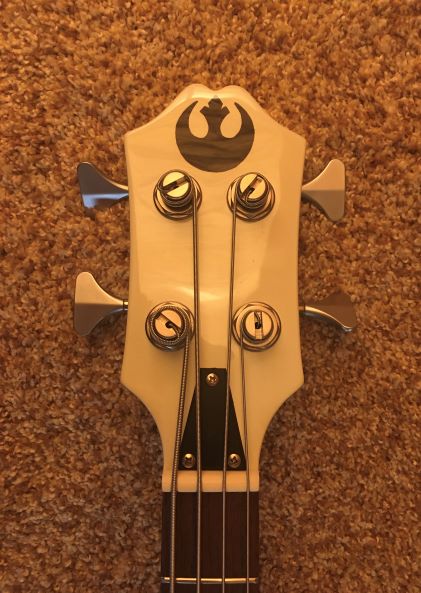

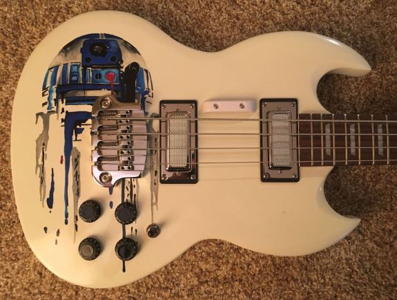

    AGB-30 Star Wars Themed Bass
    This is my first bass build. It's an AGB-30 kit. It took me approximately 2.5 months to build. The R2D2 graphic is hand painted onto the guitar. Solid white paint with polyurethane finish. The pickups are custom designed silver foil mini-humbuckers made by Josh Gravelin. Upgraded hipshot bridge and tuning machines, upgraded CTS pots, added a three-way switch, and the volume and tone knobs actually go to 11. Plays beautifully. I couldn't be happier with how it came out. I hope you all like it!

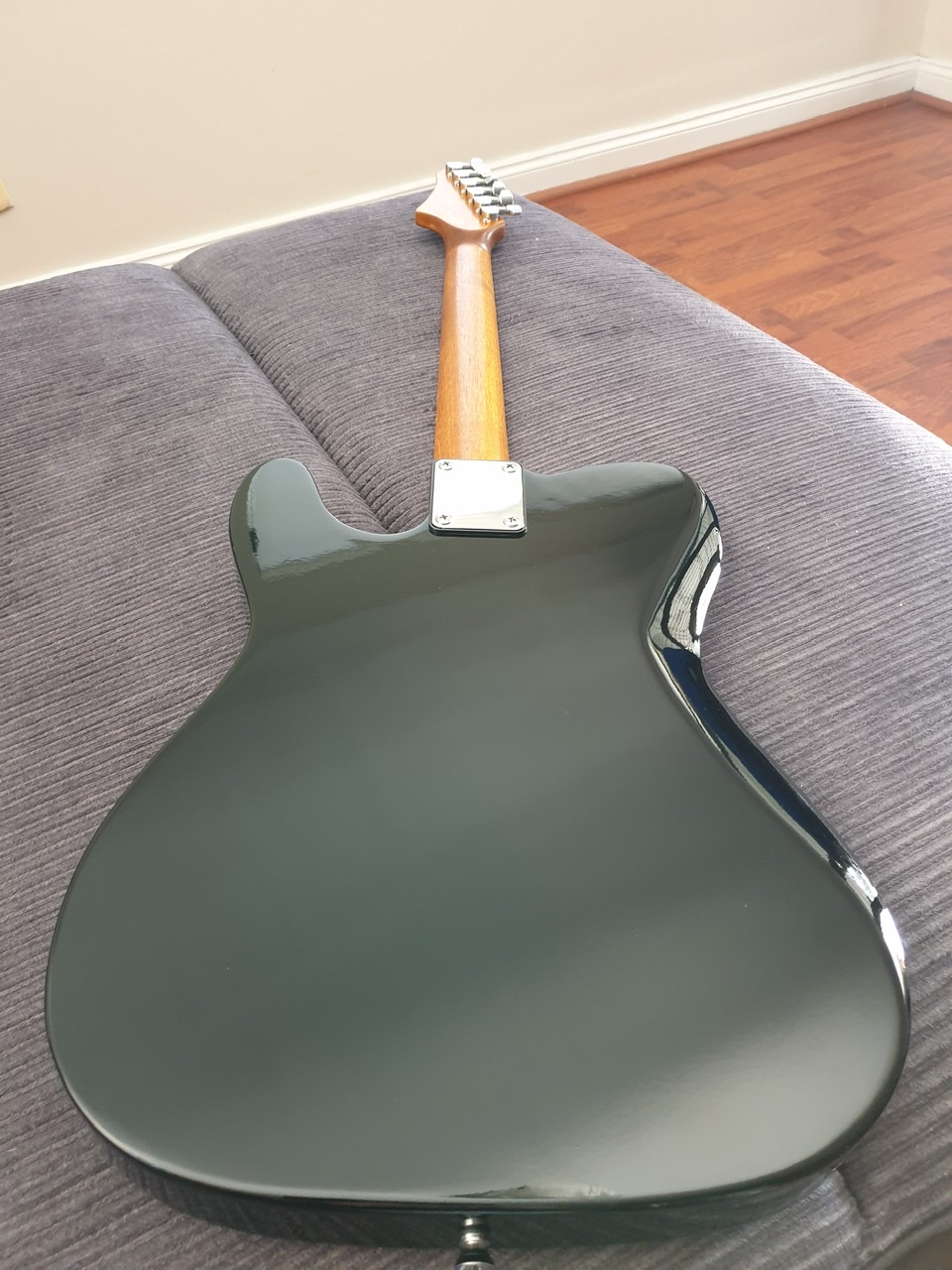

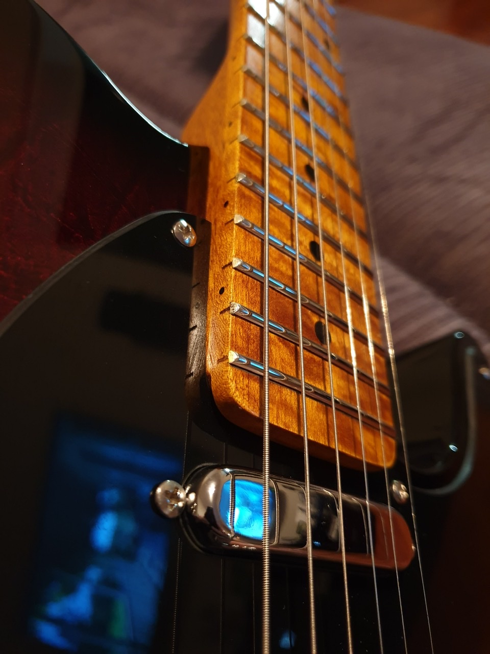

    TL1 all stock.
    This was my first build, took a few months because of the paint work.
    Body was high fill primed and blocked flat, then painted with a black base, a silver marble effect was painted to the face, two coats of blood red candy, then more black was airbrushed to create the fade, finally a lot of clear coat, again blocked back then buffed.
    Neck was stained with golden teak stain and finished off with tru oil.
    This guitar will go down as the start of my addiction lol

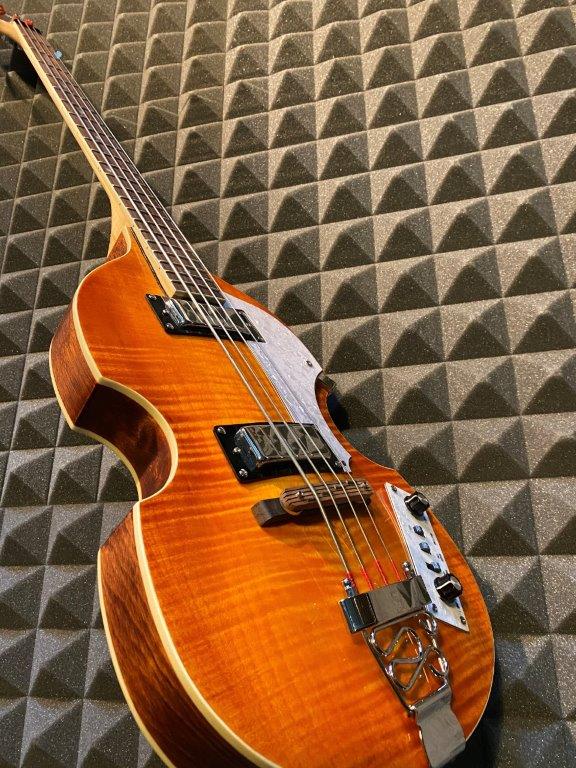

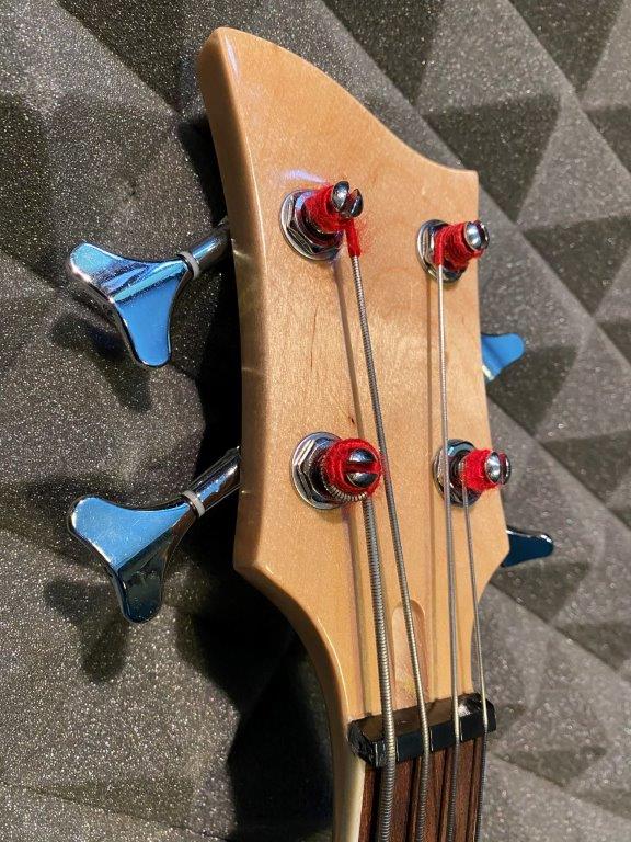

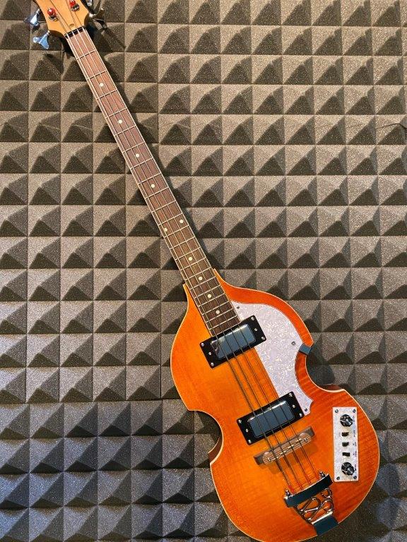

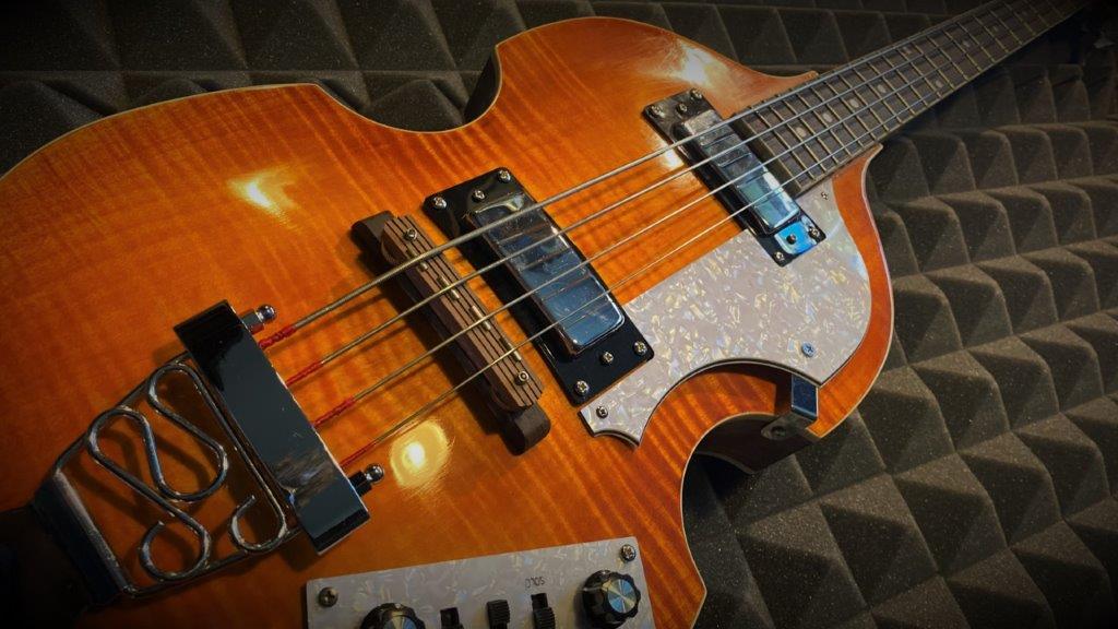

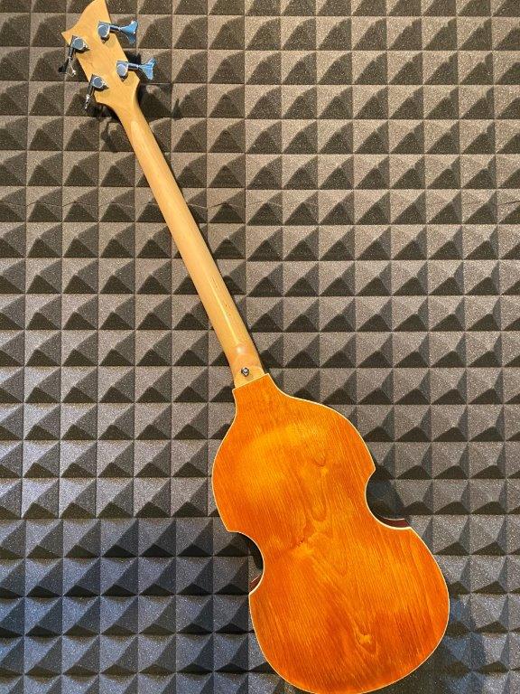

  14. #10
    Here is my HB4 Build, (in the correct month). I'm really please with how it looks, but even more pleased with how it plays and sounds. Took me about 10 months with lots of help from my friend Brian. My build diary has lots more photos. The tuning pegs are on an angle to allow it to fit into the case.
