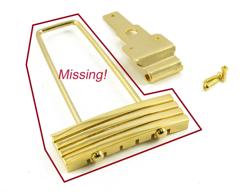

must be the month for it, WD Music in the US sent me 1/2 a bridge, they did a stock take and found they had 1/2 a bridge too many so it's on its way.Attachment 12343
