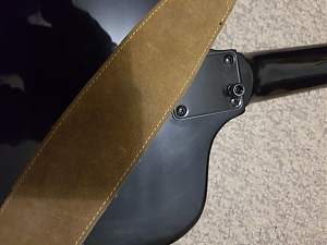

    +1 on Wazz's comments about putting the strap button on the neck plate, here's a photo of mine, in the top front corner just below the bolt - it balances perfectly.
    I'll be interested to hear how you go with the thumb rest, I'm also thinking about fitting one. Resting my thumb on the bridge p/up works pretty well but I'd like the option of playing a bit further forward too.

    Bill....I like your idea.
    Stupidly I had searched YouTube and found several videos about fitting a sneaky strap button on the front of the body protrusion under the neck pocket. Drilled and mounted the strap button.....can’t get the strap on....bugger.
    I think I will drill out my black strap lock button just a little and use a proper neck screw.

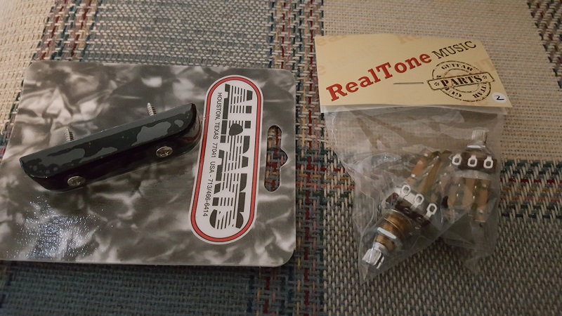

    I ordered a $4-00 thumb rest and 2 x push pull pots....and they have arrived.

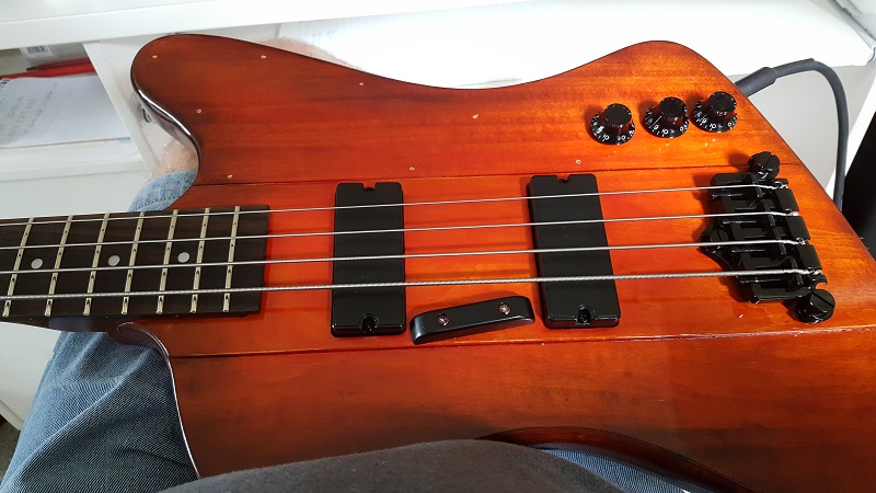

    I looked at a number of photos on the net about placement of thumbrests....the angled layout seems to be the norm. I had no idea why....but I did it in a position I can use....considering the closeness of the raised edge on the TBird style kit.
    Using a pick, finger, and my shitty attempt at slap is all good.
    So comfortable and without looking I can feel that I am plucking in the right place. I have the pickguard off.....used my water slide decals on it....waiting for rain to leave and humidity to go down so I can spray clear to seal the decal.

    Issues for me....
    http://www.buildyourownguitar.com.au...humbucker+bass
    and this one...
    I don't have the big thumping MM style humbuckers in this bass.....just the little blackout style Chinese pickups.
    Thanks to Wazkelly and others for the info above....but what goes where on these bad boy pots....they have three normal lugs up the top and a number of pins underneath.....what???
    I would like to be able to have both pickups playing as normal....split the neck and hear the front coil only....split the bridge and hear the back coil only.
    Please help.....I am lost in the wireness.
