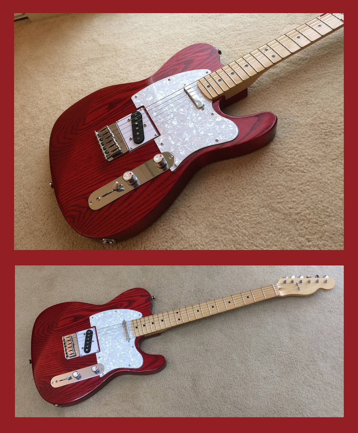

    Hey ozzbike. I'll look forward to what you come out with. You have excellent finishing skills!
    With my Ash tele, I grain filled with Ebony Timbermate, then used Colortone Cherry Red dye. It really contrasts the grain. Ash is great that way (even if grain filling is a huge PITA) and truly a shame to cover up with a solid colour.
    Can't wait to see your first pics!
    Mick
Name:	2018 Tele v2.0 1500.jpg
  3. Liked by: Tony M
