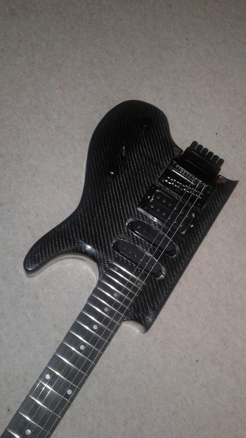

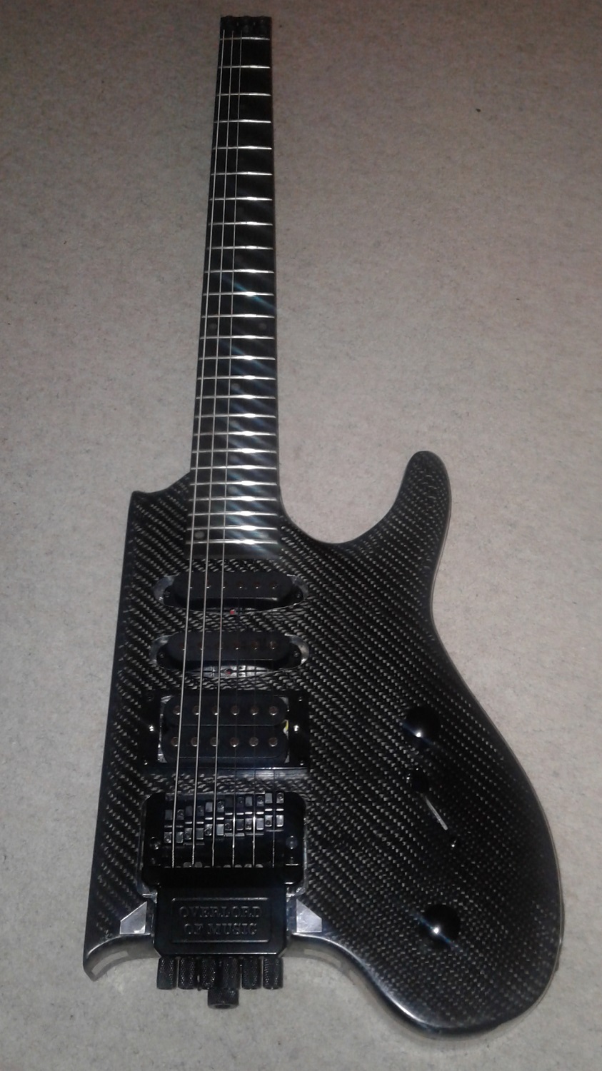

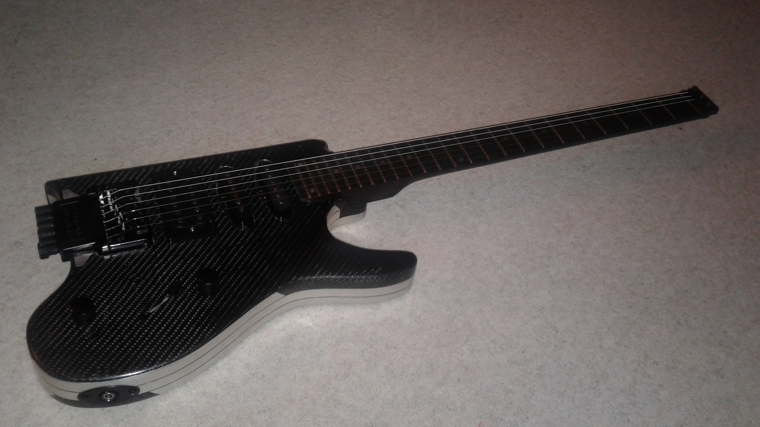

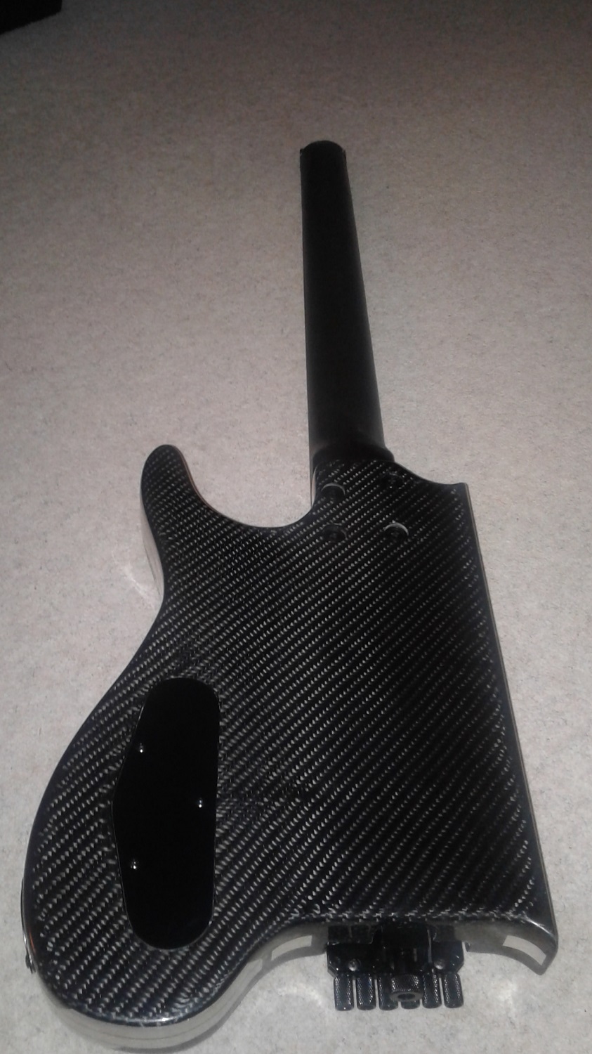

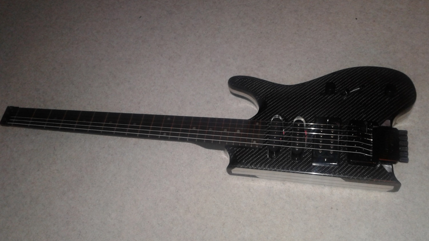

Here is my completed SH-1
The body has been cropped at the top and then carbon fibre skinned.
Silver tape has been jused to cover the carbon cloth joints.
The neck and fretboard have been eboney black stained with the neck being finished in danish oil.
The bridge has been lowered by 3mm into the body compared to the standard kit and the neck has a 0.5 deg shim to give a really low action after the frets where levelled and re-shaped.
