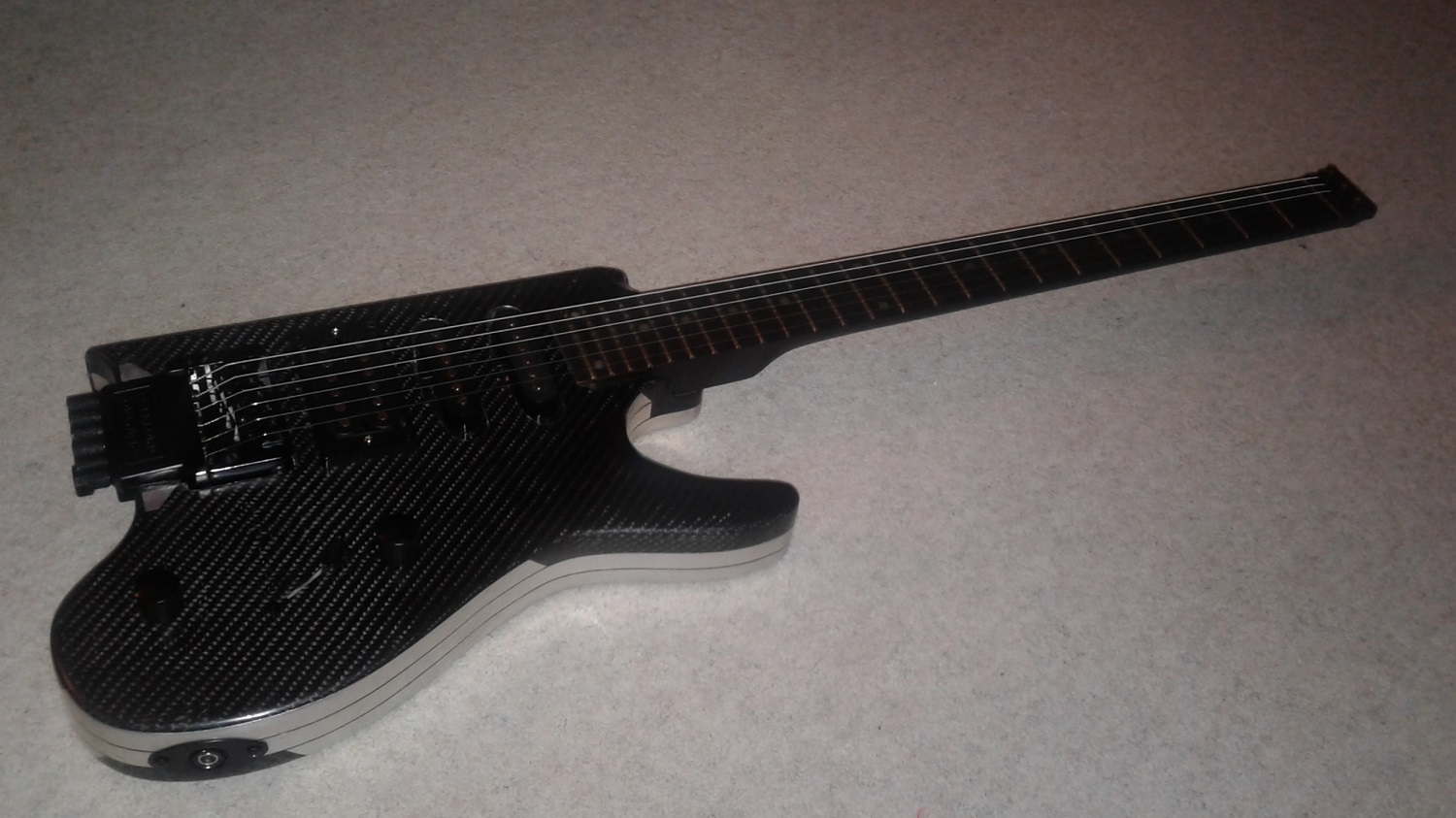

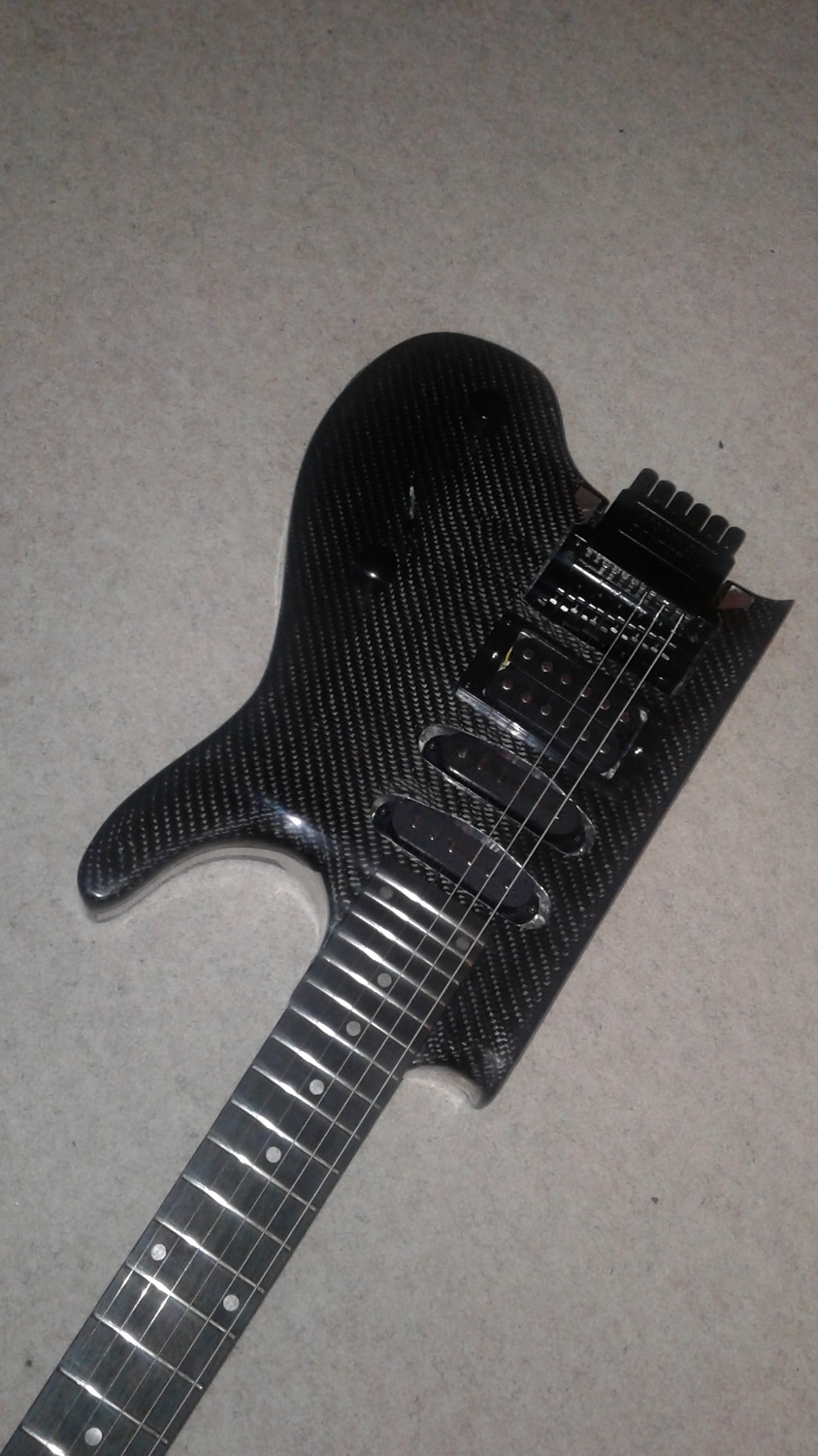

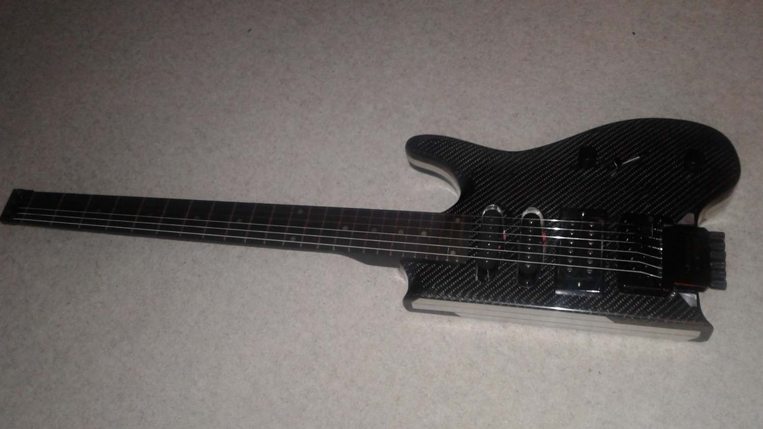

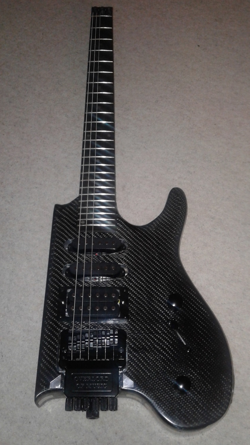

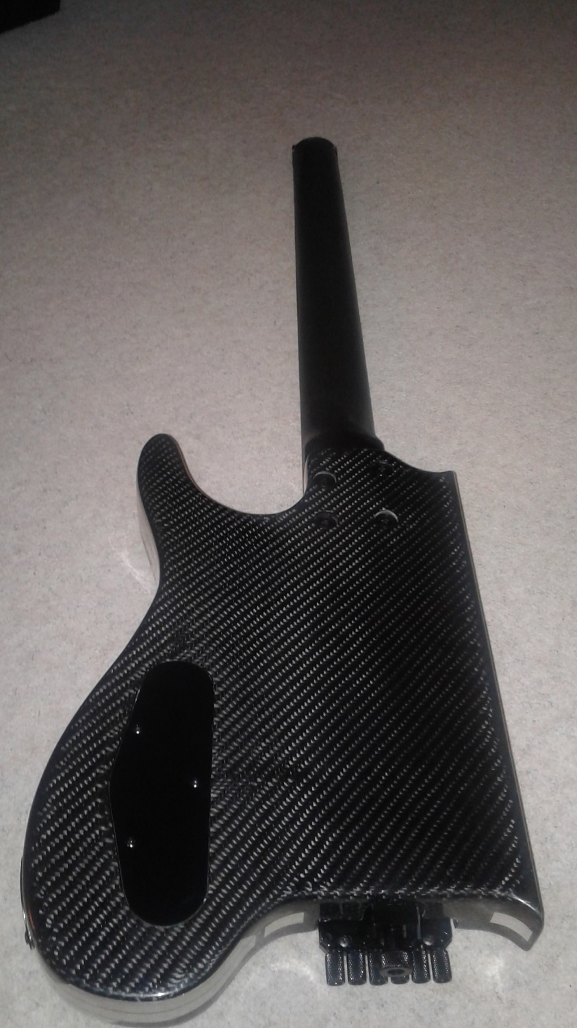

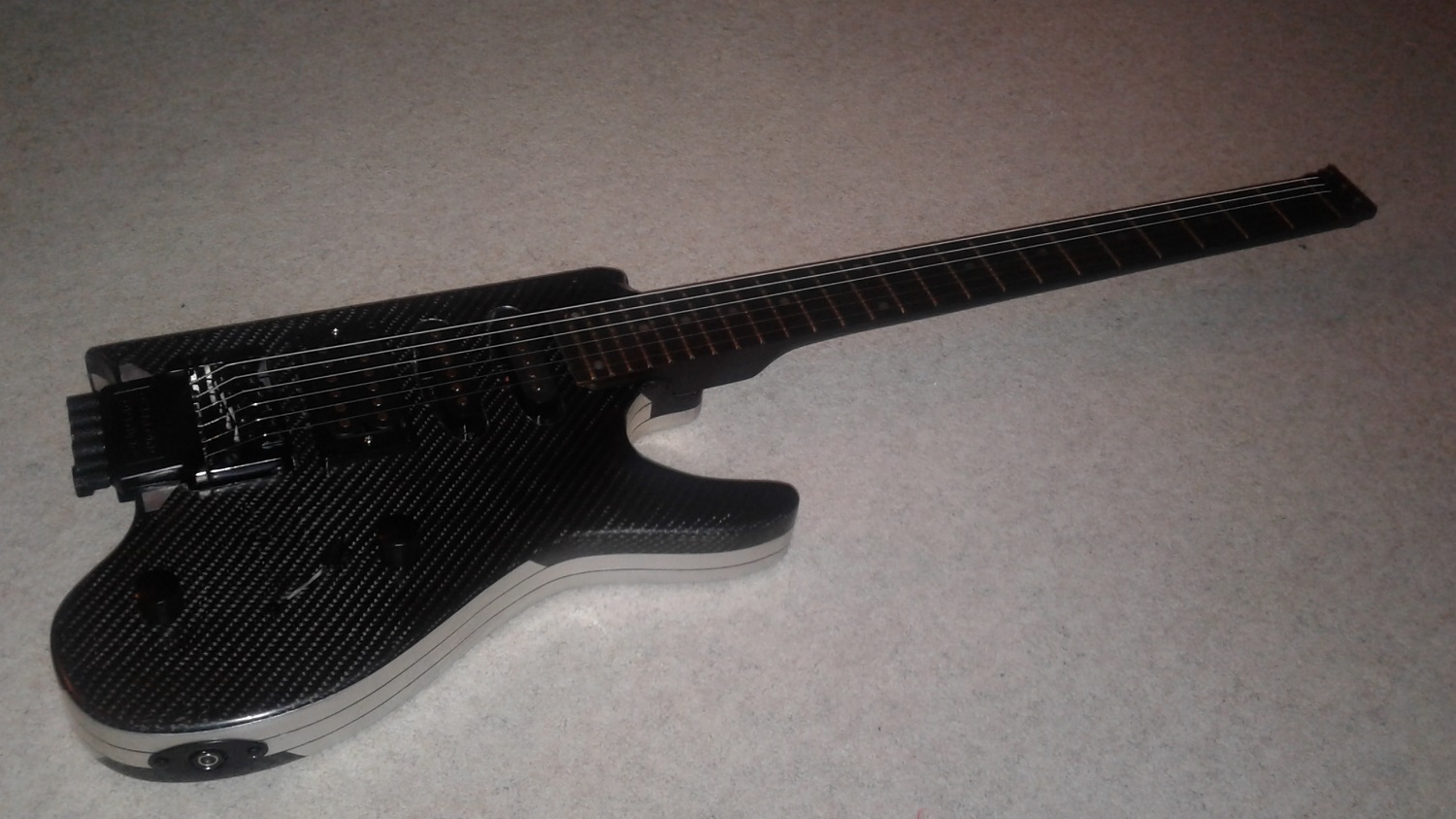

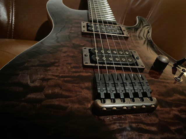

    Here is my completed SH-1 (first ever guitar build)
    The body has been cropped at the top and then carbon fibre skinned.
    Silver tape has been jused to cover the carbon cloth joints.
    The neck and fretboard have been eboney black stained with the neck being finished in danish oil.
    The bridge has been lowered by 3mm into the body compared to the standard kit and the neck has a 0.5 deg shim to give a really low action after the frets where levelled and re-shaped.

  5. #3
    5,666
    Yep. Comp over. Just give the man the gong now.
    Absolute stunner, taking an already out there kit and pushing it that teensy little mile further out.
    Fine work mate, very fine work!

    Thanks for the comment FrankenWashie it's appreciated.

    That's a very special piece of kit!

    Member PJSprog's Avatar
    Dec 2018
    Trenton, Illinois, USA
    230
    That is definitely a unique instrument, HSB. That carbon fiber look is just over the top cool. Nice work.

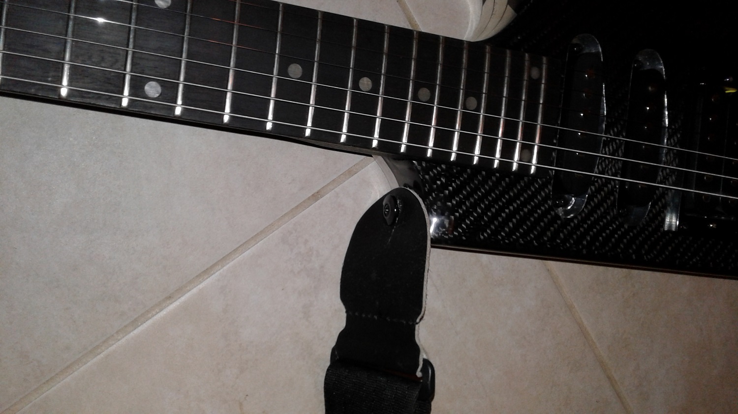

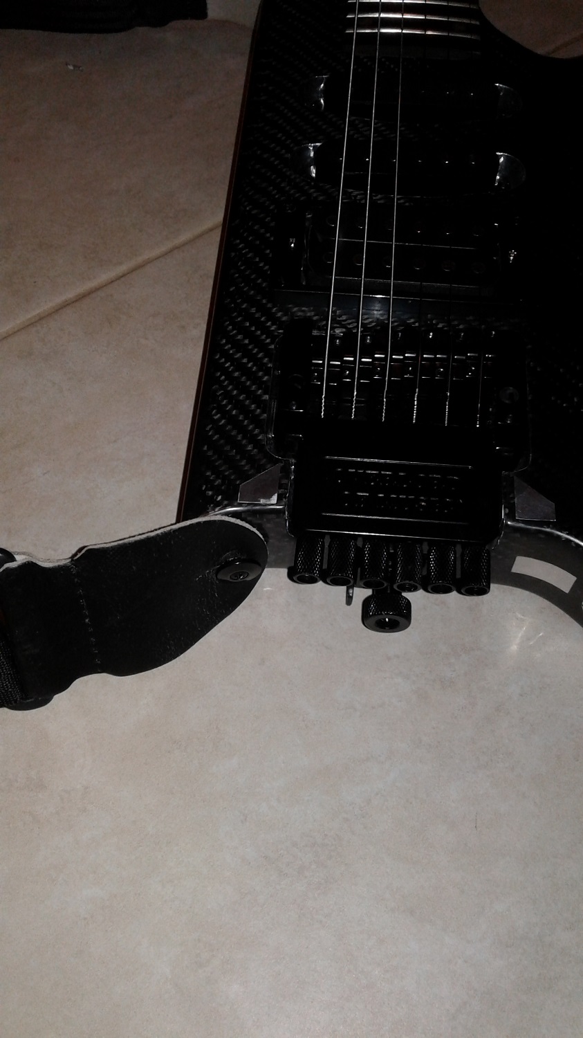

    Looks cool. Just wondering where the strap buttons are as it might need them some day?
  11. #8
    Have since fitted buttons as shown

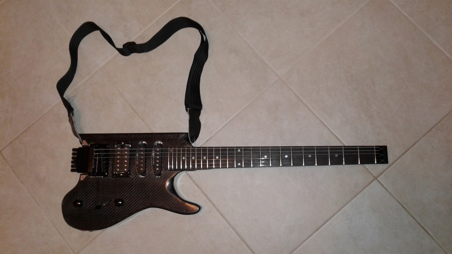

ID:	33004Click image for larger version.
