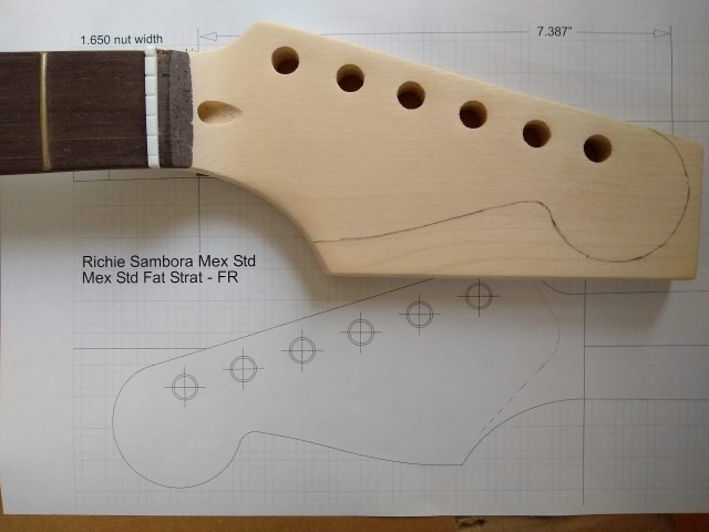

    For the neck, I haven't decided between raw wood, wipe-on poly satin over a stain, or Tru-oil. I am going for a classic look somewhere in the region of a lake placid blue thinline deluxe. I plan on keeping things simple with a 72 thinline headstock shape.

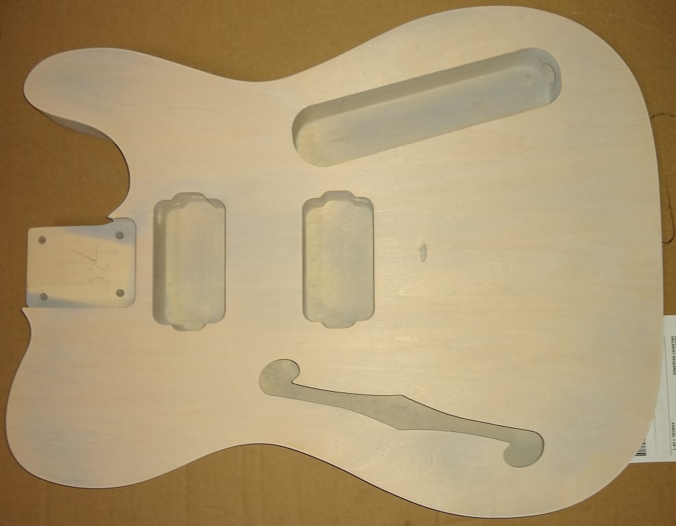

    Also, what is the purpose or origin of this hole under where the bridge will go? Should I just fill it and sand flat?

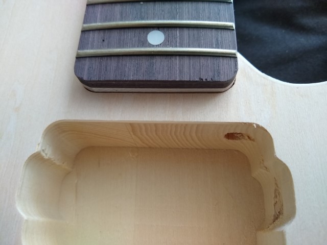

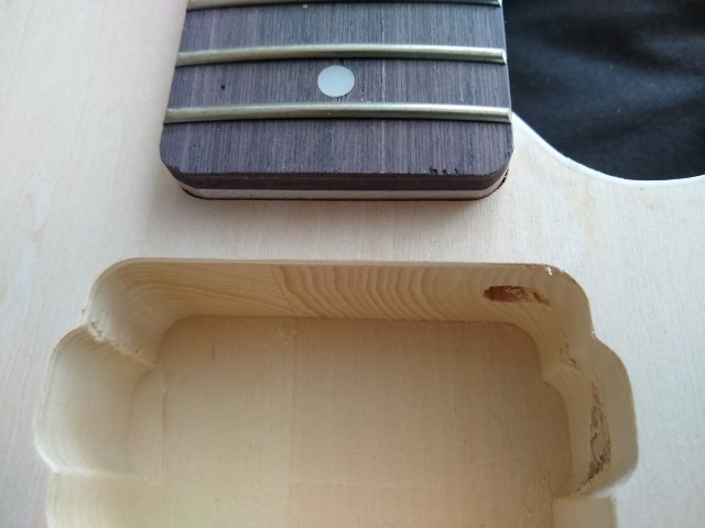

    Neck fit looks good to me:

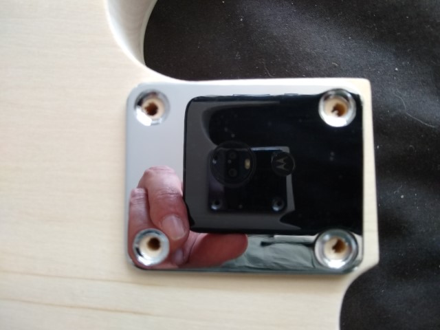

    Neck plate holes are not quite aligned:
    While I could ignore this since it is close, would it be better to fill and drill new holes to get the plate square? Maybe I will test if there is enough wiggle-room to get the plate lined up with the existing holes.
    That hole under the bridge is for your earth wire - pretty important it stays there. The slightly misaligned holes are on the neck plate are very common. Personally I would ream out the holes to be slightly wider and allow the screws to easily slip through. Then you can make sure the holes in the neck square everything up. It's not necessary for the screws to bite into the body wood, it's all about overall clamping force. Normally if you just tighten the screws progressively in a cross pattern it squares up OK.
