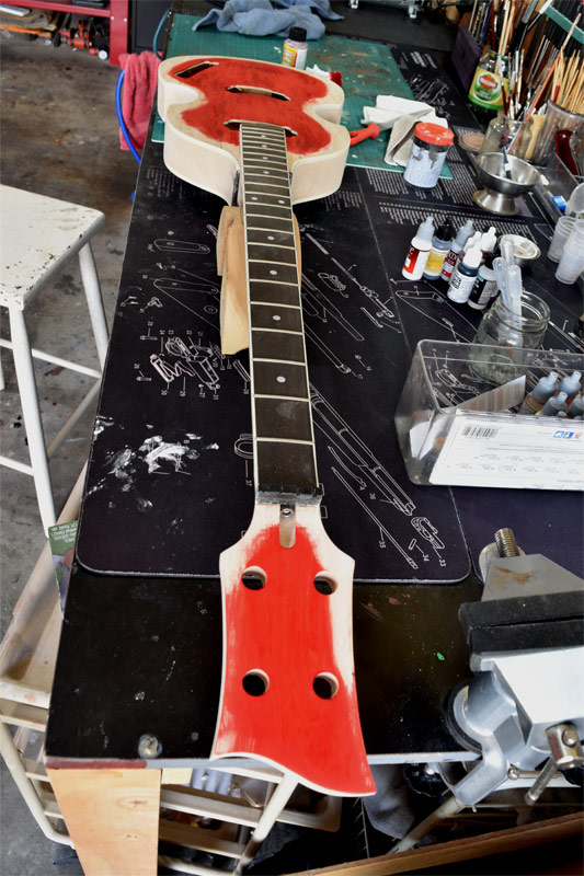

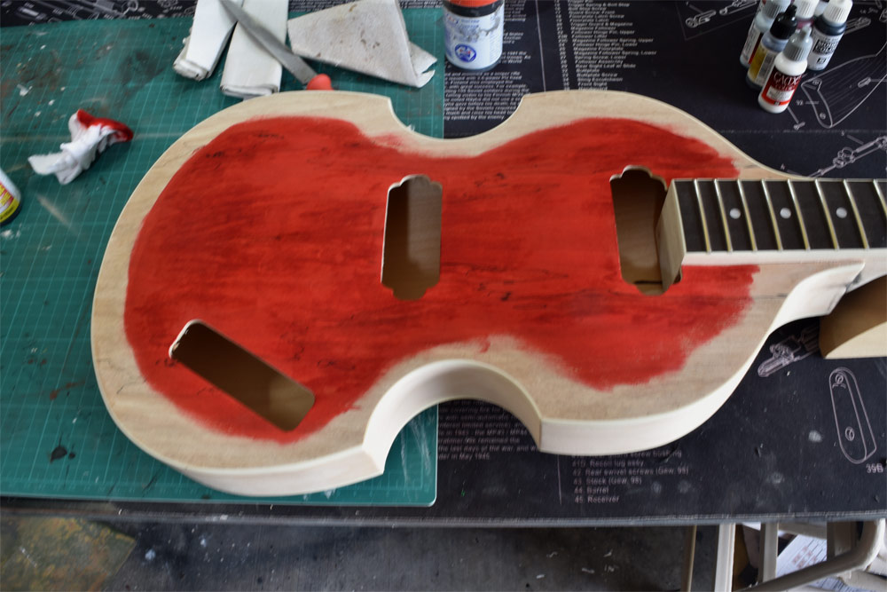

    Yup, its been a while. Nearly a year since my last build and this has been sitting on the bench since Feb.
    So... Found a more Hoffner looking tail piece for it and some "staple" style pick ups, I'll be making a new control panel from red tortoiseshell material that will hold a more conventional 1 Vol, 1Tone, and a 3 way switch.
    To get under way I have glued the neck in, filled around the join and while waiting for the filler to dry I put the red dye on. It will have a black burst so there was no point in taking the red to the edges. It's looking a bit orange in the pics but there was a few more coats went on after the pics and its darkened up a bit.

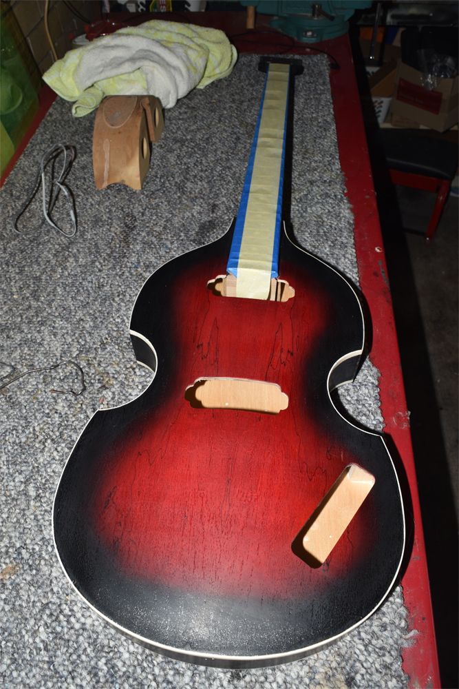

    Got the first clear coats on. I got a bit of staining of the binding despite using a liquid masking product, I have to presume in sneaks into the tiny cracks from underneath and the back, no stains on bound kits for me from now on.

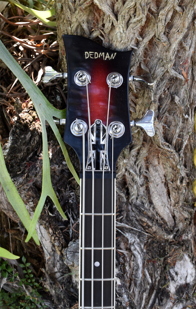

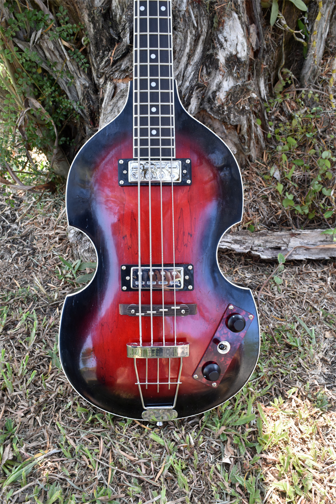

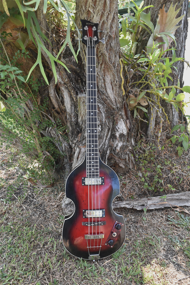

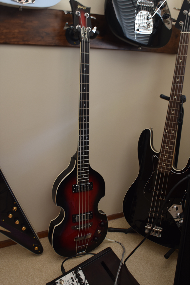

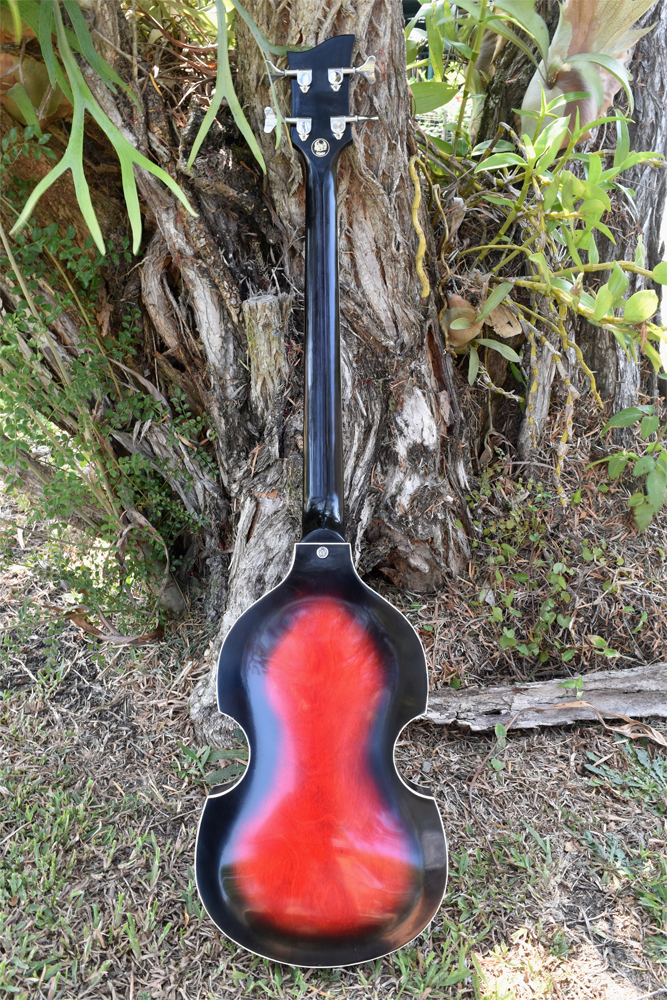

    Well, it's finished. I made some real dumb mistakes with the painting which just goes to show how quickly I can forget how to do things properly. But it's light and it sounds quite good. The action is a little high but I'll address that when I get some better strings (flats I think). I discarded the Hoff style switch gear for a traditional 1 tone, 1 volume and a 3 way switch in a switch plate I made from a thin peice of red pearl acrylic and a piece of a LP style electrics cover laminated together. Pick ups are some Ebay hoff style staple type and sound surprisingly good especially with the "scrambler" turned on on the Ampeg amp.Some real dirty bass. Anyway, its not perfect but I'm happy with it. More photos when I get time.
    finished. A couple of marks on the top that I could have avoided had I been thinking straight, but it plays OK so far and sounds really nice through my little Ameg combo with the "scrambler" turned on, lovely and dirty ;D
