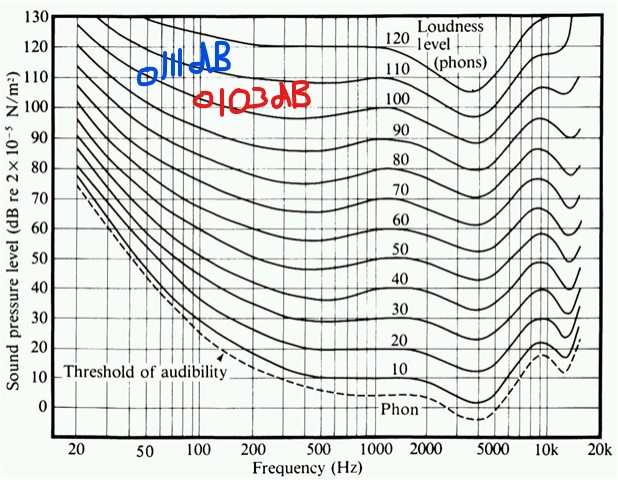

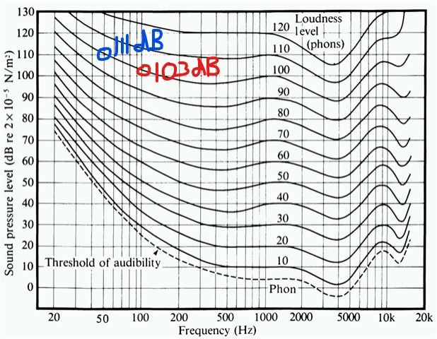

    Human hearing is less sensitive at bass frequencies, so a bass sound needs to be significantly louder (in physics terms) in order to sound the same as a guitar sound.
    Relative loudness levels are normally shown on a Fletcher-Munson curve (it's an average value as people's hearing responses will always be slightly different, and also what they perceive as the same volume). So down in the lower frequencies, a 50Hz note (around a bottom G on a bass) needs to be around 8dB louder than a 100Hz note (around a bottom G on a guitar) to be heard to be at the same volume.

    8dB may not seem like much, but in amplifier power (given equally efficient speakers), you need 6.3x the amplifier power for a 50Hz note to sound the same volume as a 100Hz note. So a 50W solid state guitar amp is best matched by a 350W bass amp. And a 50W valve amp, which when pushed will output nearer 100W, is best matched by a 700W+ bass amp. Add in a very efficient guitar speaker and a less efficient bass speaker, and the required power differences become even larger. So you can see why high powered bass amps are required if they want to compete with a loud guitar on stage.
    Luckily we tend not to use such loud stage volumes these days, and even PAs are generally used at much lower levels than they used to be (though the sound is of much higher fidelity), so we shouldn't need to use all the capabilities of our amps, but it's nice to have the headroom.
