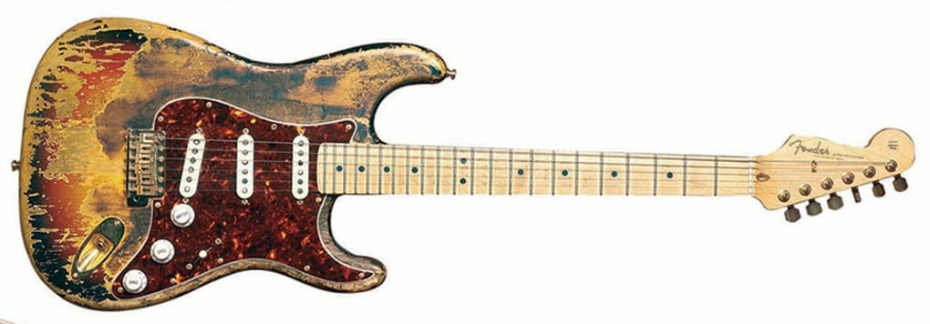

    It may make sense but it is also an opportunity. Frank Zappa is said to have had one or more Barcus Berry piezzo pickups in the neck of this Stat. You have the hole...Click image for larger version.
