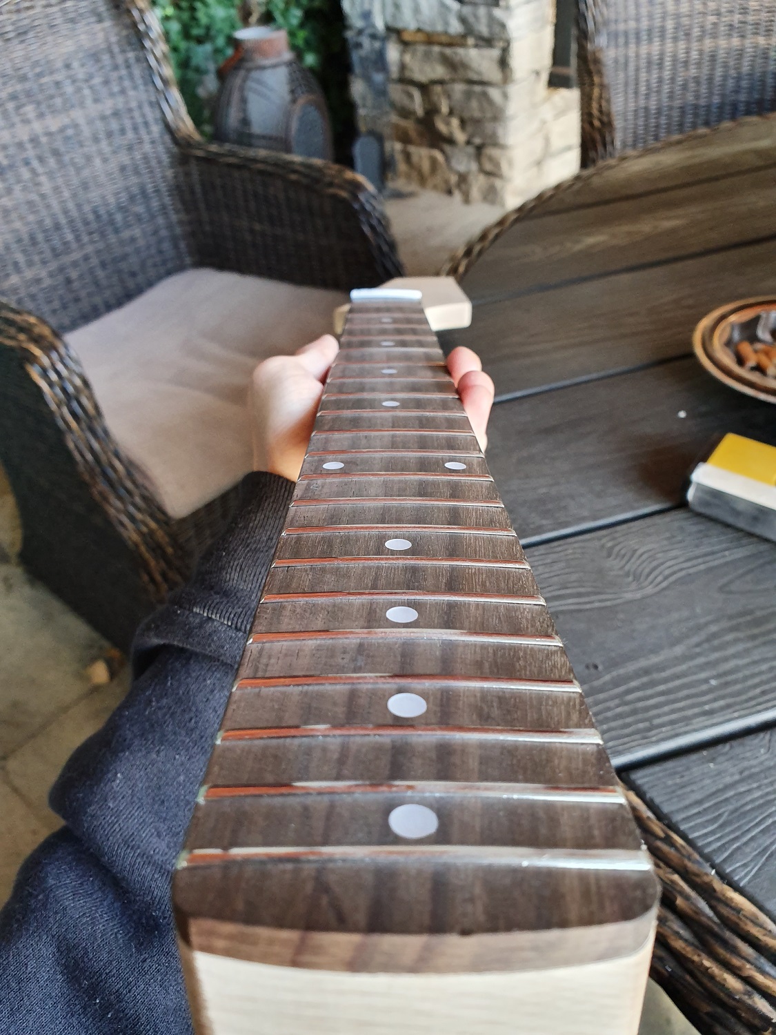

    I made a straight edge using an extra long metal ruler and a file although it seems after filing it bowed a little bit so i used this in conjunction with other levelling techniques (eyballing, wire, spirit level) to level the fretboard.

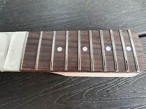

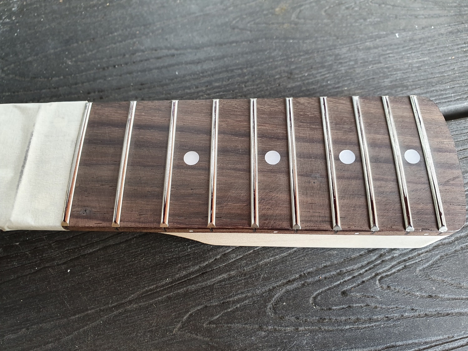

    After levelling I sanded the frets using a normal aluminium spirit level that i attached some 360 grit sandpaper to the bottom using double sided tape. The frets above the 12th fret seemed to be much lower than the lower frets so after the frets closer to the headstock looked even i stopped, taped off the 12th fret and kept sanding the upper frets (ones close to the body) some more as i have seen this advice anyway. Click image for larger version.
ID:	32072 Click image for larger version.
ID:	32073 Click image for larger version.

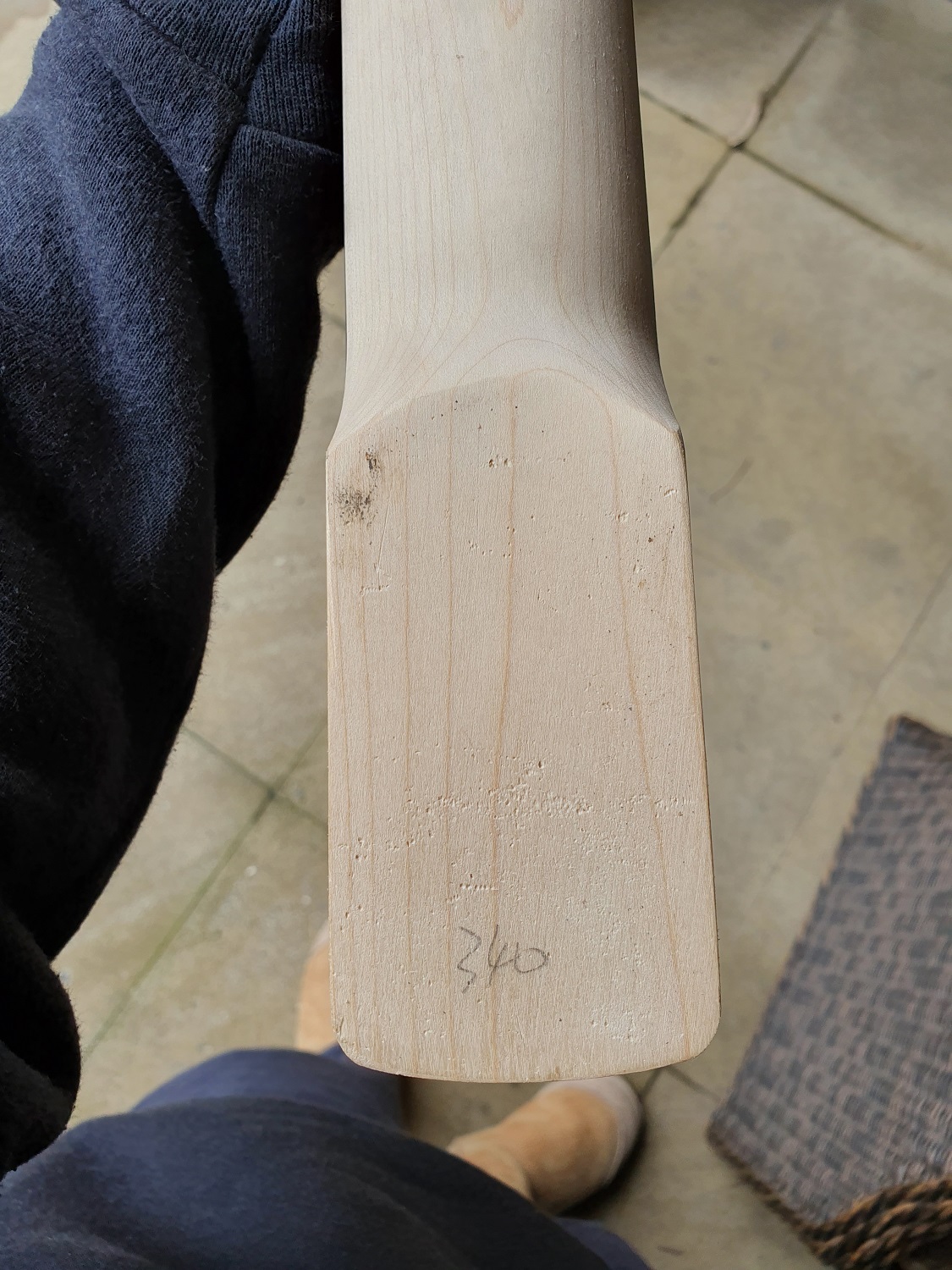

    I hadn't put down any protection on the table i was working on and now i've dirtied and dented my neck I'll put a towel down from now on.

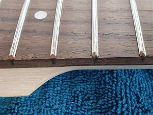

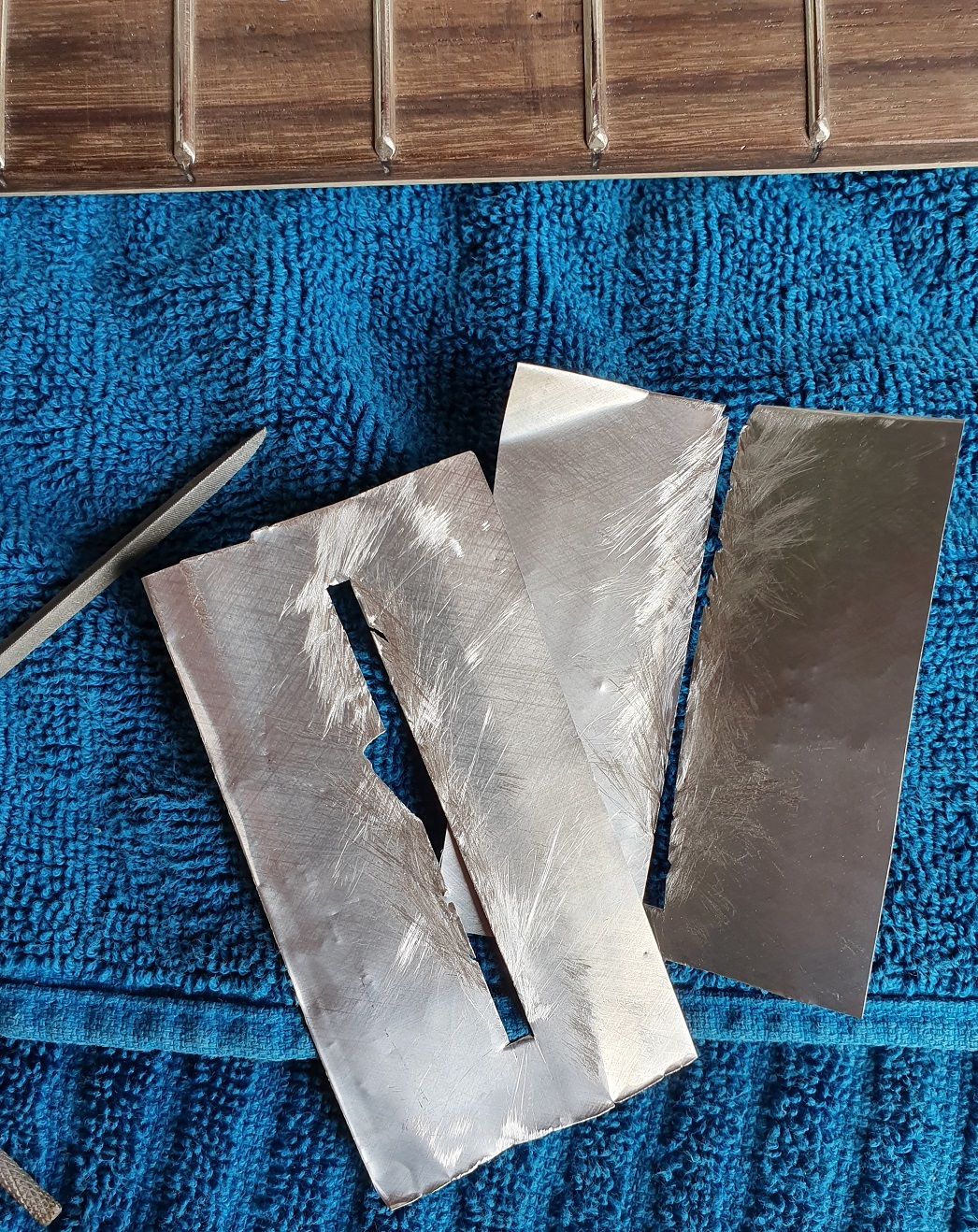

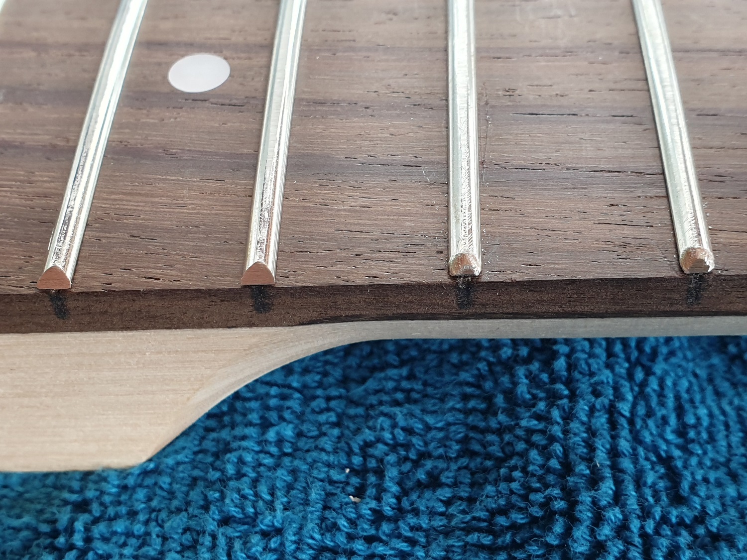

    Time to file the edge of the frets! I made a fret protecter thing out of an aluminium can, they work awesome and they're so thin they even get slightly underneath the frets so i can file the corners better, although they wear out, i needed to make two of these. For filing i used a small assorted file set, i used the triangle mostly and rounded the corners that touch the fretboard with a thin straight file. Soooo smooth!
ID:	32076 Click image for larger version.
