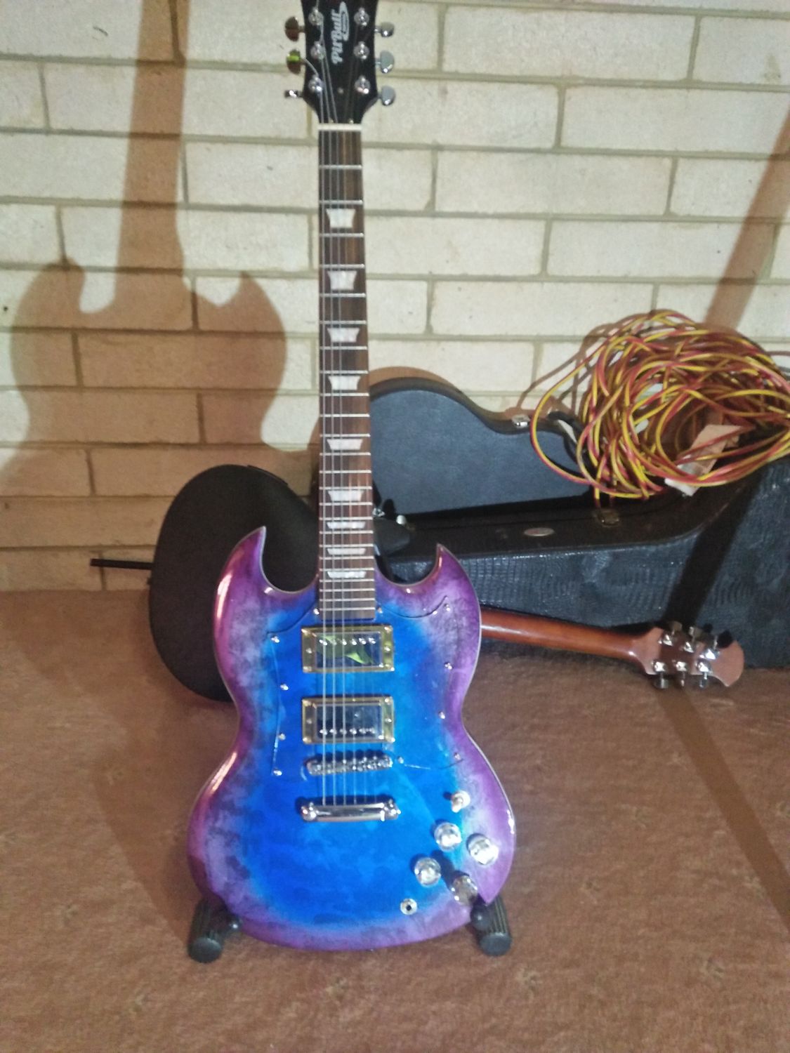

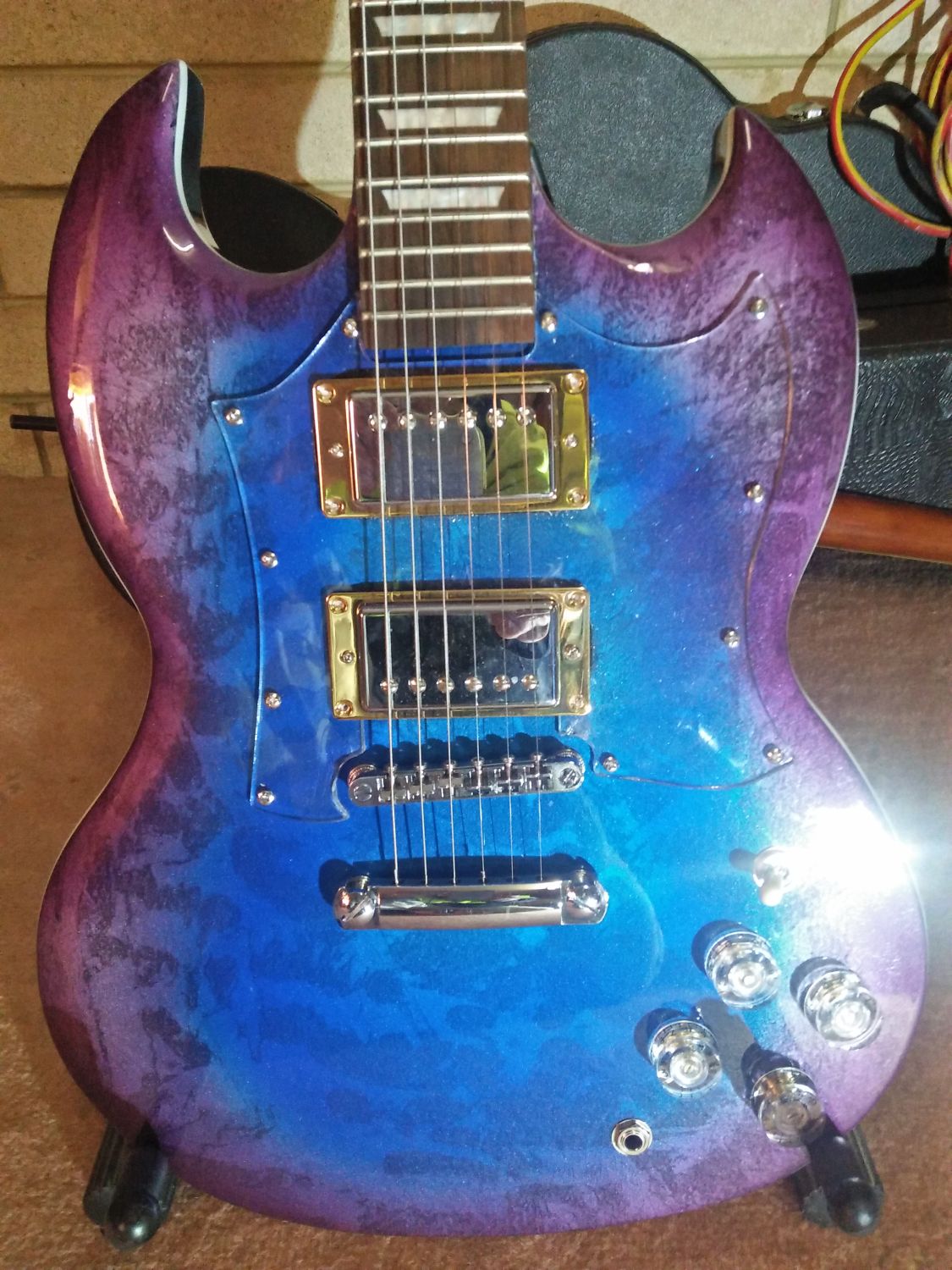

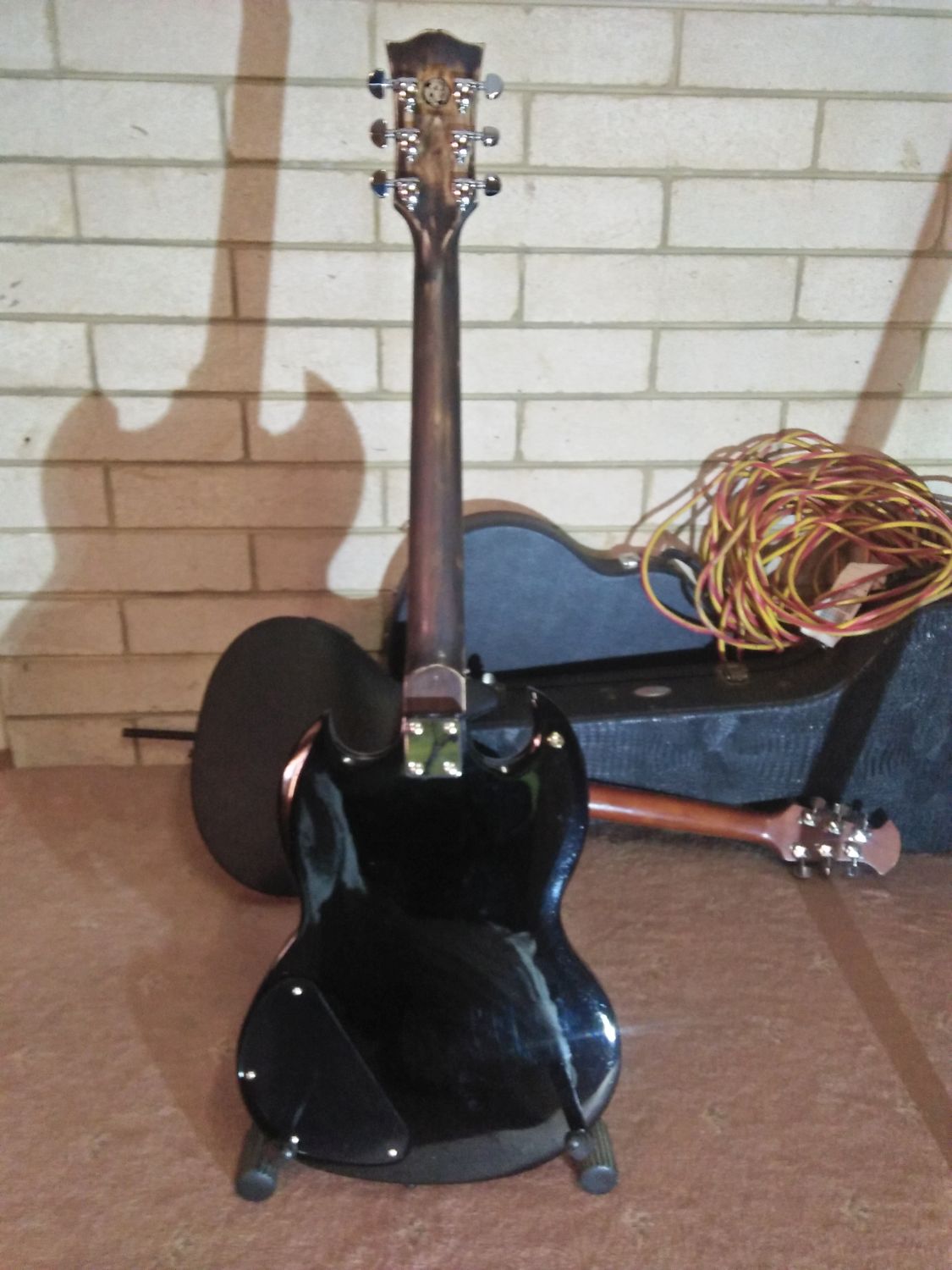

    First entry for the month from Lukie69 - a dual humbucker SG with clear pickguard.

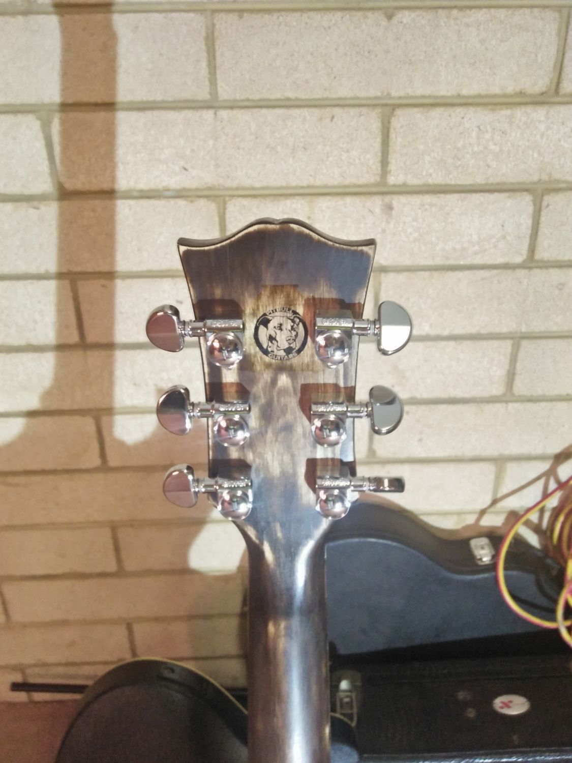

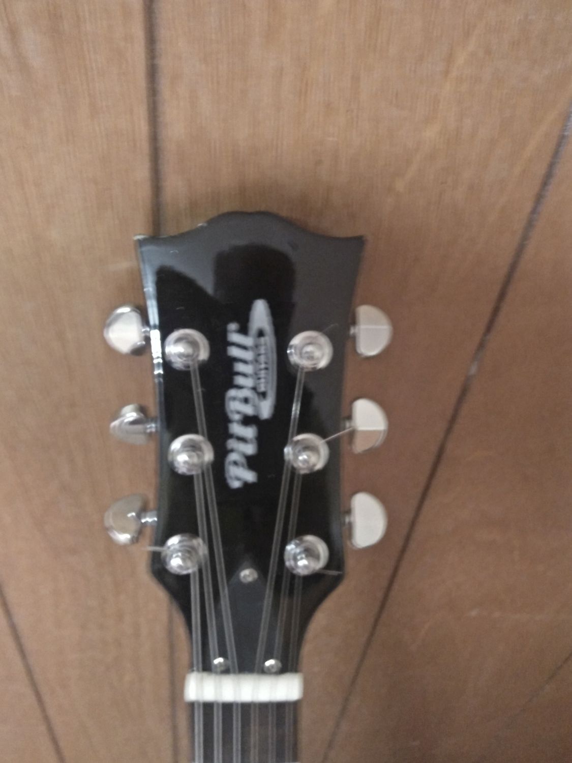

    And a closeup of the headstock...

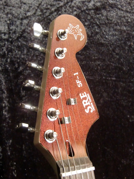

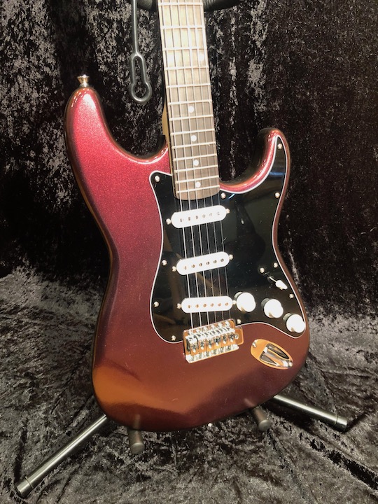

    Second Christmas Pressie "Starfish 1"

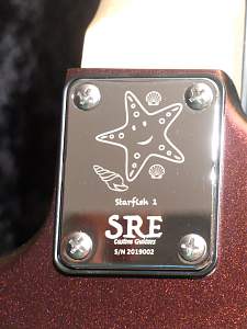

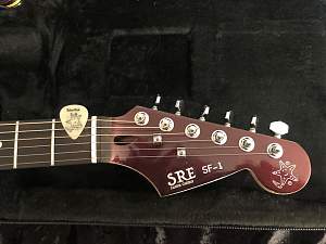

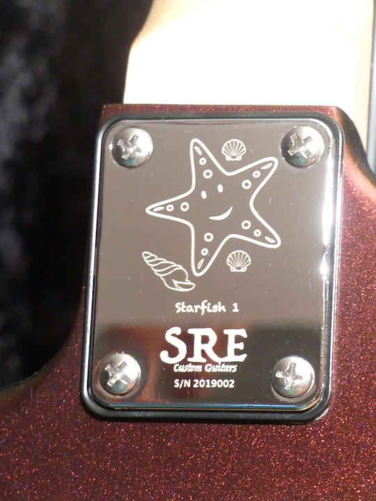

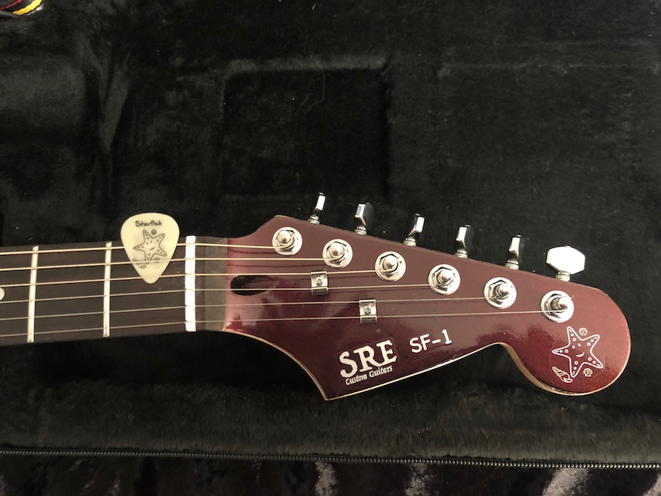

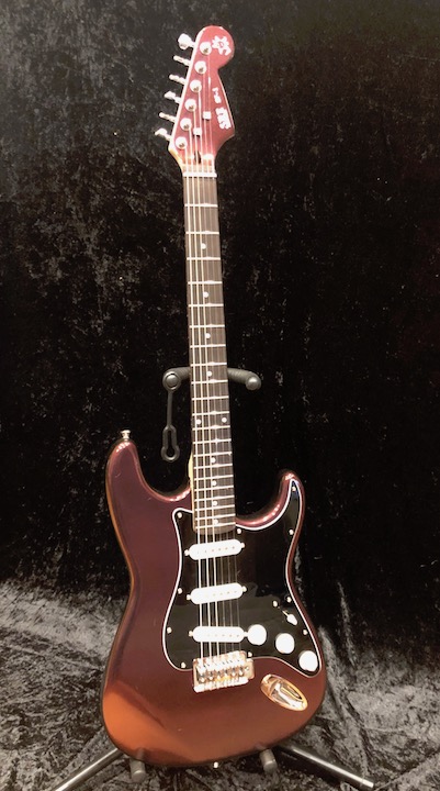

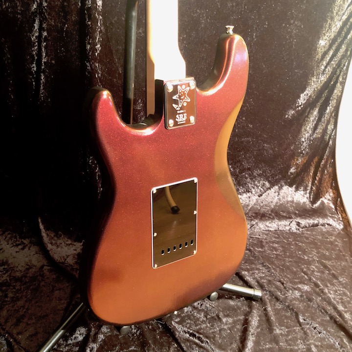

    Hey Everyone
    I've finally finished the second Christmas present for my daughters, this one's aright handed ST-1, again, I've tried to make it as personalised as possible without it being tacky . This one's also basically stock, apart from the black pickguard and tremolo cover (again I went with the "Gilmore Black Strat" look with the pickups and controls)
    the finish is also DNA Custom Paints, colour shift this time in "Red Rush" (Red/Bronze/Green), over a black base, with lots of clear over the top
    Again, the name of the guitar "Starfish", was her childhood nick name (she's also now in her 20s )
    hope you all like it
    Stephen

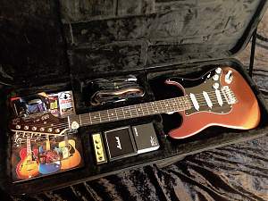

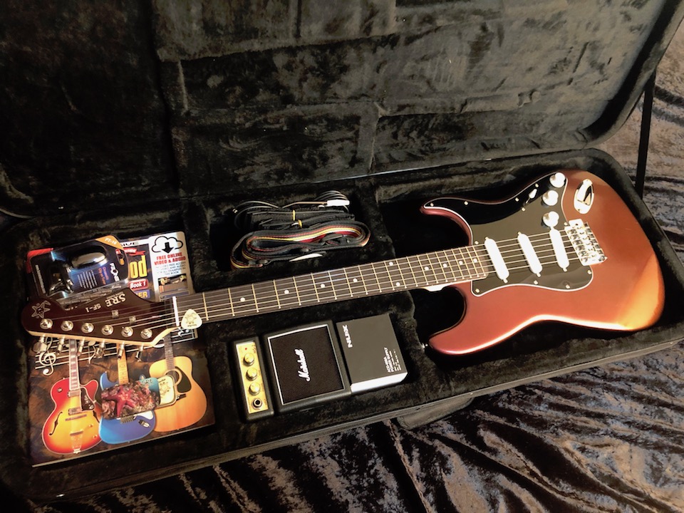

    The whole package

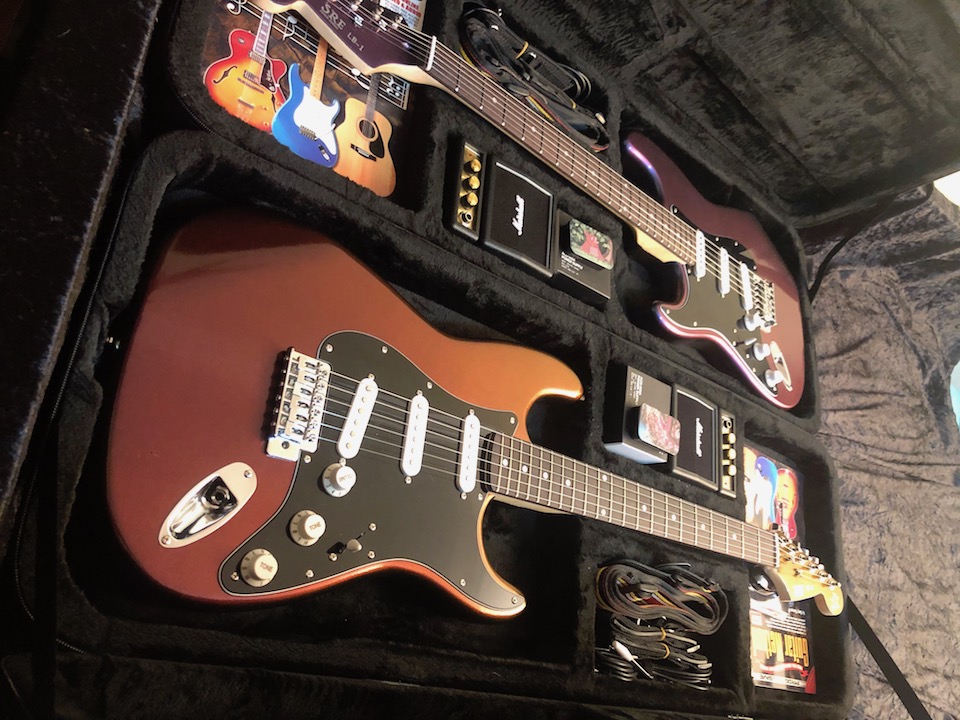

    And my Nomination photo for "Father of the Year"

    That red colour shift looks amazing Stephen

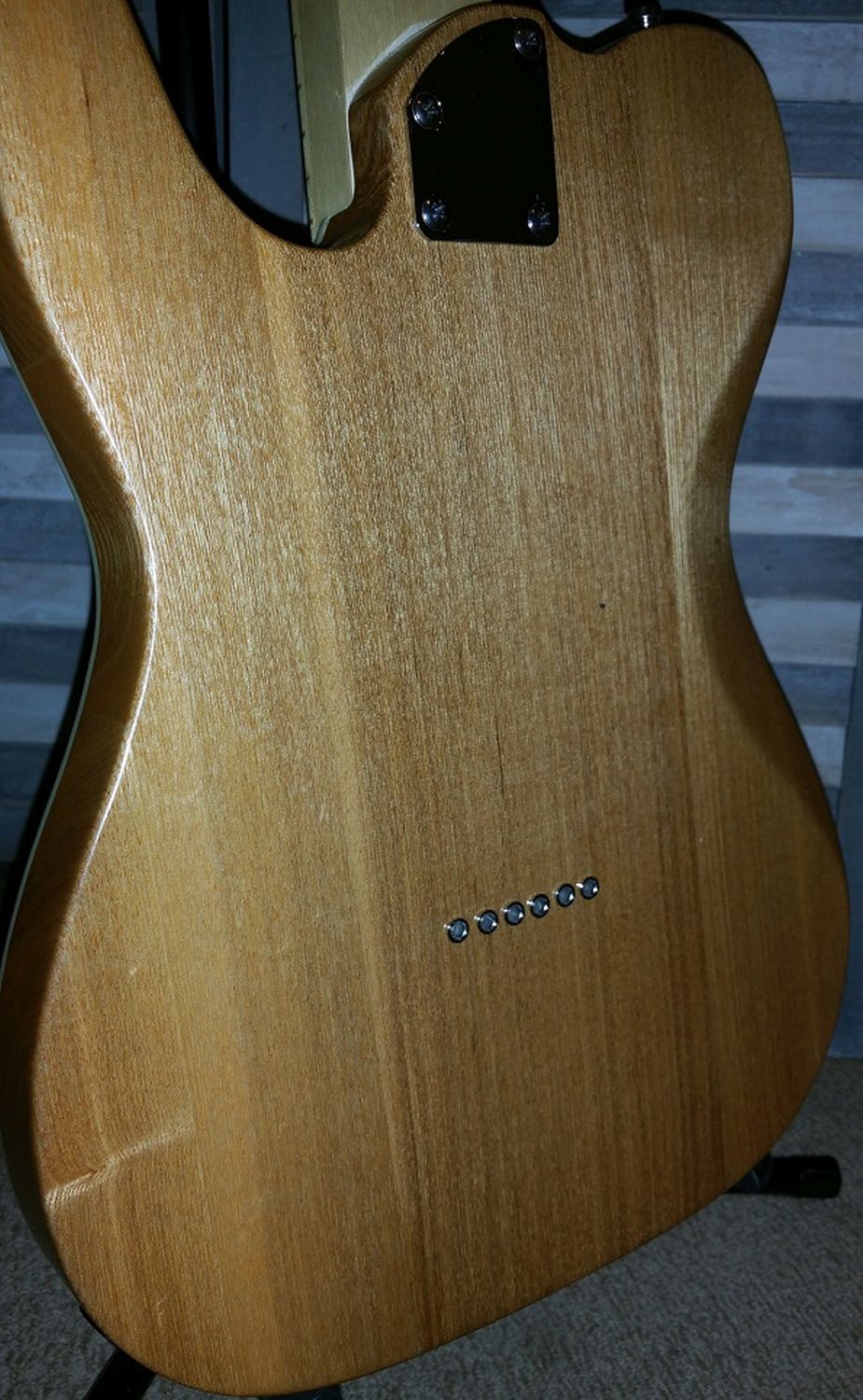

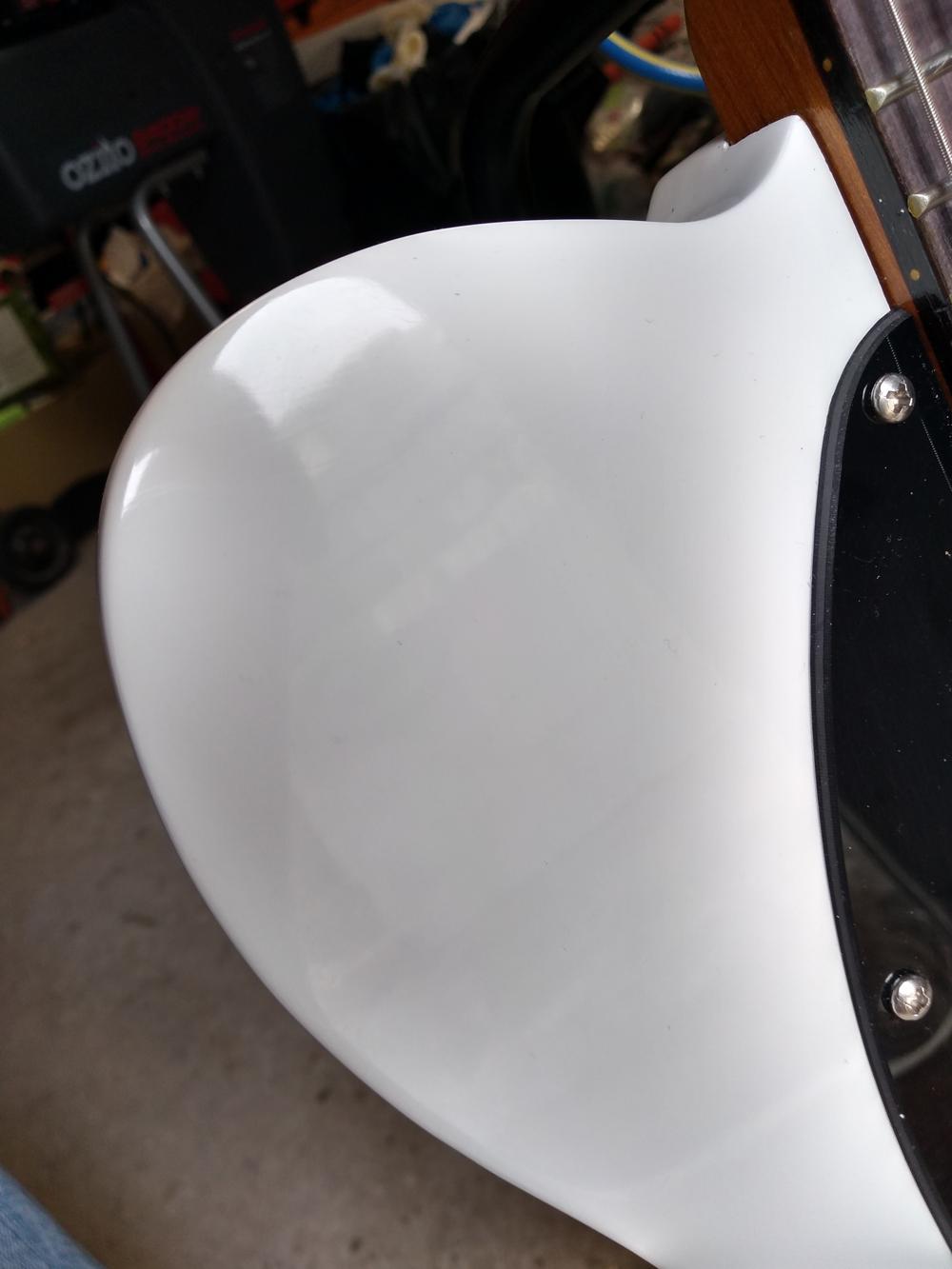

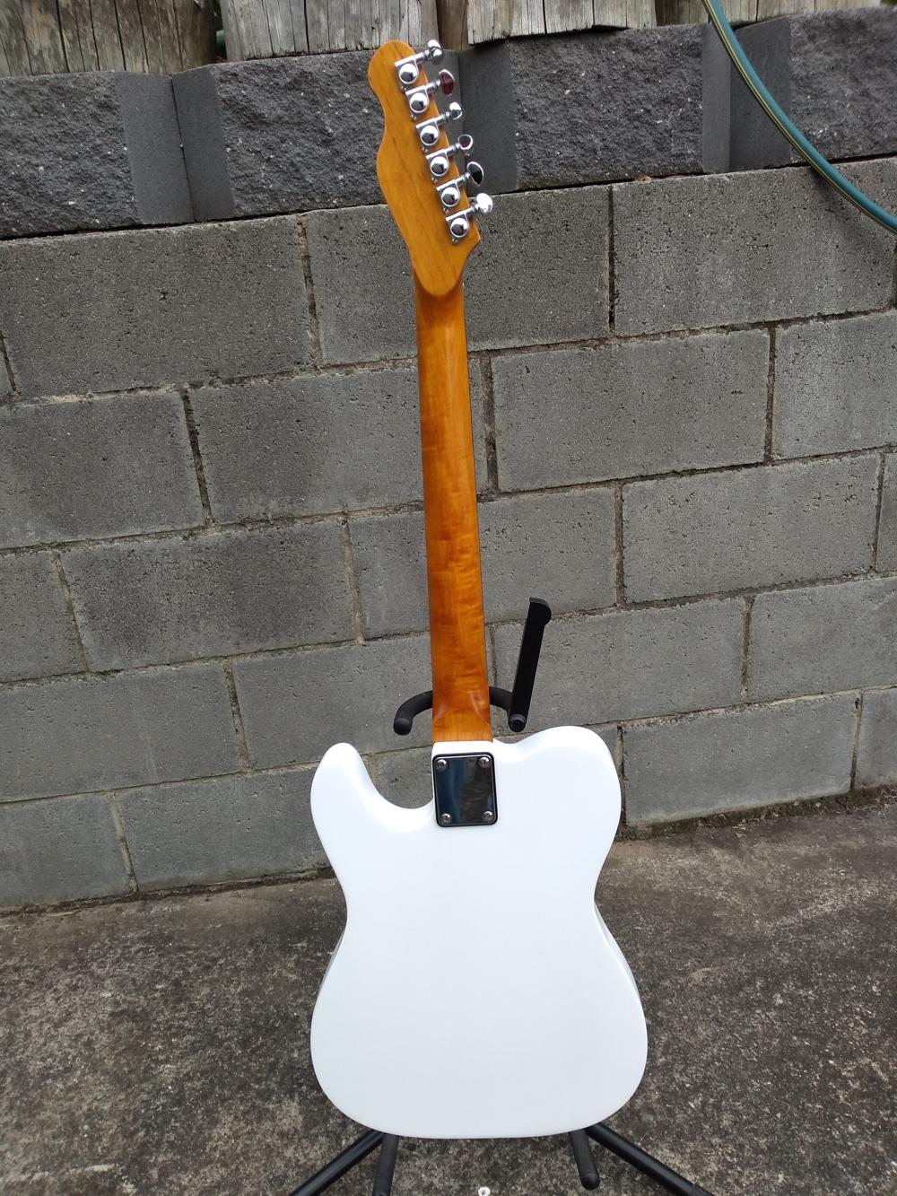

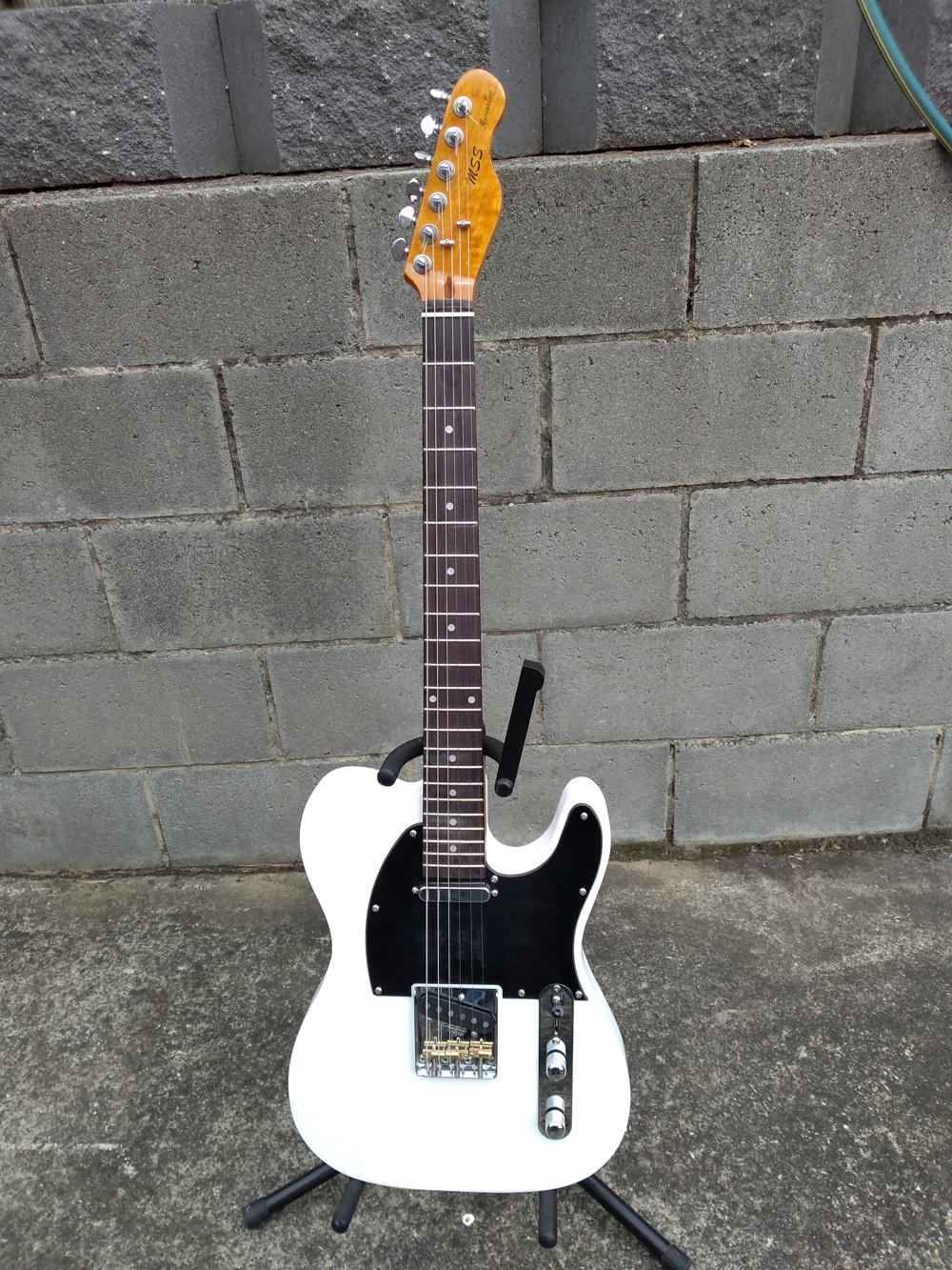

    White Telecaster
    TL-1AR (alder) kit with the following upgrades:
    Grover locking tuners
    Bone Nut
    Wilkinson Bridge
    Wiring Upgrade Kit
    Benson Custom Overwound Bridge Pickup, Benson Custom Vintage Neck Pickup
    Two string tees
    Body painted with white rattle cans from Supacheap. Body finished with clear acrylic lacquer also from Supacheap but sprayed with a spray gun.
    Neck stained with F&W golden teak and finished with tru oil.
    My first telecaster (have been a gibson man until now) and I am very happy how it plays and sounds.

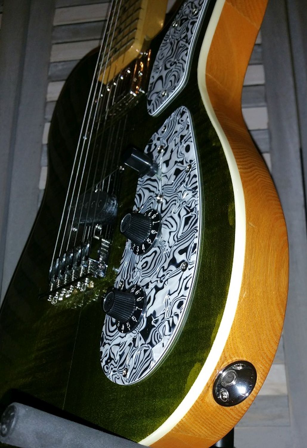

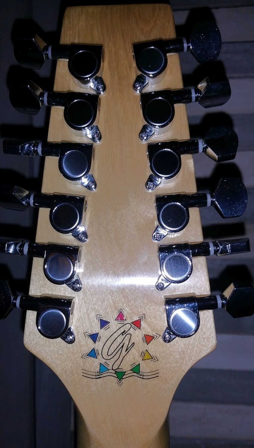

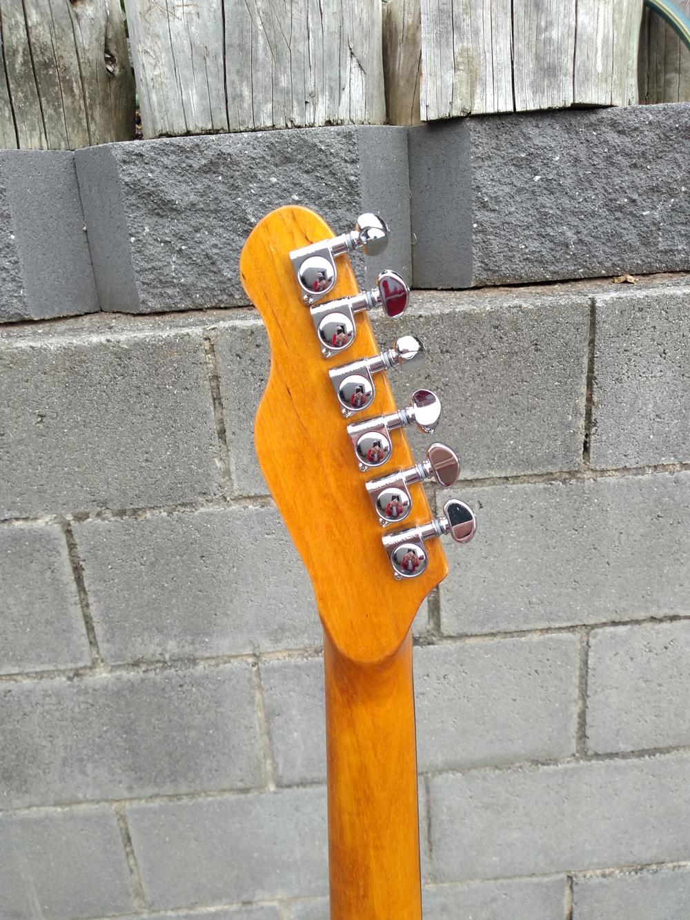

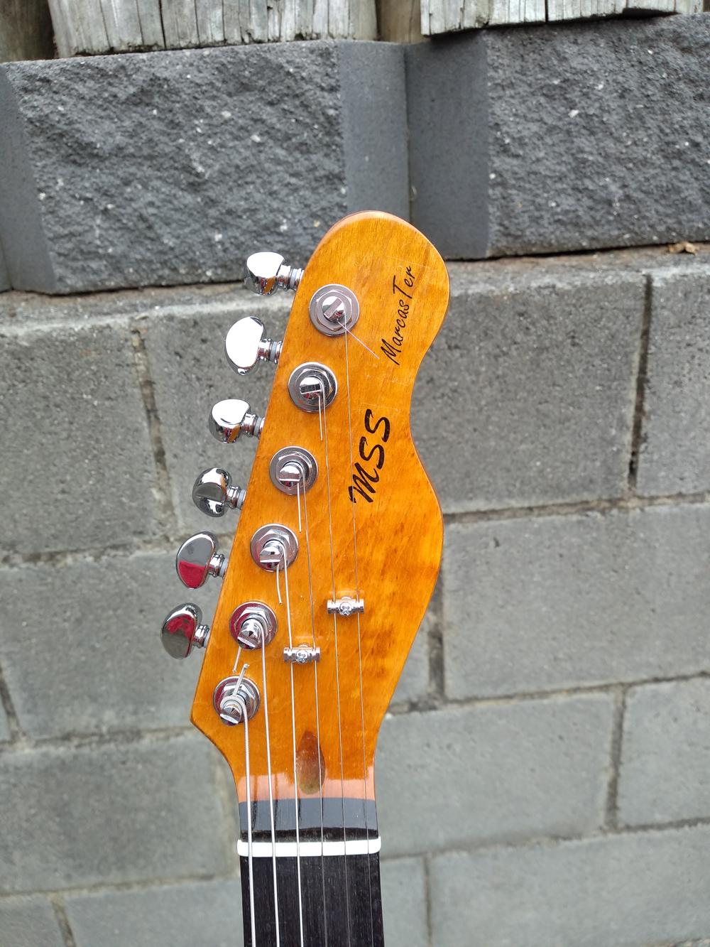

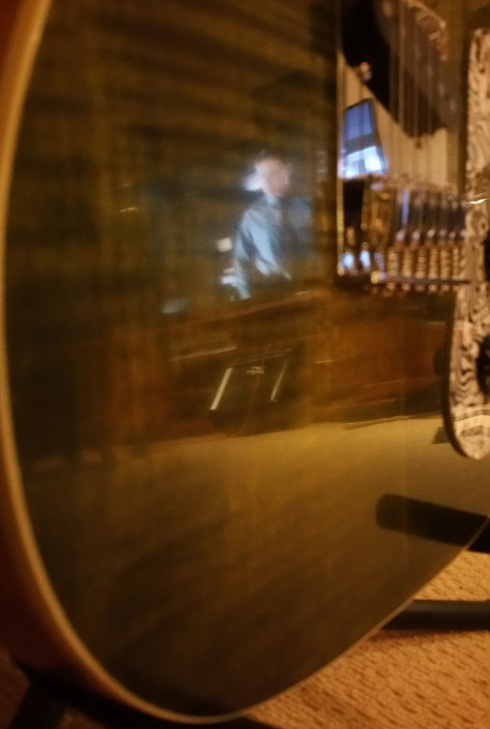

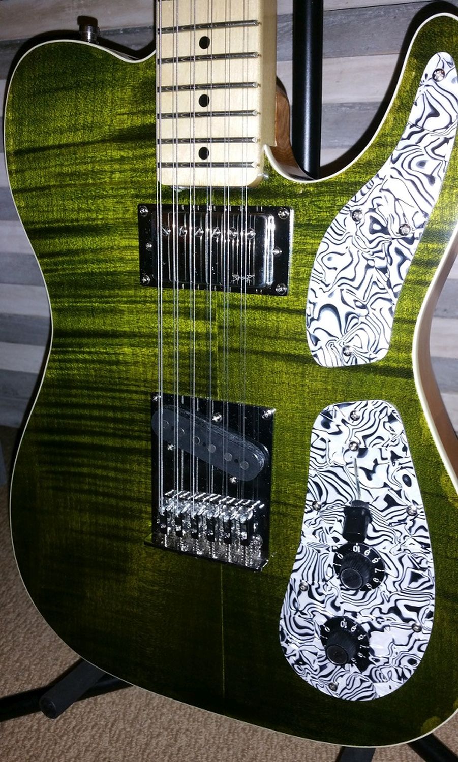

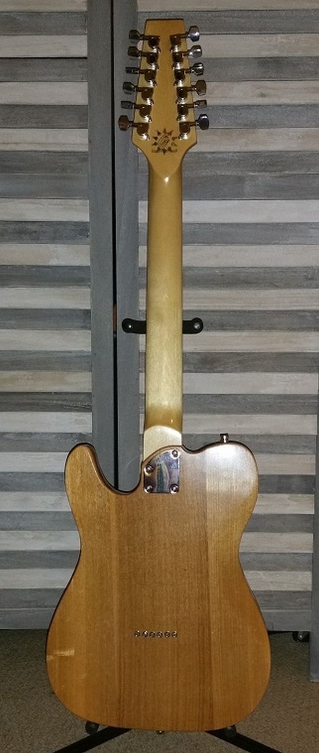

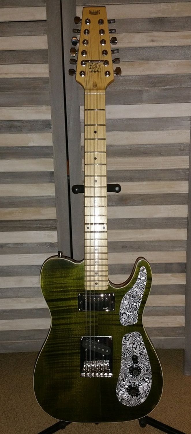

    From Mike Gordon:
    This is my build #2. A TLA12-F Ash Tele 12 string
    Customised easy access neck joint, scratch plates, jack socket input and belly route.
    Coil tapped Spear humbucker in neck and coil tapped bridge pick up.
    24 coats wipe on gloss poly and 5 coats wax to body
    24 coats truoil to neck.

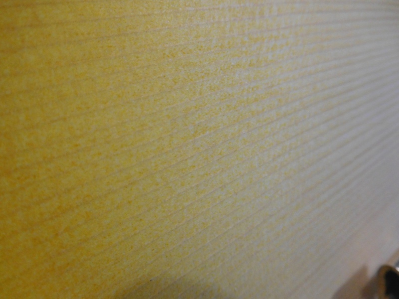

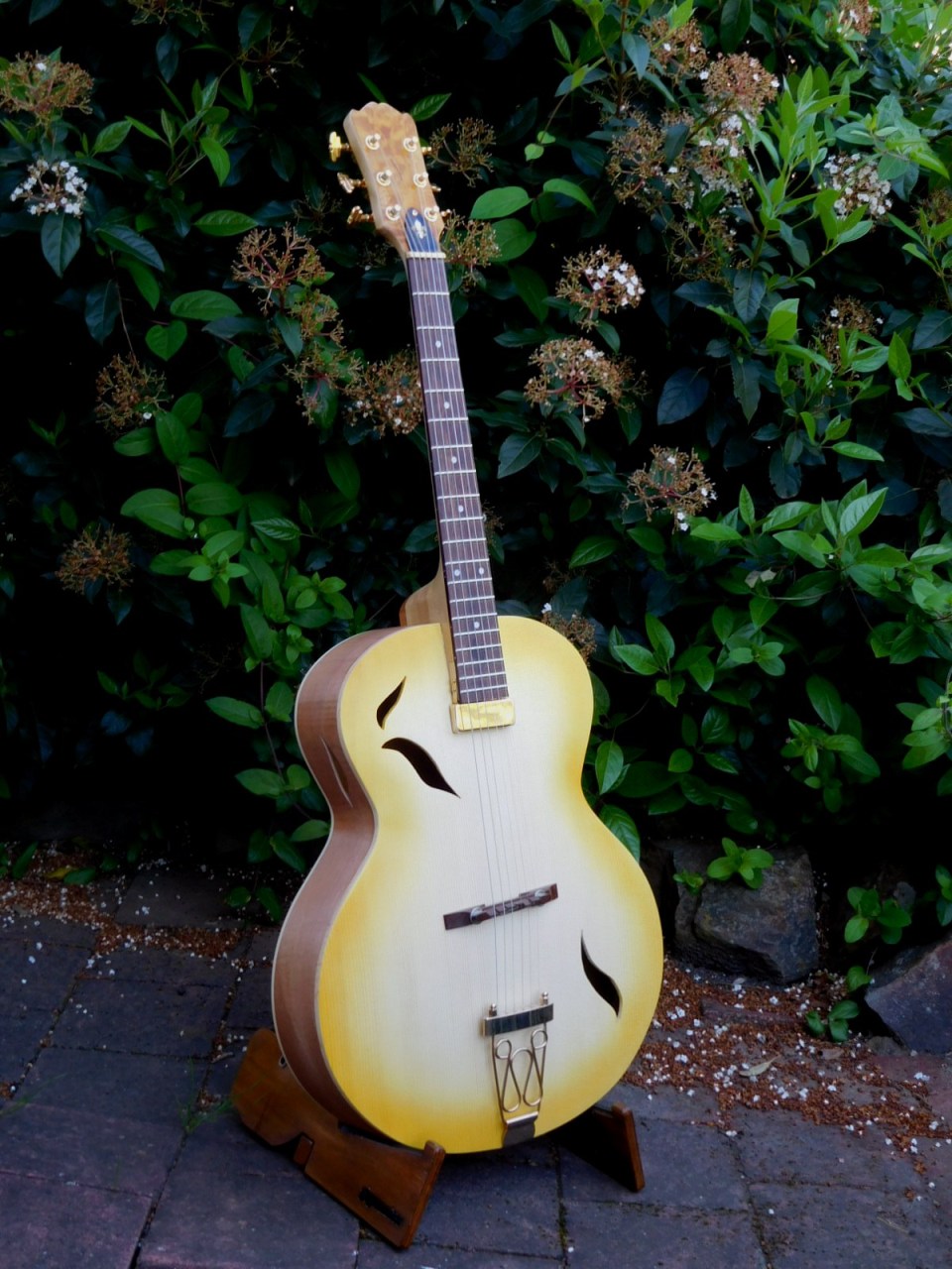

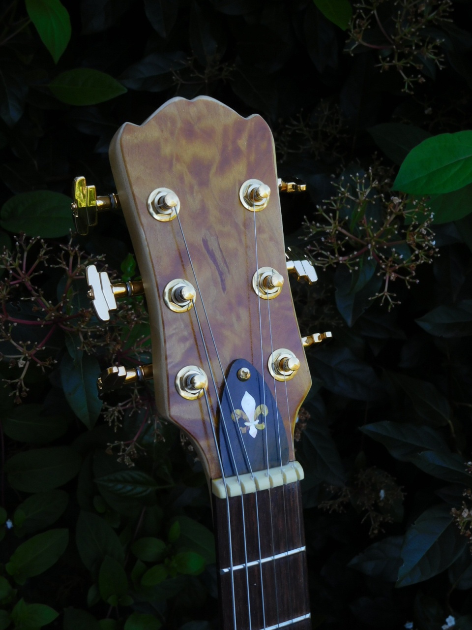

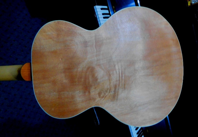

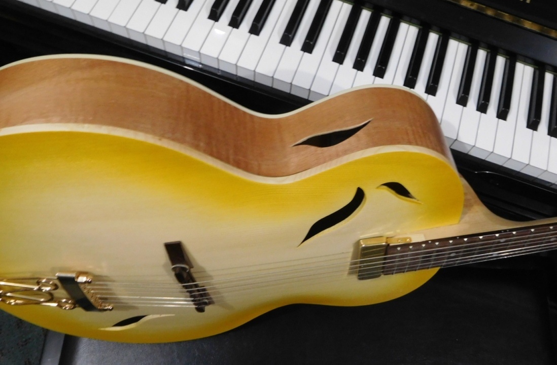

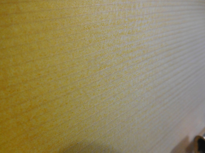

    Here's my ES-5V. I removed the laminated top and hand-carved a new X-braced solid top from a fine piece of super-straight grained Engelmann Spruce, and then cut some botanic motif sound holes. I also added a side-port sound hole. I veneered the head-stock with quilted maple. All the hardware is Gold plated and I fitted Grover Imperial tuners and a Kent Armstrong floating pickup. It is finished with with a very thin coat of satin clear after a light yellow-sunburst (only on the front) to allow the best acoustic resonance. Click image for larger version.
