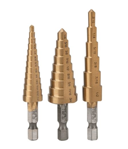

    What really *is* different is the size of the threaded bushing. On most Asian pots its about 6.6 mm. It's about 9.4 on the Bourns pot I just measured. Pitbull kits come drilled for Asian pots, so the holes are 8mm (5/16"). If you want to use CTS or Bournes pots you need to enlarge the hole to about 9.5mm (3/8"). On the advice of someone on the forum I did this with reamer. I have also used a step drill bit (turning it carefully by hand--not with a drill) like this...
