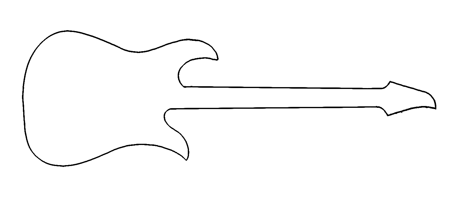

    Brief version: I had an idea for a modified version of the BC Rich Eagle shape, I liked the broad strokes, but just something about the proportions didn't sit quite as well with me as it could, so I reworked it to fit the silhouette of a Soloist, ending up with this, which I've been calling the "Hawk" because I felt like it needed a name and it's similar to an Eagle:
Name:	hawk outline.png

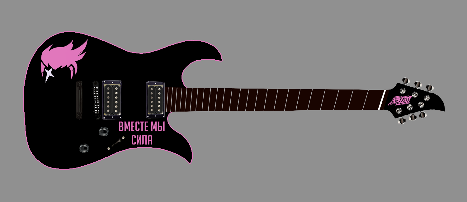

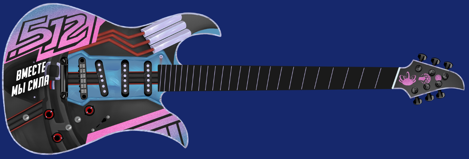

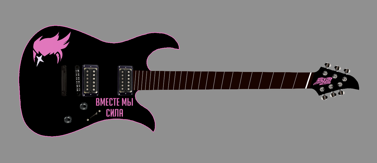

    Eventually when I was discussing it with my partner and getting plans in action to start a new build, she said she was underwhelmed by the design. But since she's an artist she said "Here, I've got an idea, send me a copy of the mockup you've made there" and got stuck in to drawing. Eventually all coming out in this absolutely amazing form:
Name:	The Zarya Hawk - Standard Res (Custom).png
    And that's roughly where the sights are set now. Some structural changes are planned, but that right there is what we're aiming at.
    Now I haven't locked in exactly how I'm gonna get this on to the guitar yet, it's gonna be a printed work though. Currently evaluating a couple of options in a custom waterslide decal or vinyl wrap, but I'll sort the nitty gritty when I get there. If anyone does have any recommendations for/against either of these ideas, or has any other good options for it, please let me know, I'm always happy to hear it!!

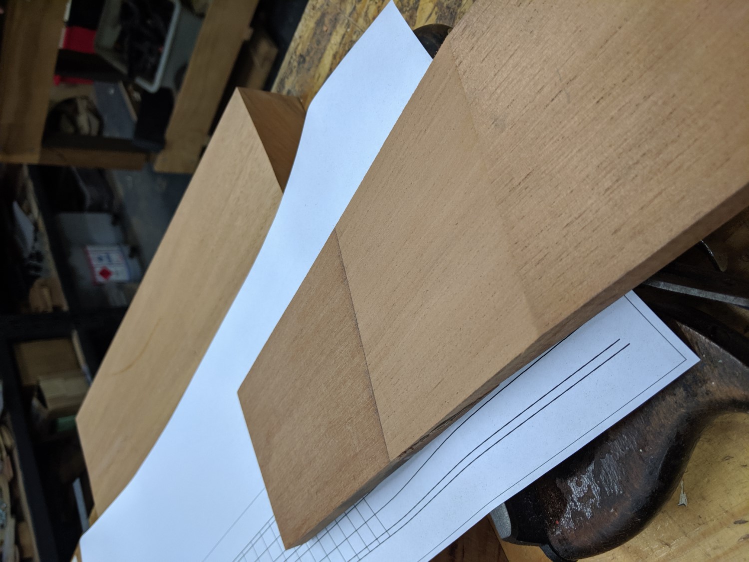

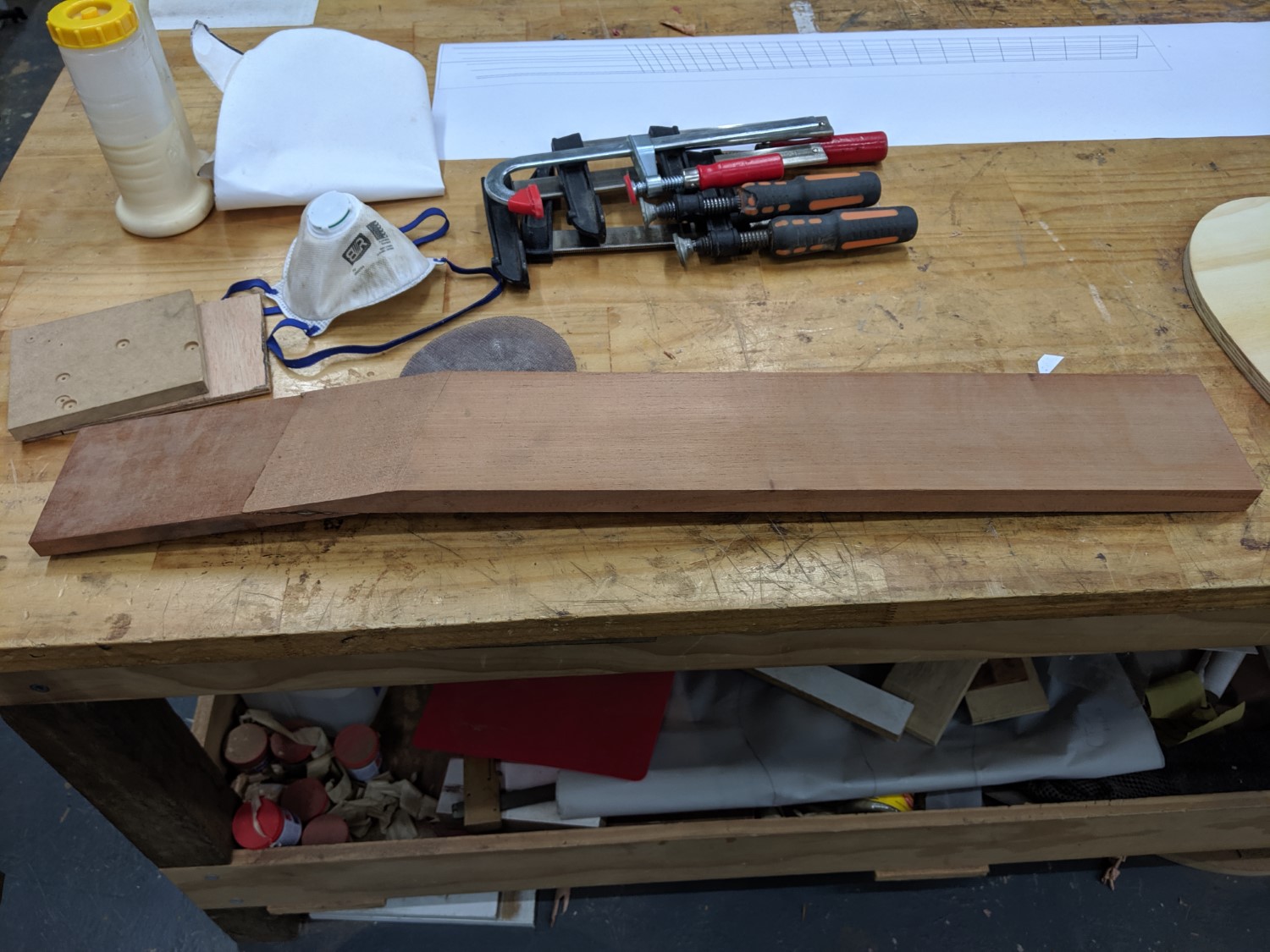

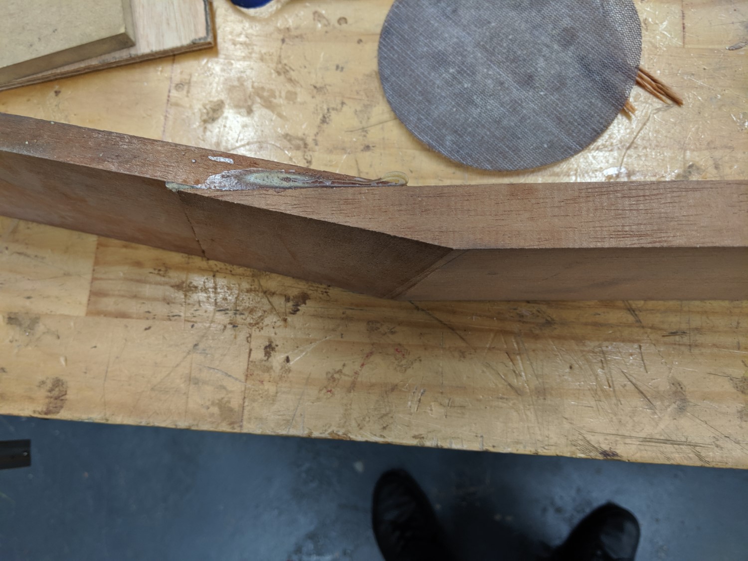

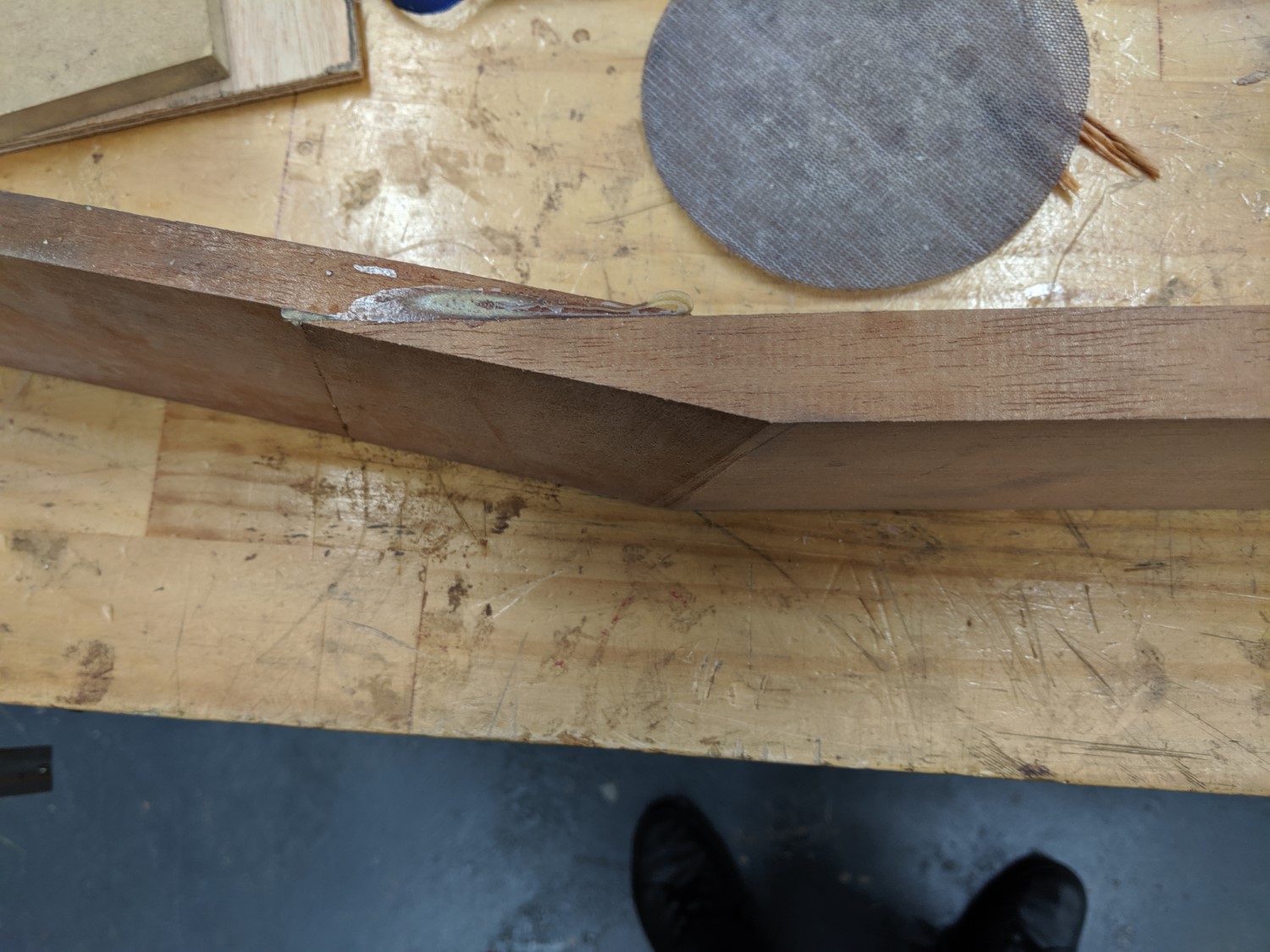

    That time, we got the Neck scarf all sorted, but did it all clever with the bandsaw instead of hoping to get it good with a hand saw. I find the compound scarf to look really nice and satisfying to have it work. Using Red Cedar for the neck, likely gonna be stained black on the back and will have a graphic on the front
Name:	IMG_20190829_181605 (Custom).jpg
Name:	IMG_20190829_181619 (Custom).jpg

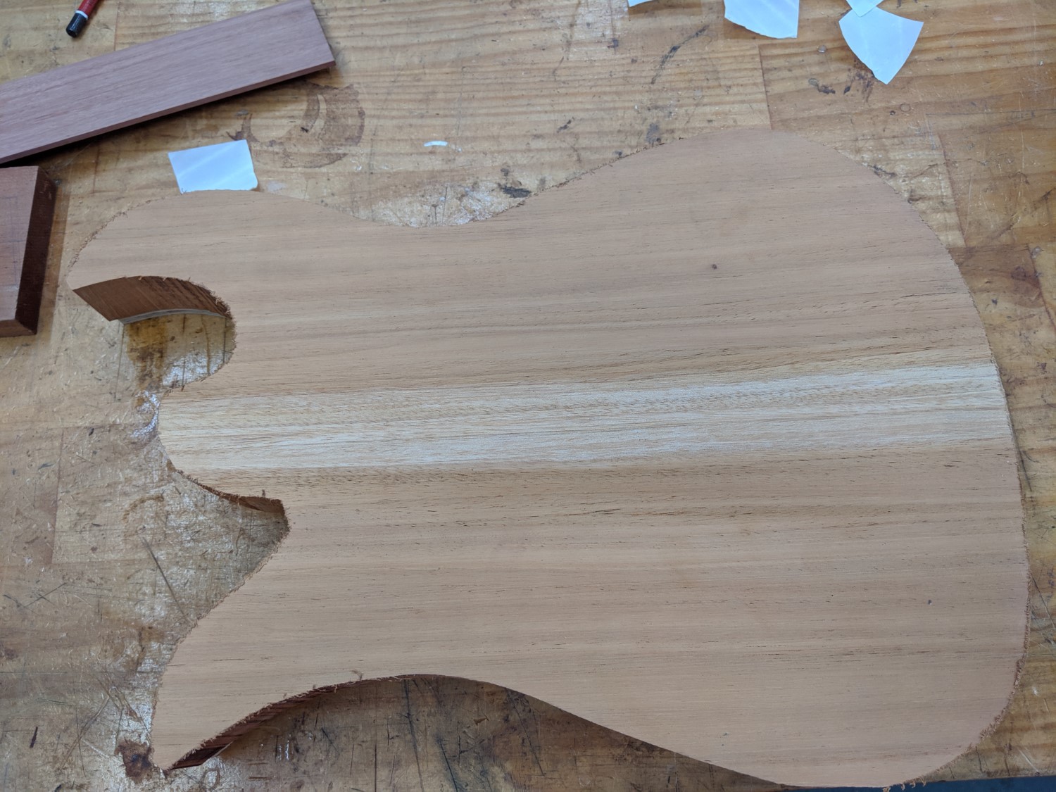

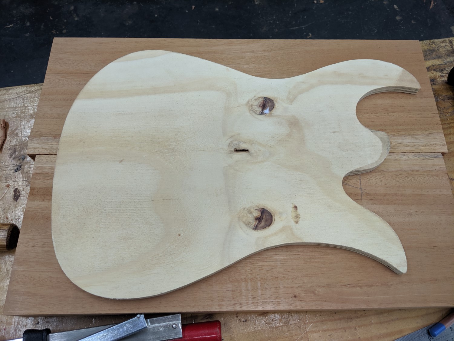

    As well as getting the body template shaped (on top of the Mahogany that I'll be using for the body)
Name:	IMG_20190829_203139 (Custom).jpg

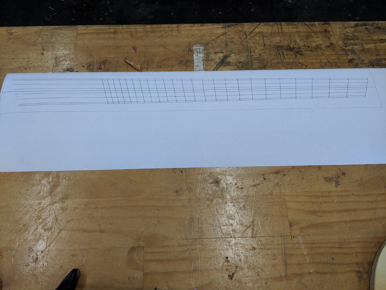

    Fanned Frets again, but going 25" - 26.125" this time. It's a kind of odd pair of scales but in theory I think that it'll work for me haha
Name:	IMG_20190829_181552 (Custom).jpg

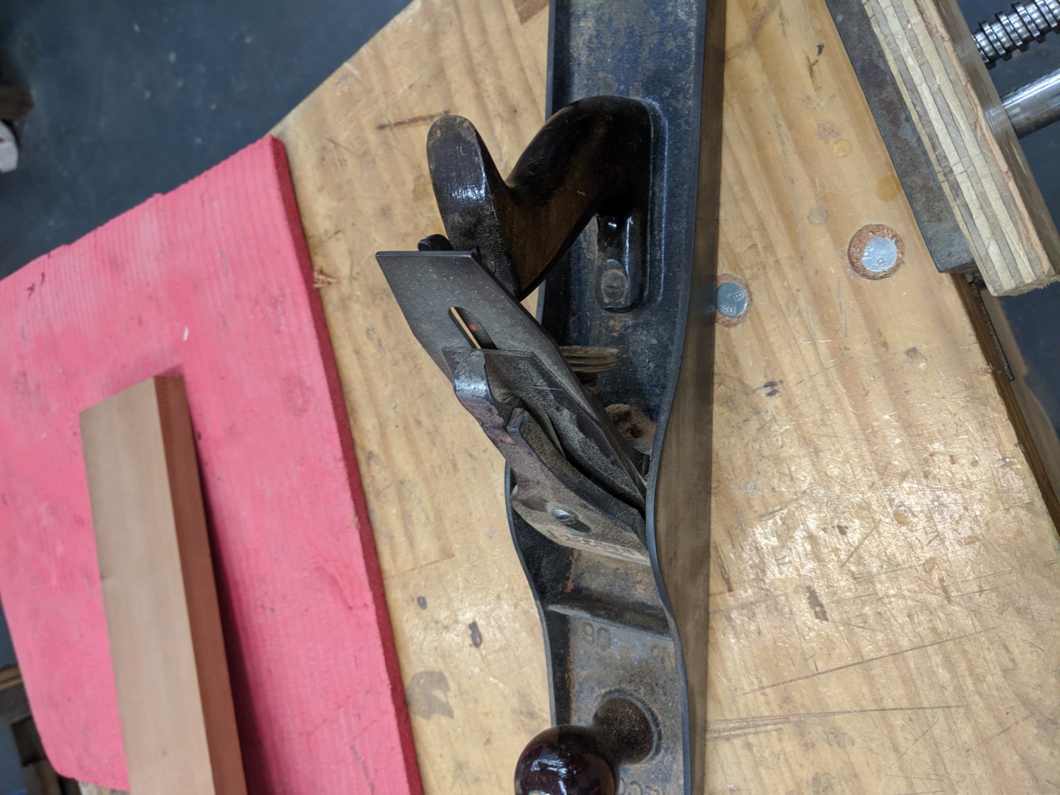

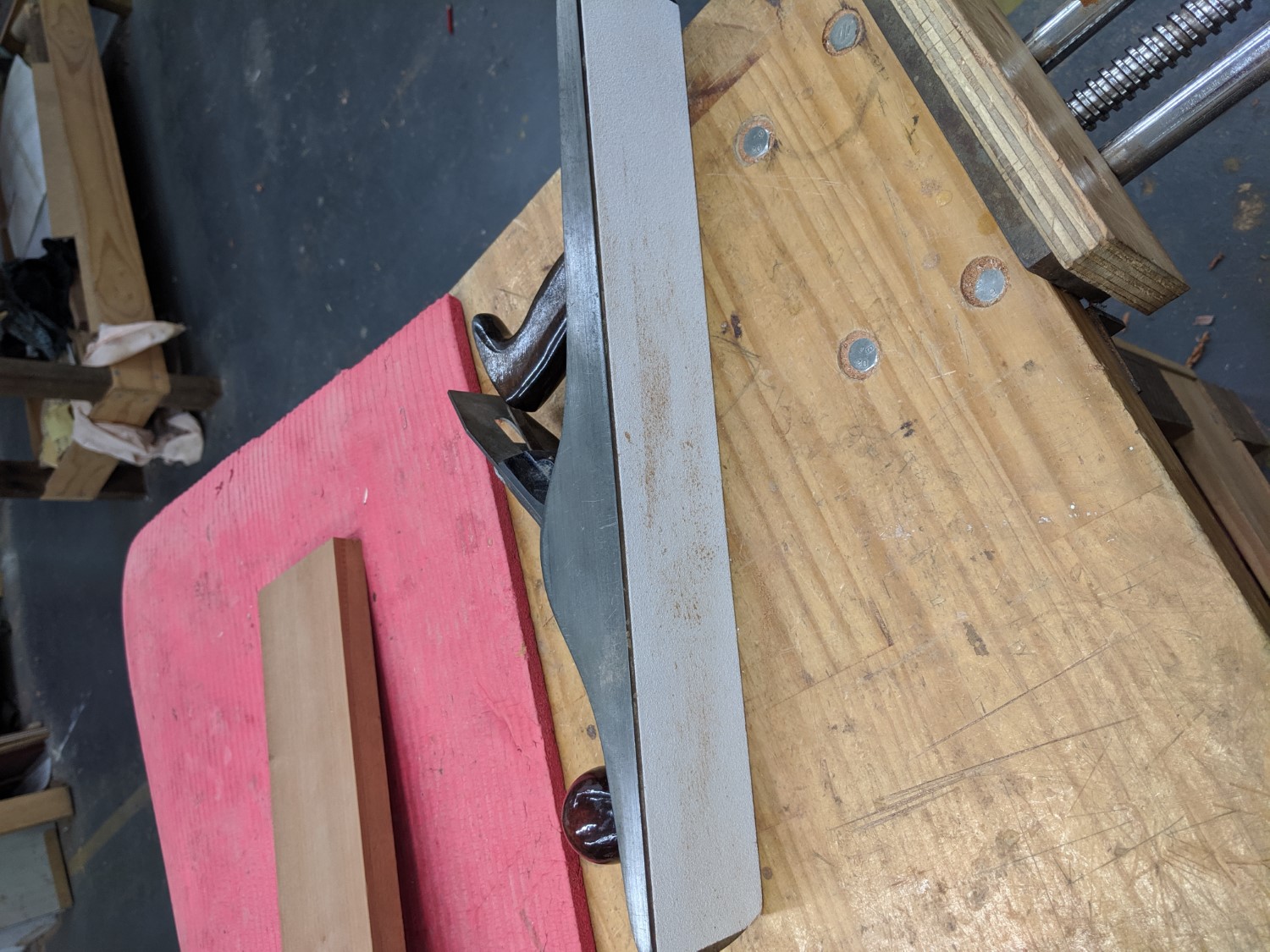

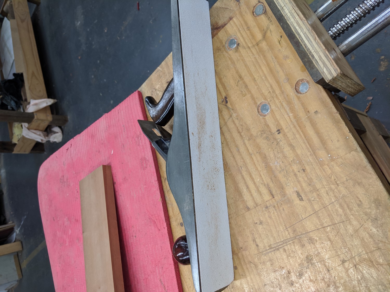

    After planing it back to even up the headstock, Matt pulled out a Plane which:
Name:	IMG_20190829_184752 (Custom).jpg
Name:	IMG_20190829_184756 (Custom).jpg
    Surprise Sanding Plane!! Made levelling it down an absolute breeze.

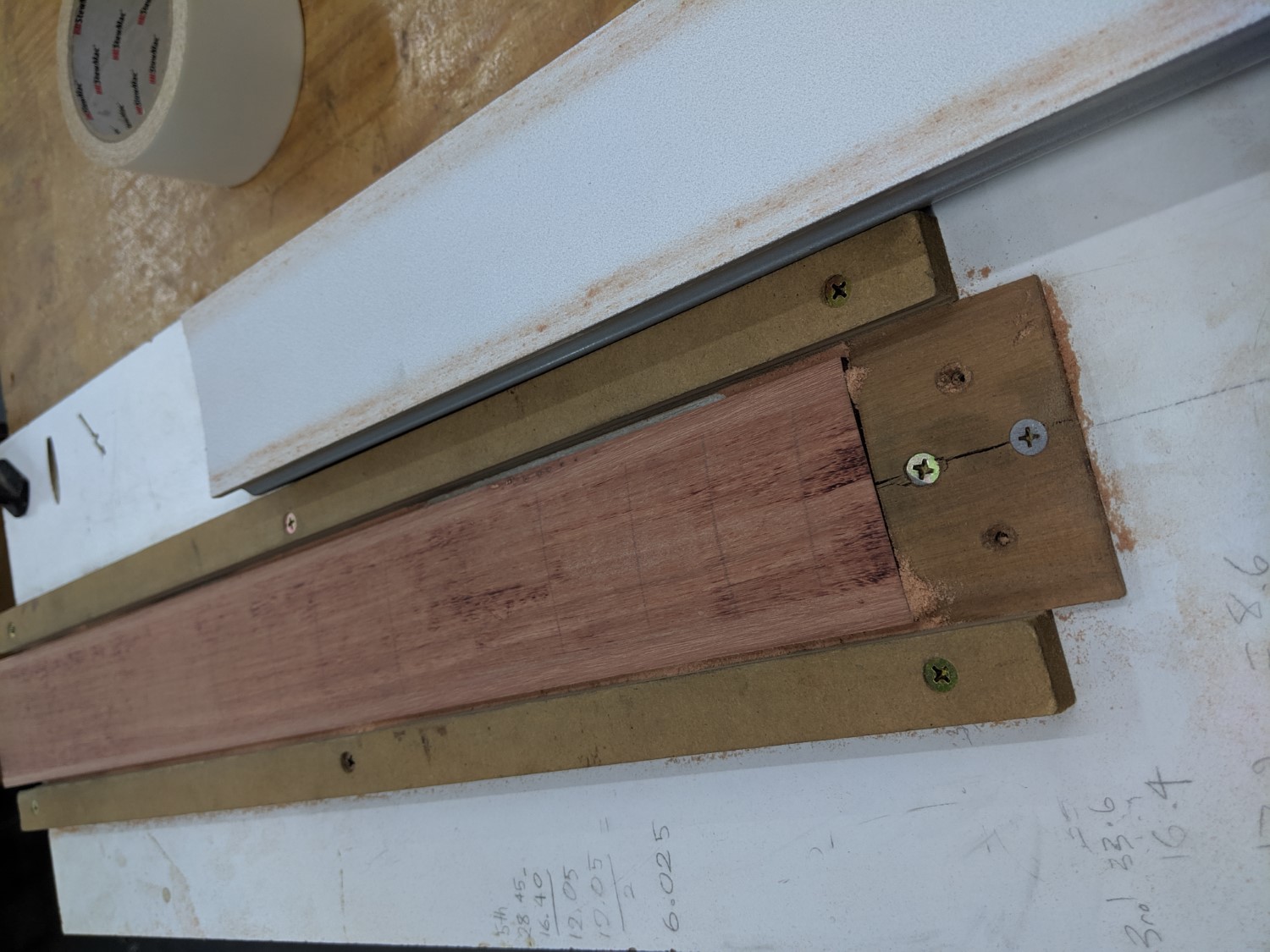

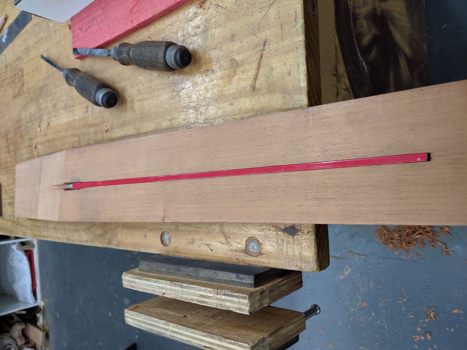

    Routed in the Truss Rod channel:
Name:	IMG_20190829_203131 (Custom).jpg

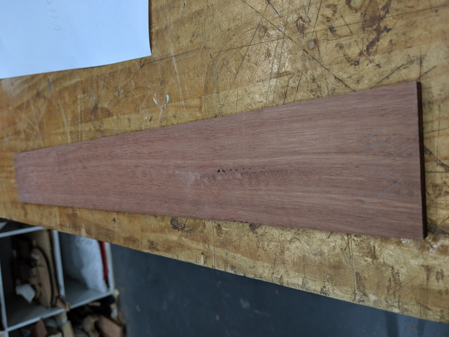

    Karri for the fretboard, which will end up stained black
Name:	IMG_20190829_203123 (Custom).jpg

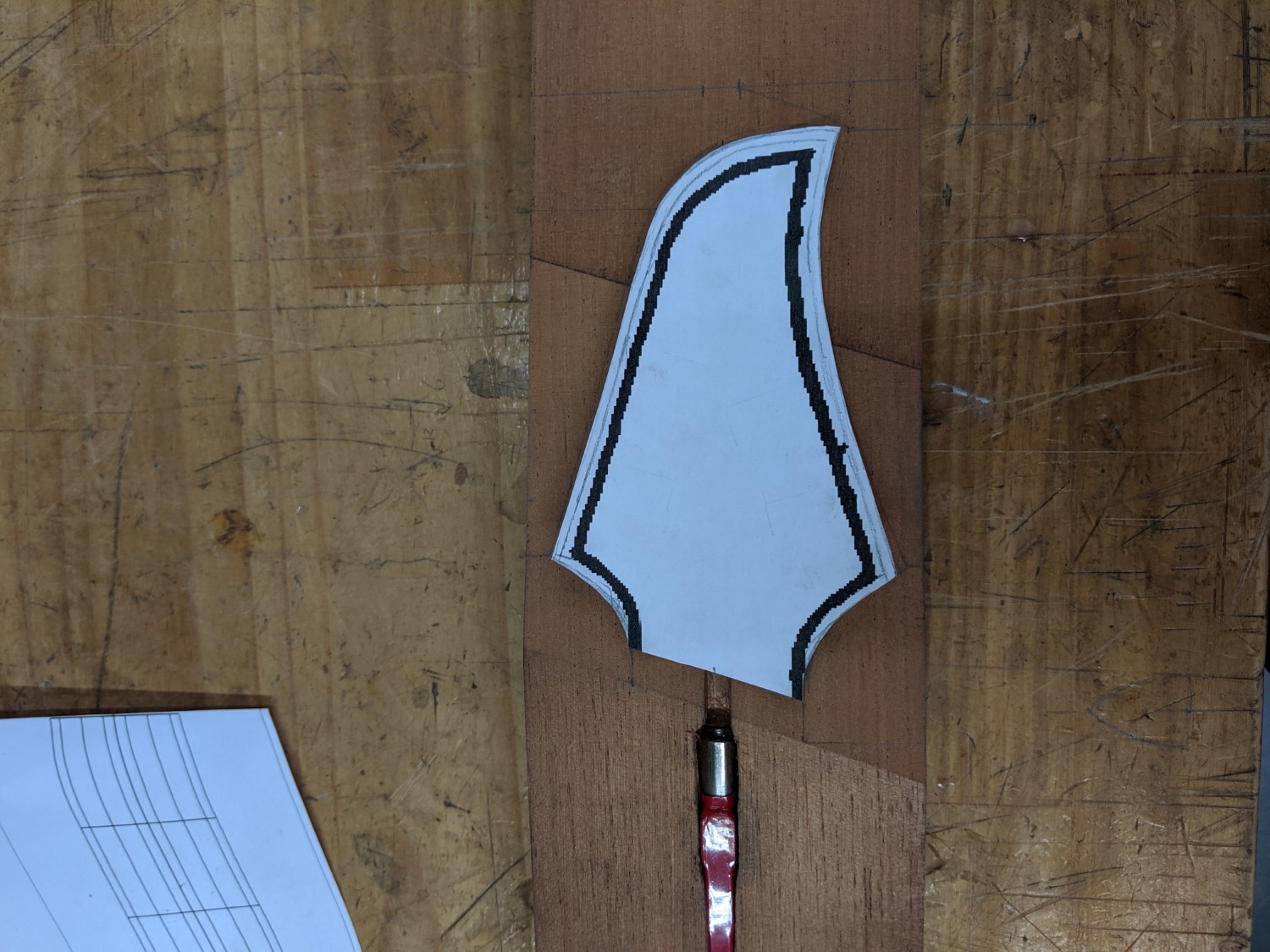

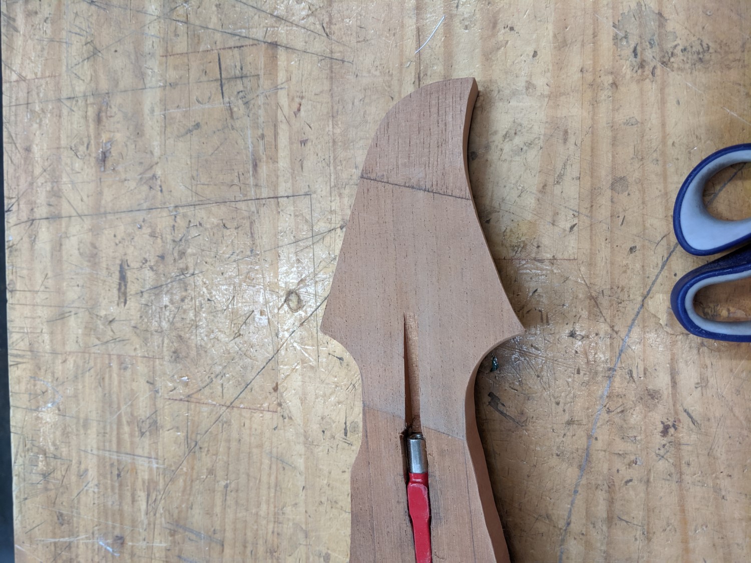

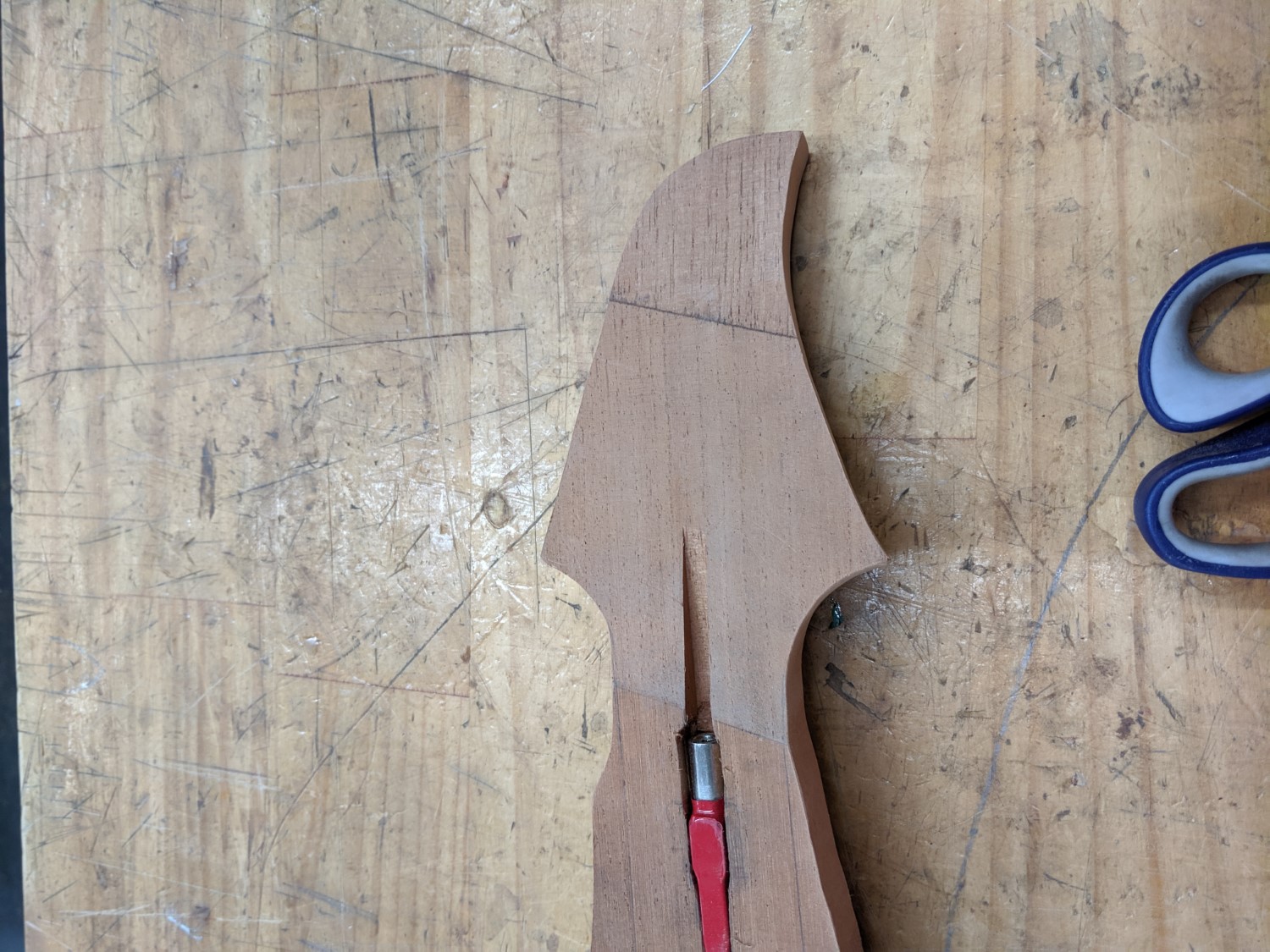

    Worked on the headstock firstly.
Name:	IMG_20190912_184638 (Custom).jpg
    Rough cut on the bandsaw then taken pretty close with the spindle sander, finished with just files
Name:	IMG_20190912_194312 (Custom).jpg

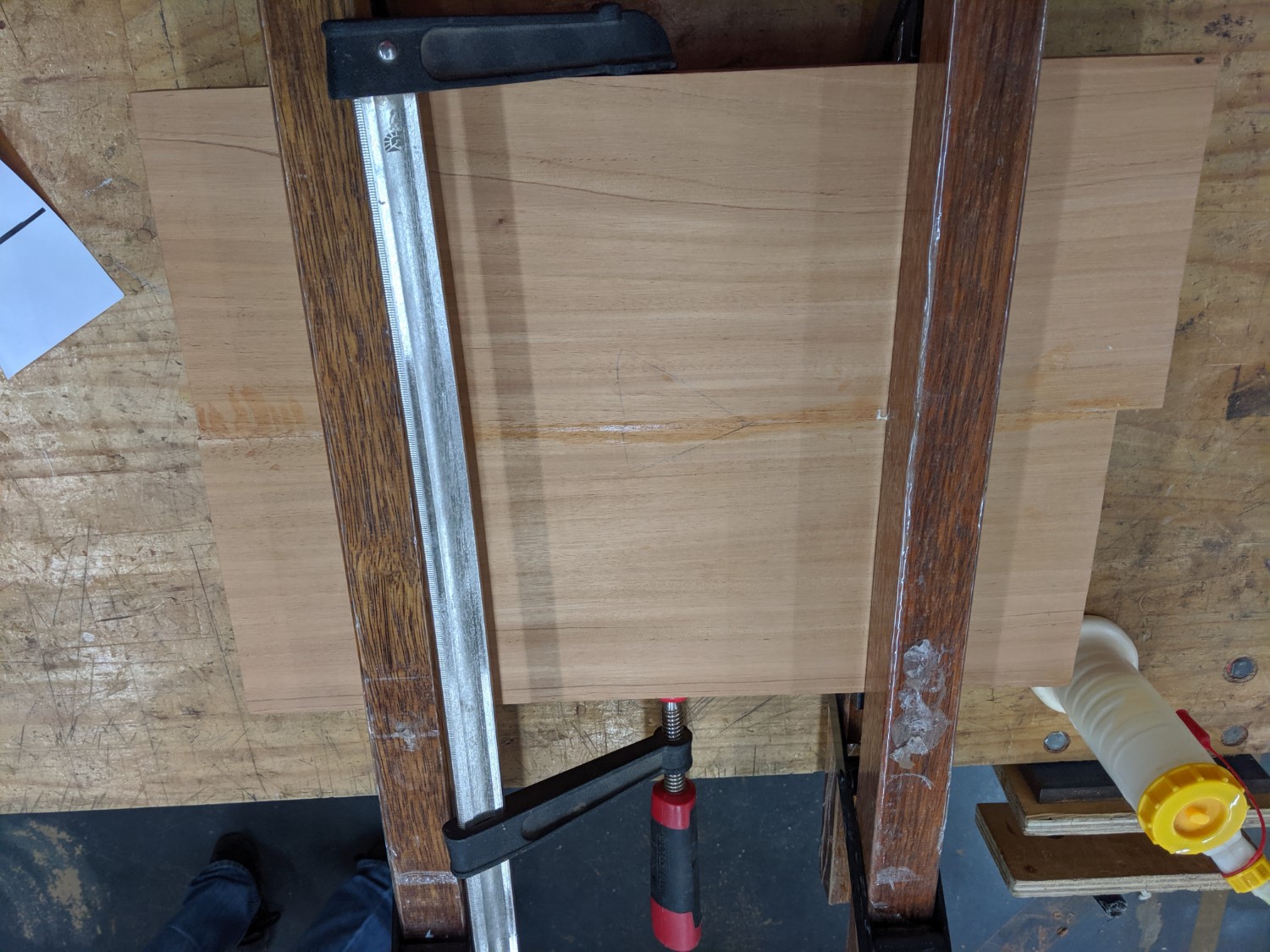

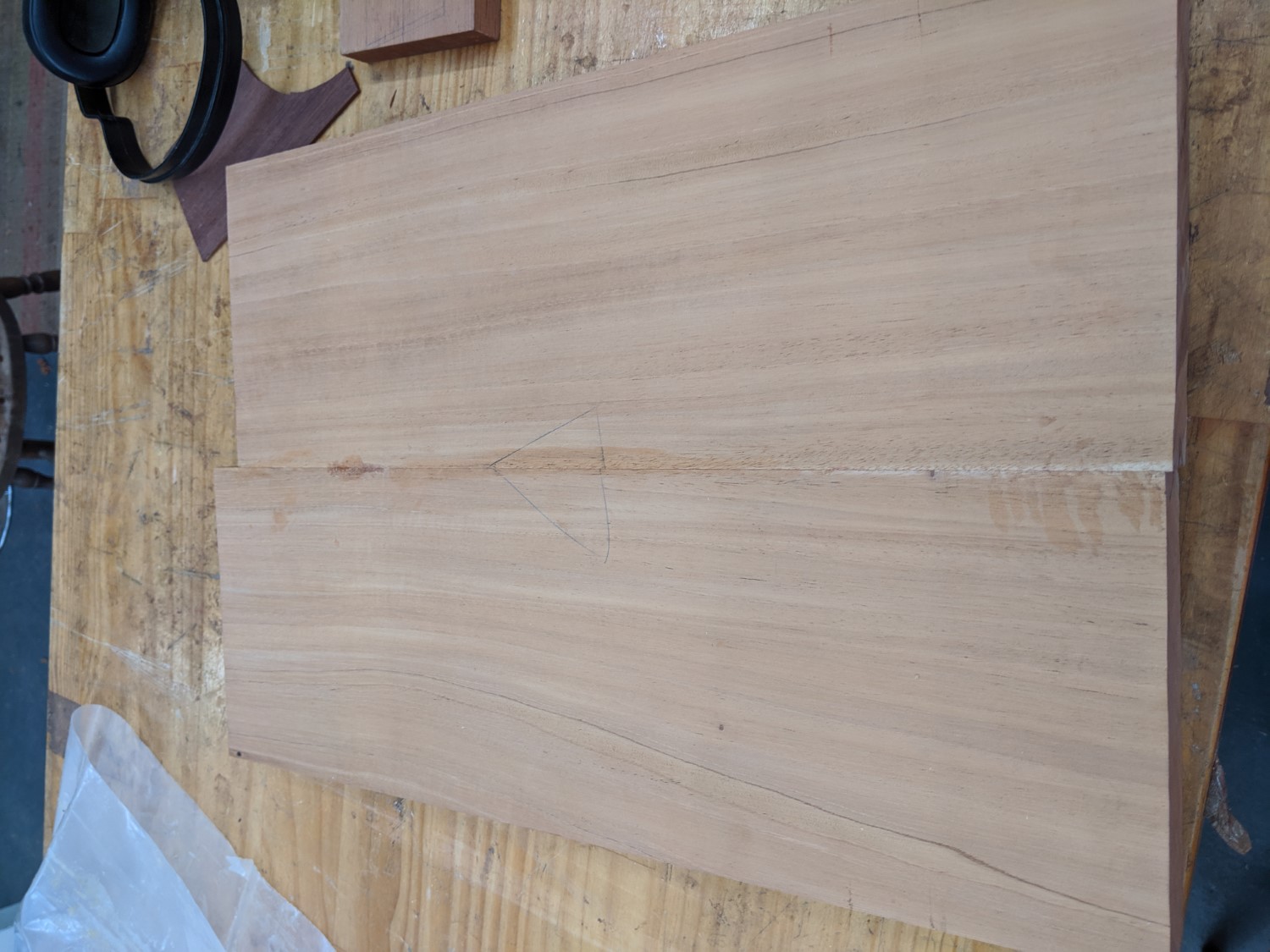

    Cleaned up the edges of the halves of the body blank
Name:	IMG_20190912_212453 (Custom).jpg
    Glued and clamped down
Name:	IMG_20190912_213453 (Custom).jpg

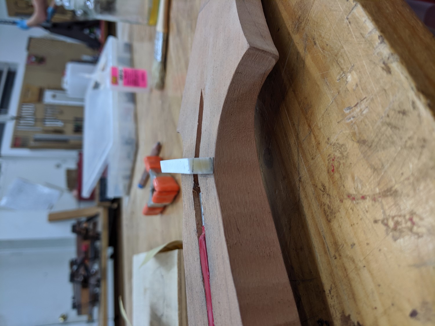

    And roughly cut the nut. Going to be angled and behind the fretboard, and glued down
Name:	IMG_20190912_223157 (Custom).jpg

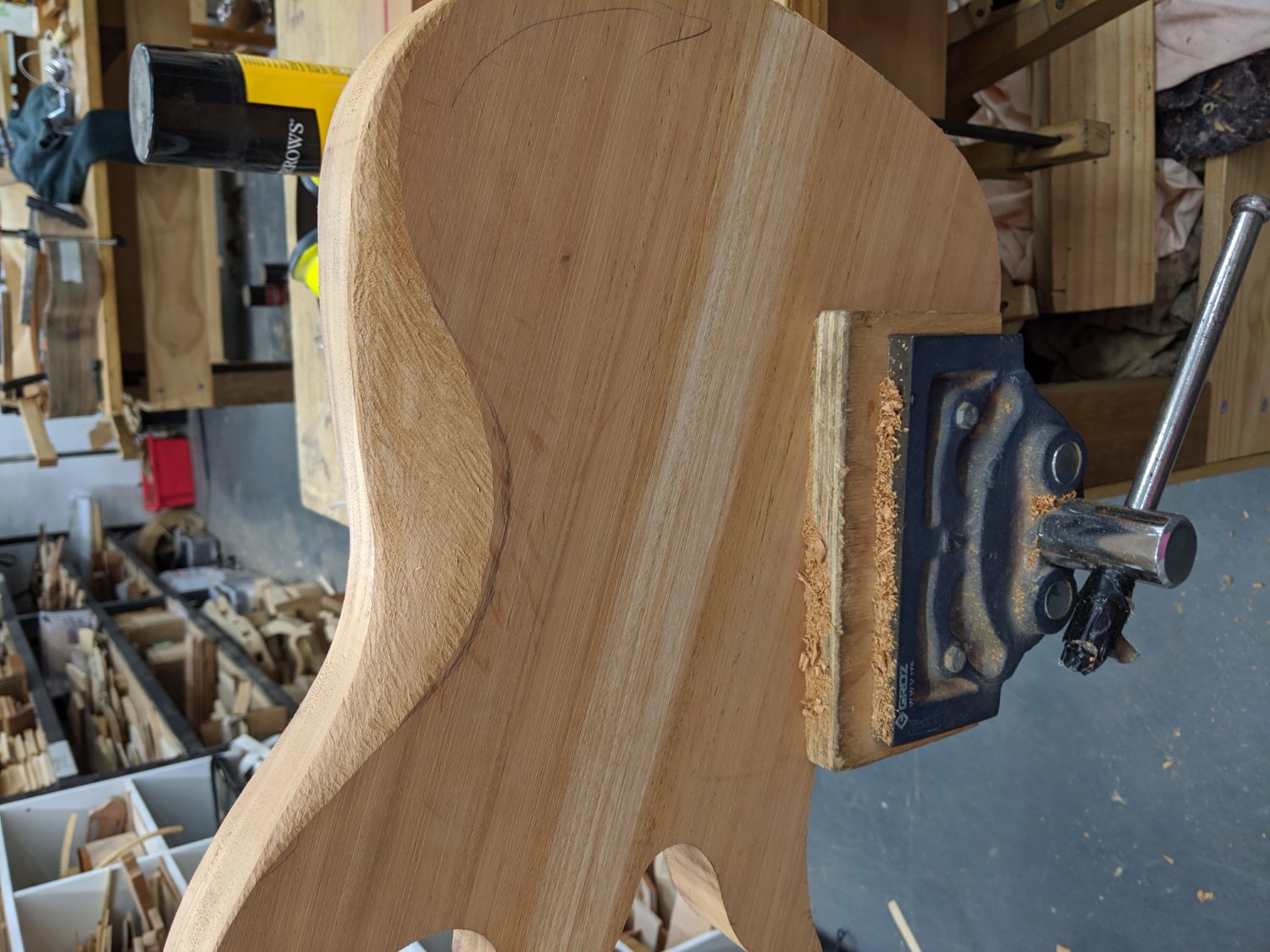

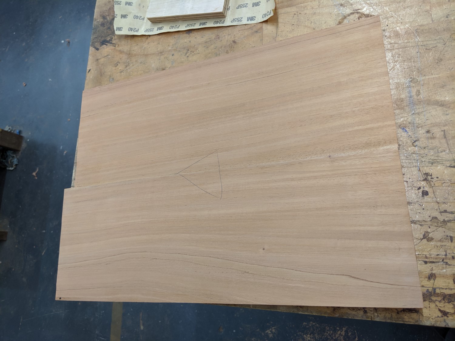

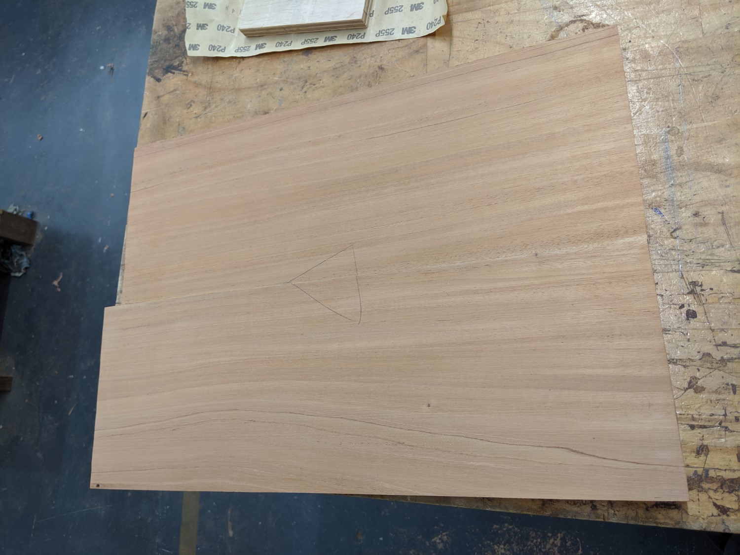

    So today was pretty straightforwards, but good progress. Body is all dry now and levelled it down flat.
Name:	IMG_20190919_182008 (Custom).jpg

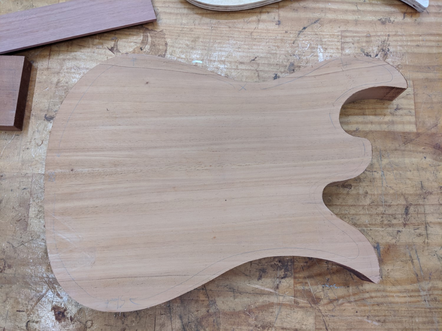

    Then got the template copied down and rough cut it on the bandsaw.
Name:	IMG_20190919_194251 (Custom).jpg
    Then routed nice and cleanly! All went really smoothly with it thankfully.
Name:	IMG_20190919_202440 (Custom).jpg
    Took out a belly carve on the back. Carving is so damn cathartic.
Name:	IMG_20190919_213218 (Custom).jpg

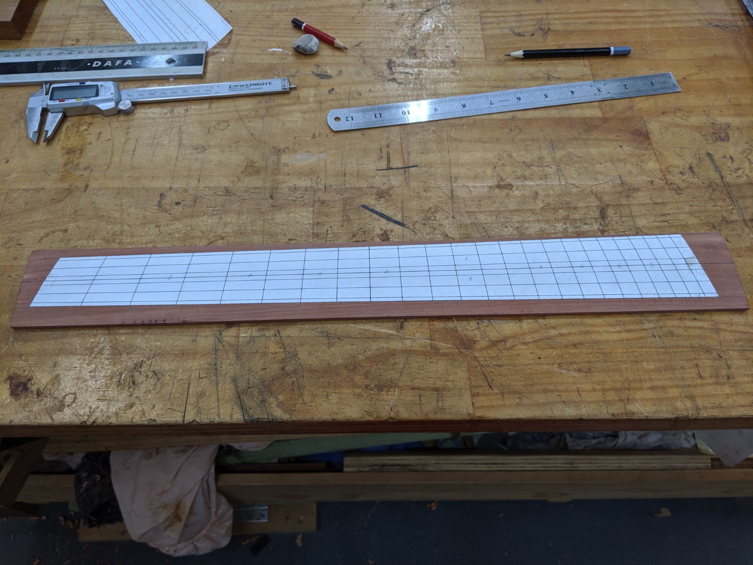

    Fretboard template is glued down, didn't end up with enough time to cut the slots after the carving, but it's all ready for next time.
Name:	IMG_20190919_213842 (Custom).jpg
