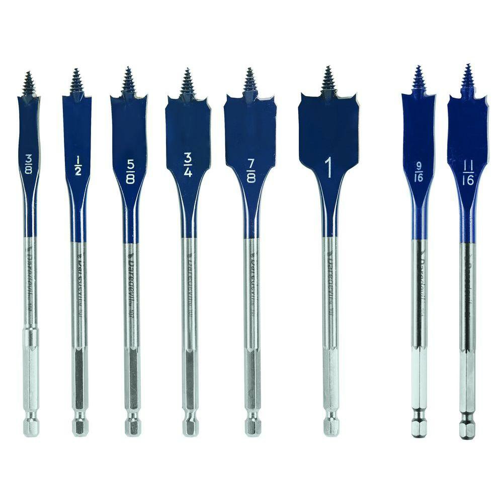

    I would not trust my own hand to do that freehand, and it would be hard to set up with a drill press forstner bots are very squirly. if I had to do it I'd probably be inclined to use a spade-bit. Still a bit difficult to control, but better freehand.

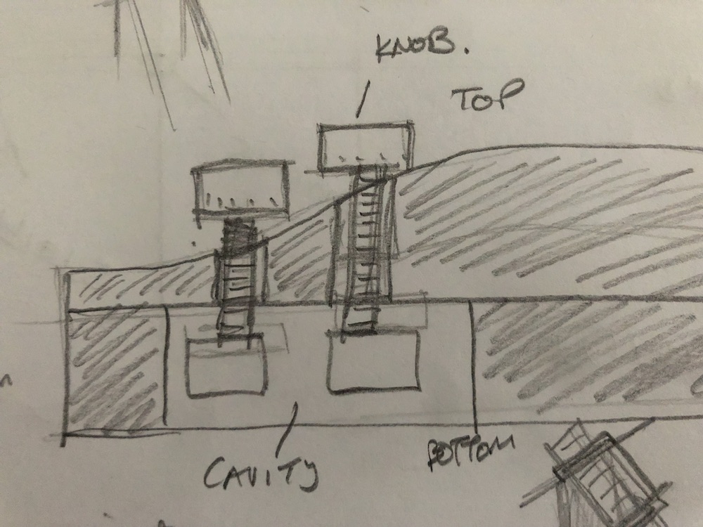

    Yeah, it is a lot but that's because the top is made to follow the curve on the outside not the inside. See pic i've added.
    I also added a pic i found of what i was thinking of doing, making an corresponding angle to match to curve but on the inside of the cavity. That way i could drill the angled hole using the existing hole as a starting point and hoping the gap on the inside (diameter of the hole given it will be the new plus the old) isn't larger than the washer nut to hold the pot in place. Or if it is, i could just get one that was larger in diameter so that the pot is clamped securely at the right angle.

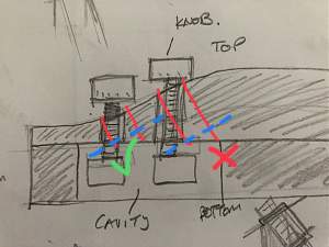

    I encountered the same thing with the curve on the front of Experiment #2. I settled on recessing the controls into the face. I’m not sure that you have the room in the cavity to go with plugging and angling the pot holes, unless you expand the cavity. It all looks pretty tight in there.
    You may create an interference issue on the cavity wall, but if you expand the cavity you can get around this.
    you will also need to angle the inner surface to get the pot to sit right see the blue line.
    Either way way is going to be some VERY careful planning and more careful Routing/boring.

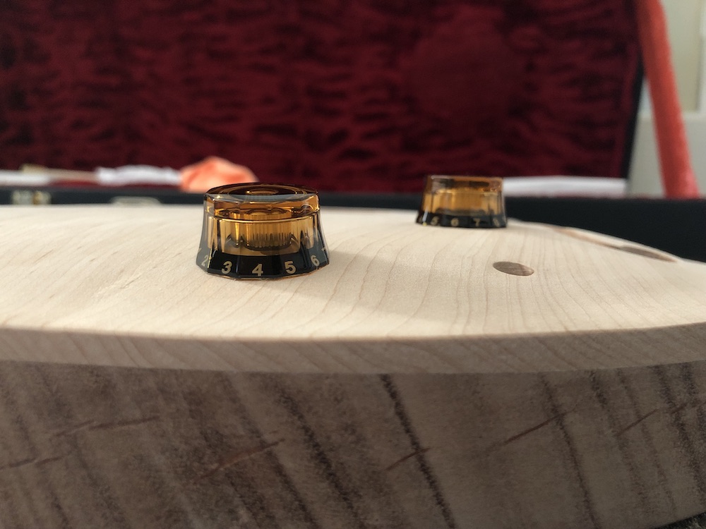

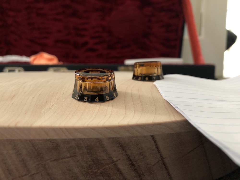

    Was also just thinking, i may only need to do 1 of the holes! I've included a pic that shows what i mean. I am having 2 pots and a selector switch, so....thinking that as per the pic i could live with one of the buttons as the gap on a straight drill hole isn't much (you can see that a folded piece of paper is already too high so i reckon i could leave this (or even sand the hole to one side by 1mm if required.
    The second button definitely needs to be fixed with the above option, but the third hole probably doesn't matter as much as its the selector switch so just needs to look on on the top.
    I probably need to use the dremel to widen the cavity a little so i can even out as per your pic FrankenWashie.
