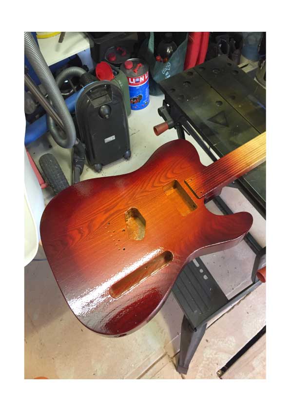

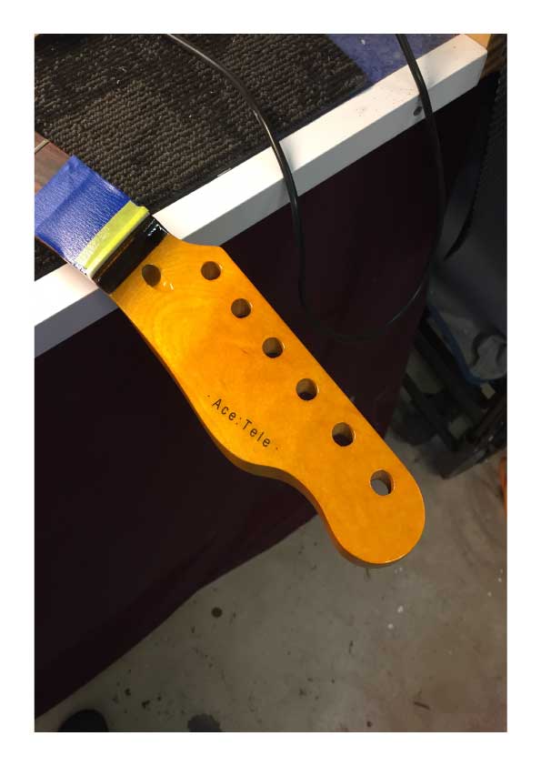

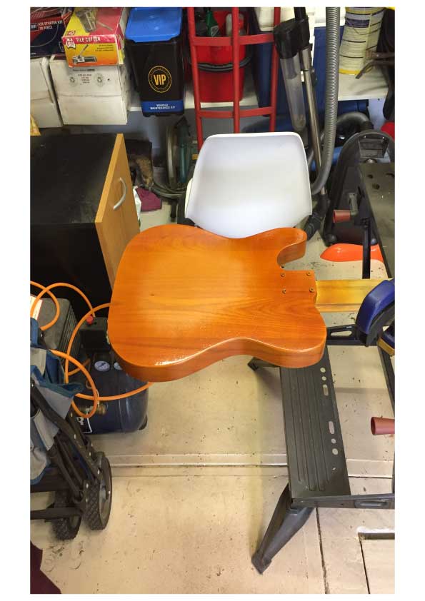

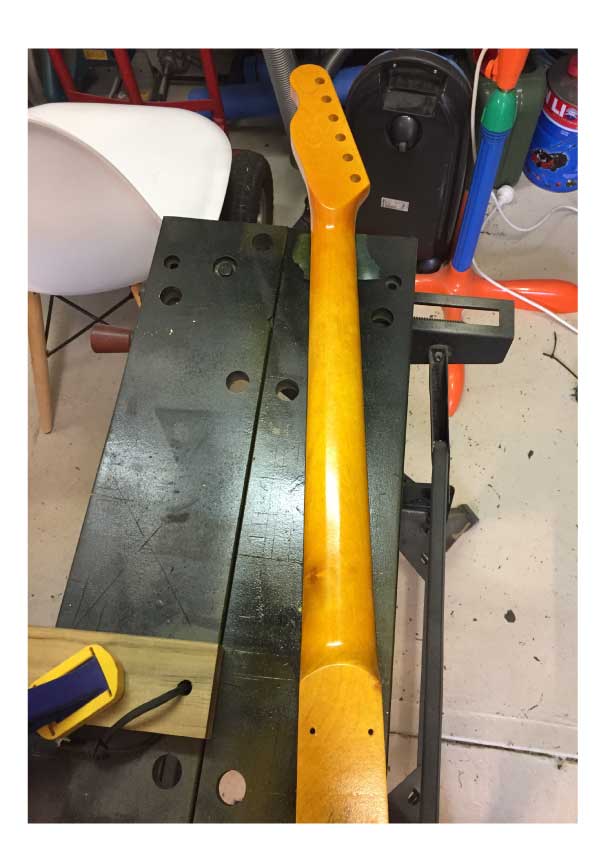

    I've made some progress on this build - I've gone with a cherry burst. The pick guard is pearloid white which contrasts well with the colours. I must say that I really like using the Nitro finishes - they are so forgiving to spray. Provided you use the correct PPE and ventilate the area it is all fine. I used Dartford Amber and Aged Cherry. 3 coats of Sanding Sealer first then the coloured finish.
    The neck has 2 coats of amber. The headstock pic is under about 3 coats of clear nitro. It's a simple decal - Ace is my amp 'name' so I kept the theme running here.
    The other pics show the burst process from the amber base and through to the cherry addition. The pic of the top is with x2 coats of clear on top. I think it has come out OK for a first go. I noticed there are a couple pin holes from incomplete grain filling I reckon. They have filled with the clear somewhat and I'm, hoping they'll fill some more with additional coats.
    Let me know what you think!

    Just noticed one small area on the front rear of the body that looks to have created a tiny (~1mm) bubble. What a pain!
    I resprayed the area and pricked the bubble with a pin and it bubbled again . It looks like that might need attention after it has cured and sanding commences.
    I’ve since had a whole bunch pop up in this area. Some are like pea sized. I must have laid it on a bit thick in that area and they formed as the lacquer was gassing off. Only thing I can do is wait, sand it off and re-do that whole zone. Live and learn!!
