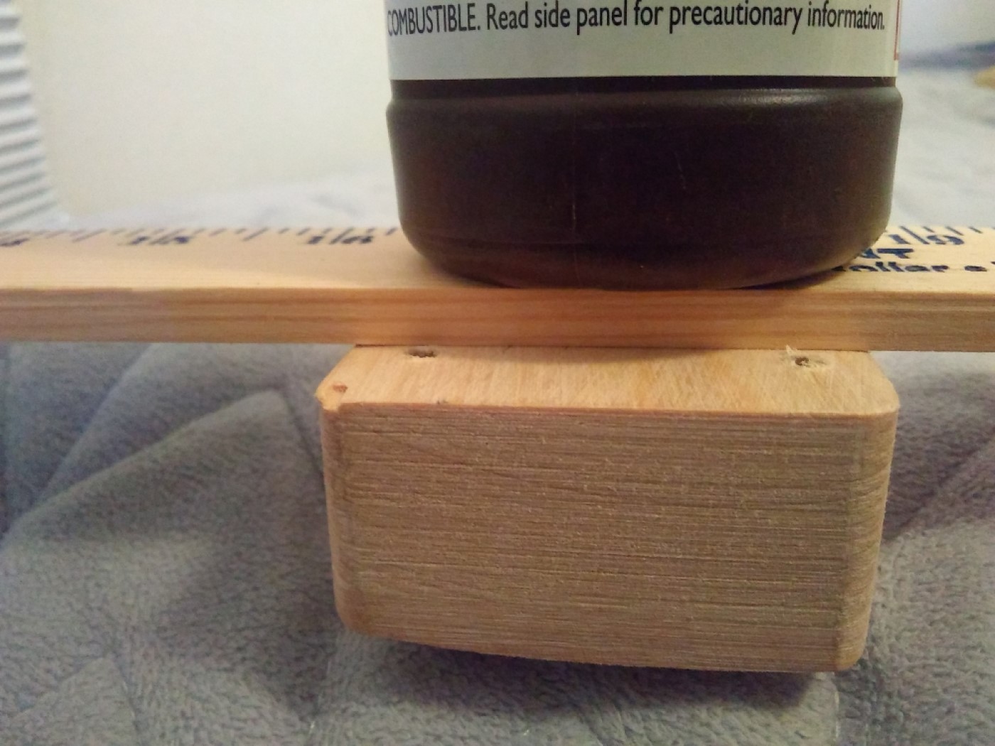

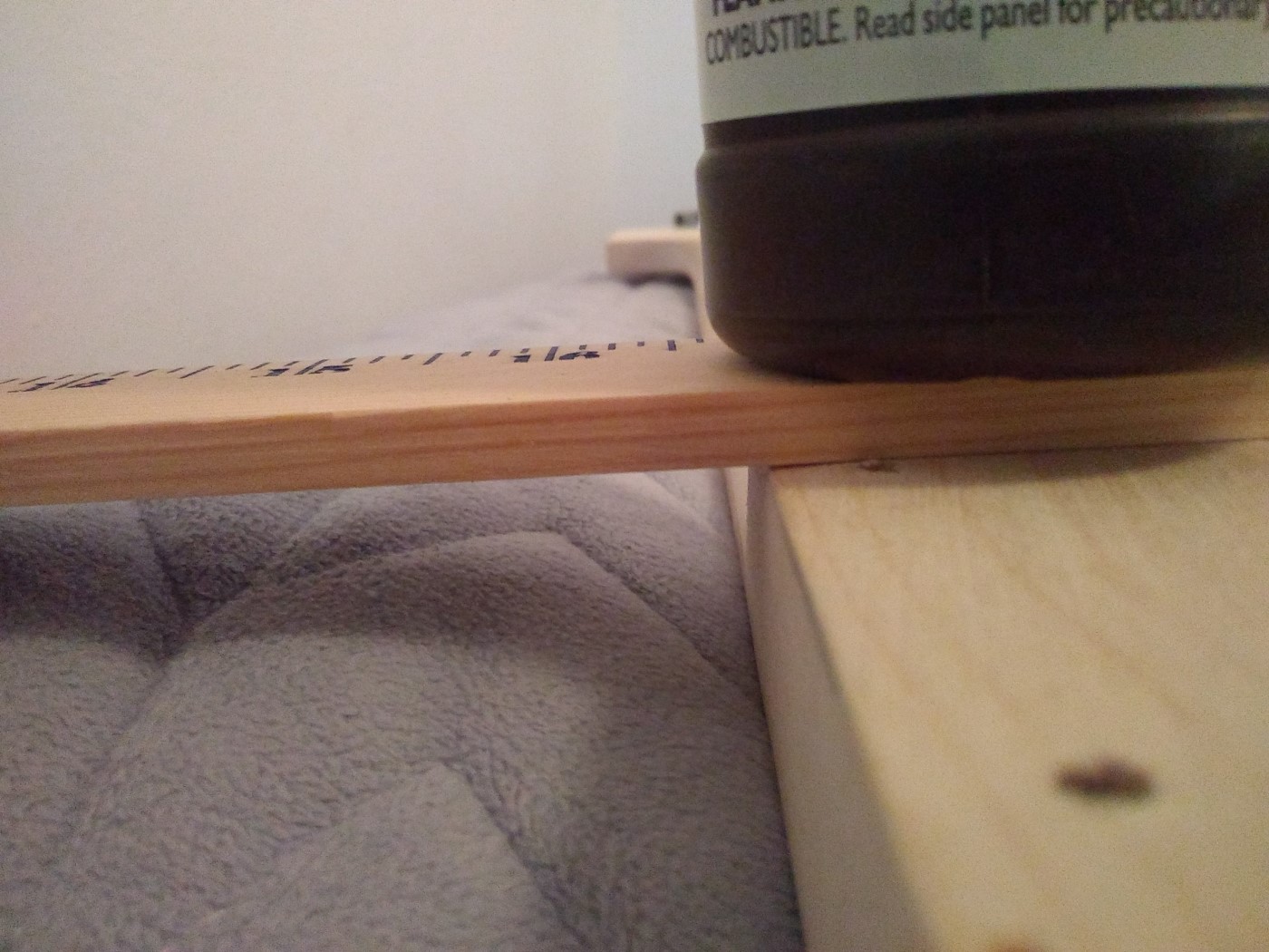

    Thanks for the reply! I just did measurements on the body and the neck and the culprit is most definitely the neck. The body is the same height at both the treble and bass sides, while the neck is taller on the bass side by 1 mm. There also seems to be a bit of a curvature going on at the bottom of the neck.

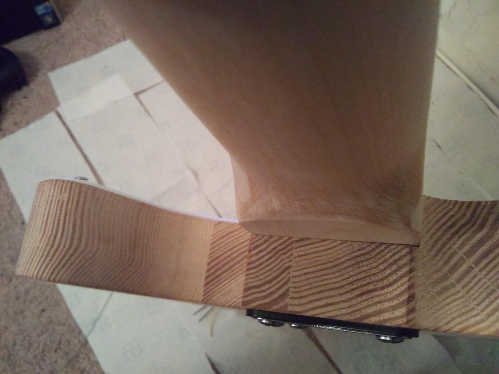

ID:	31709Click image for larger version.
ID:	31710Click image for larger version.
    It seems like the bottom of the neck has some sort of taper on both sides... I'm guessing this is not normal, right?
    Maybe getting a new kit that doesn't have this problem would be the best way to go haha.
    mark a pencil line all around the neck heal from the lowest point. That way you can see where the neck is thickest and how much it changes. Then simply use a sanding block to get it flat. Use a hard or firm block and go with care and you should be able to square up the heal

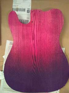

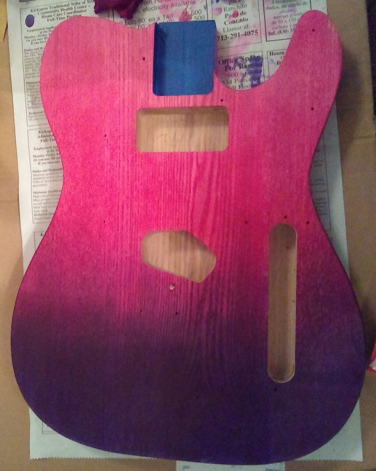

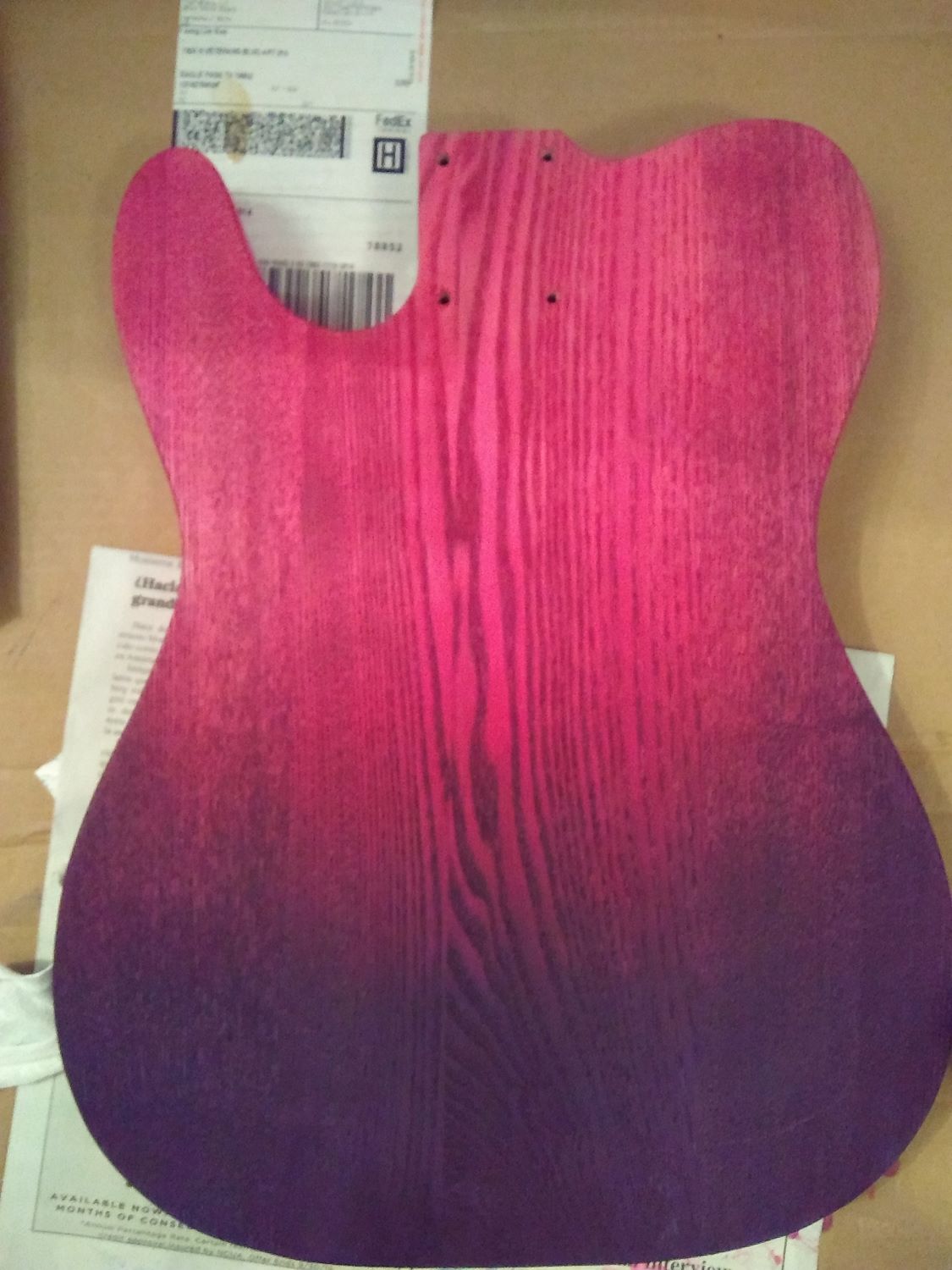

    I however, have a different question. I started to dye my guitar using leather aniline dyes. I left it for about 16 hours, and began applying tru oil to the back of the guitar. I found, however, that some of the dye rubbed onto the rag. How long must one wait to apply tru oil after dying a guitar? Here are pictures of the front and back

    Hard to say - if the Tru Oil is a solvent for the dye, then it will happen every time... Tru oil contains mineral spirits, so if the dye is oil based then you have issues...
    Read the label on the dye - and remember it is designed for leather, and check the cure times. But if it is transferring to your rag then I’d assume you would want a minimum 24 hours. If there are no time issues, give it a week. If Tru Oil pulls it up after that amount of time then tru oil is possibly not for this project
