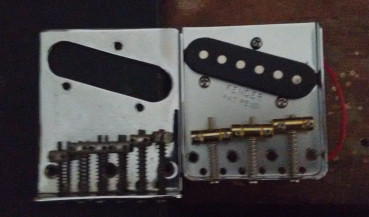

    1. The 3 holes will be for the bridge but I don't see a hole for the earth wire, I would have expected it between holes 2 & 3
    The whole area between those 3 holes and the bridge pup rout is under the bridge plate so drilling from there to one of the cavities shouldn't provide too many heartaches
    2. I used a Wilkinson 6 saddle bridge and it sits further forward than the kit bridge which has much longer intonation screws to get the bridge barrels where needed so I had to open up the bridge pup route by about 6mm ( 1/4" in yankee money )
    Do a dry build of the kit using clamps and use string or fishing line for the two E strings to check alignment and scale length before putting any screws in.
    I had to drill the holes so I used low tack masking tape to draw pencil lines on in the markout, I suggest you do the same even though the holes are predrilled.
    If there is glue in the surface Goo-off ( or local equivalent ) will get rid of it but make sure you don't use coloured cloth as the application and rubbing medium, the dye will come out of the cloth I have a small pink stain under the Tuff Dog bridge (phew luck that time)
    Take your time and ask questions, the Tele kit is probably the easiest to build.

    Thanks so much, David. I just assumed that all Telecaster bridges had 4 mounting holes. That's why it confused me.
    Looks like my kit won't arrive until next week. You mentioned that different Telecaster bridges have different dimensions. Do you think the Wilkinson 3 saddle bridge will cover these holes? If not, what should I do about it?
    I've already got a can of Goof-off and everything else I expect to need for the build. However I've held off buying a Dremel. I'm hoping the pickup routing won't need to be modified. FYI I'll be putting Tonerider pickups in both slots.

    Seems it's modeled on the Squier, which has 3 mounting screws and an elongated bridge plate.
    Should be fine unless you want to replace it with a 'Fender' one or even 'Wilkinson'.
    If I could be bothered, I'd get myself a full size Telecaster template and see exactly the differences.
    Mind you, my neck was a edit: few mm short on the butt end which excaserbated the issue.
    cheers, Mark.

    I actually was planning to use a Wilkinson 3 saddle bridge. Will these holes be concealed if I use it? I want a bridge that I can attach the chrome pickup cover to. Are there Any bridges like that which resemble the stock Pitbull bridge in size?
    If I cannot conceal the holes can they be filled in well enough to be unnoticable?
    Geez, I haven't started yet and already screwed up
    2,824
    The Wilkinson bridge should be fine mine was.
