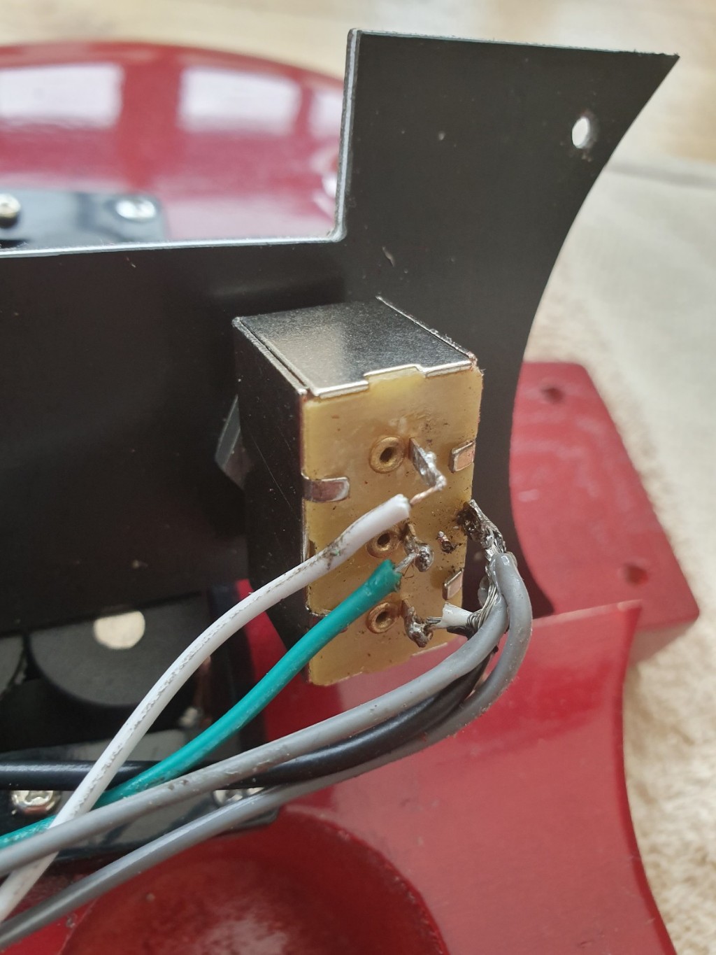

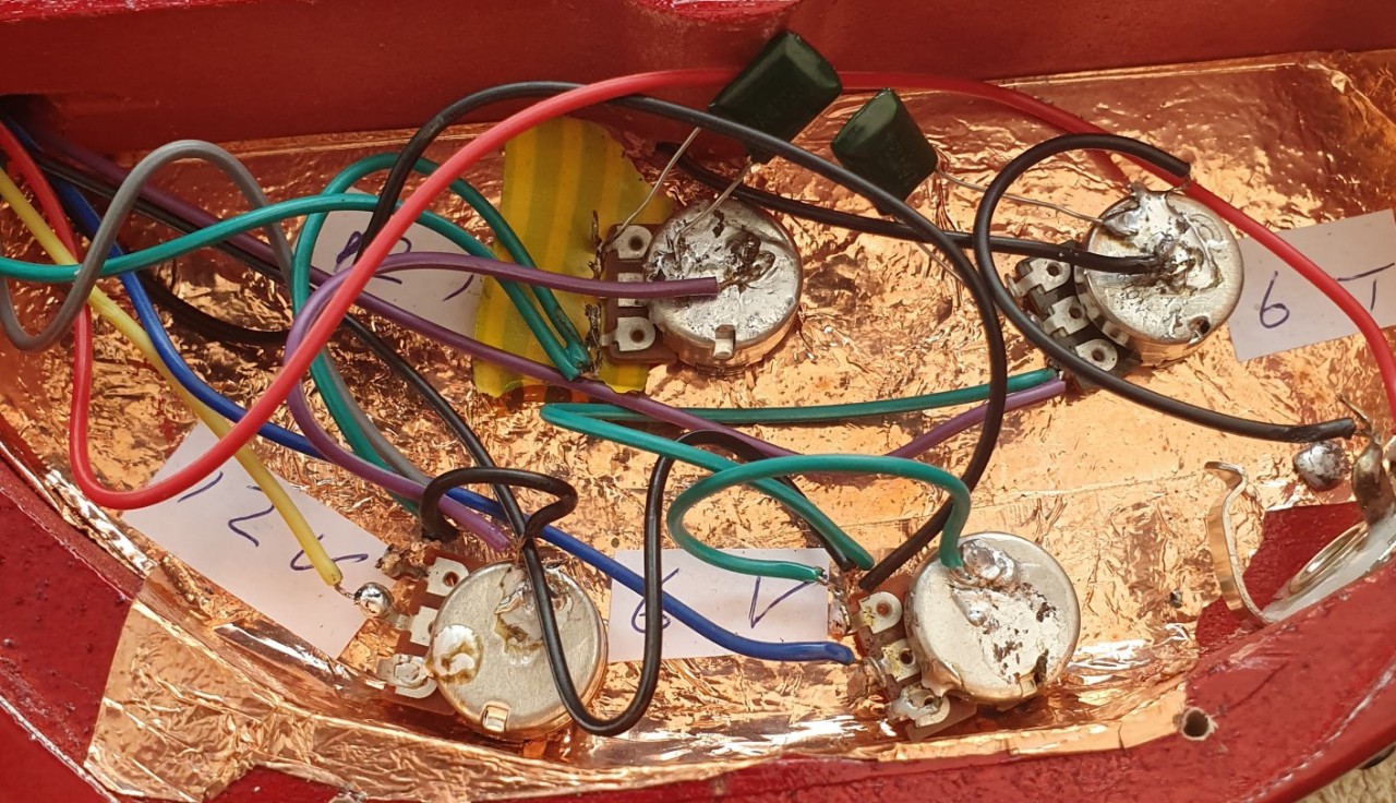

    Hi here are some pics of my guitar and wiring.
    I'm fairly happy with the way it looks ( apart from the burns I did by accident with the soldering iron) but when I attach my amp I'm not getting any noise when I tap the pickups I have redone nearly all of the wiring
    With new solder . I had to extend one of the pickup wires as they weren't long enough as the pickup selector switches are by the necks on this guitar. Hence the shrink tube .
    Can anyone see anything obvious that I'm missing? Thanks Chris.

    Wiring pictures double neck
    A few pictures of wiring, looking for any ideas or help on getting sound out of the guitar, thanks

    5,513
    Sometimes the solder-lugs on the pots can go a bit loose if too much heat from the soldering iron is applied for too long when soldering connections, this can cause the output to go a bit intermittent (cuts in and out randomly), had that happen to me a few times in the past.
