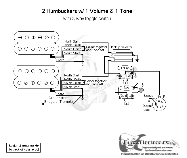

    here you go
    1 tone, 1 vol, 1 3way switch.

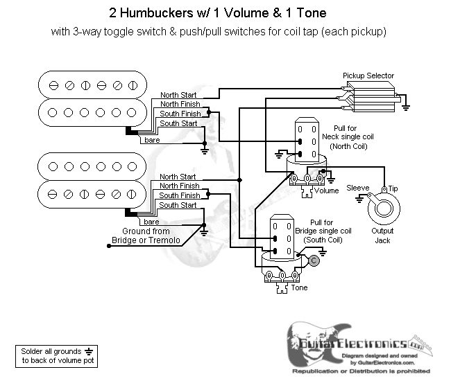

    or if you want to split the humbuckers with push/pull pots

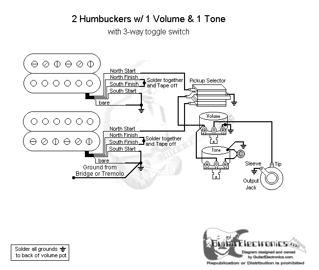

    If you want to do 2 x vol & 1 x tone (same as Explorer) this is a basic idea but suggest you adapt it from the humbucker ones supplied above from Dedman.
    https://www.pitbullguitars.com/wp-co...pot%202017.pdf
