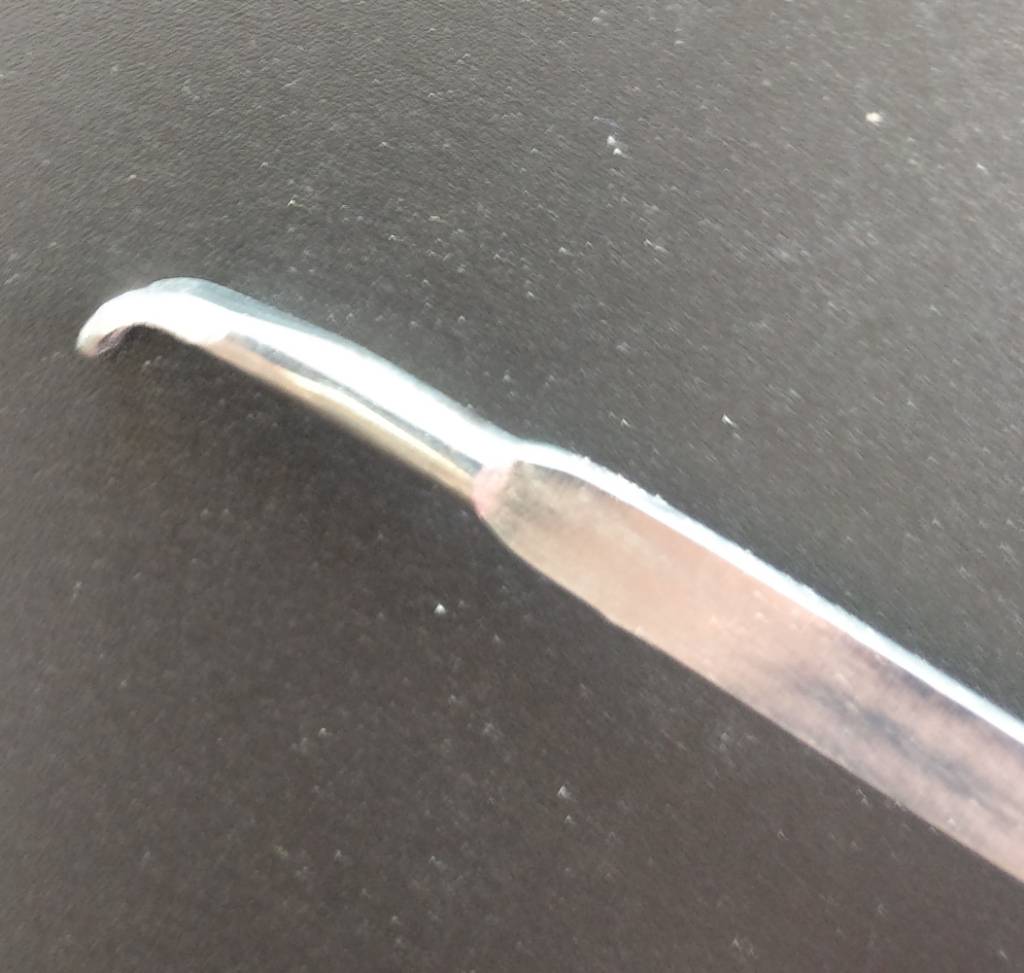

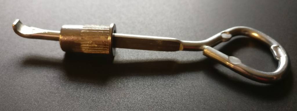

    I finally found a tool that could get under the bottom of the bushing so that I could get some leverage to pull it out.
    I put a couple of pics of it below. I don't know if it's the same in Australia or elsewhere, but in the US paint stores often give these tools away to open paint cans. I had to file down the edges a little to get it to fit. Once I could get it in it worked. It was still hard to pull the bushing out, but if this had not worked I am not sure how I'd have done it.
