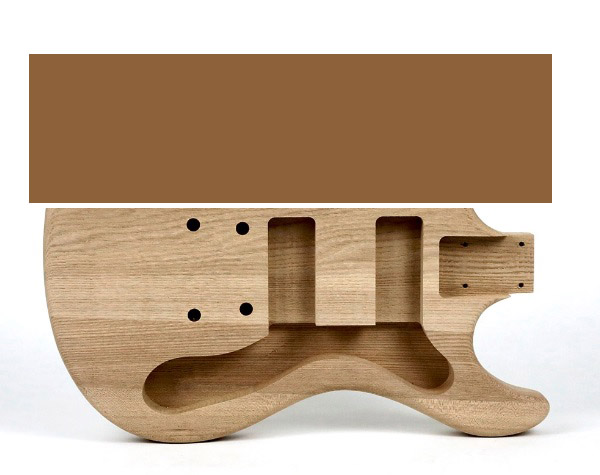

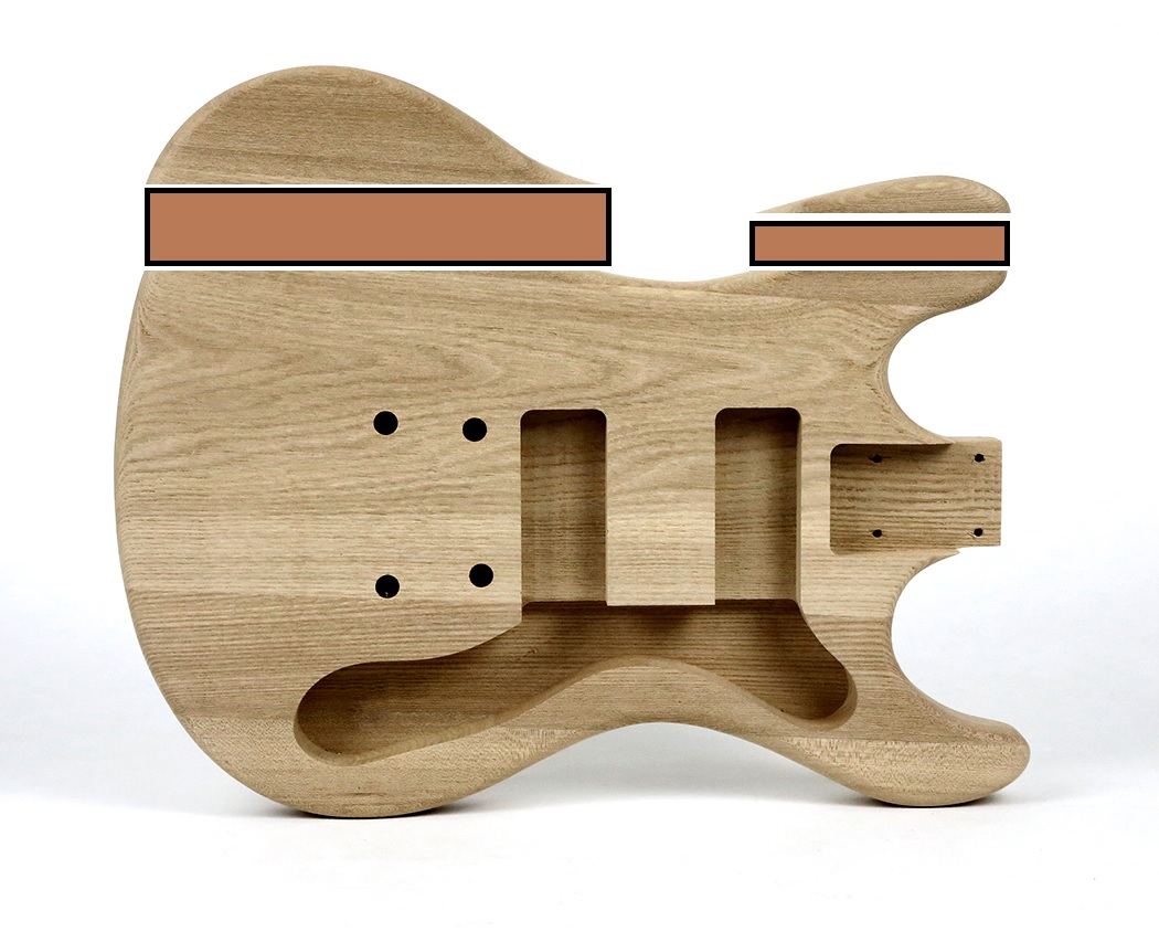

    And technically, what is the easiest/best way to do it?
    I GUESS example one below is the easiest way (just saw through the body, add two wood blocks, glue everything together again (before reshaping).

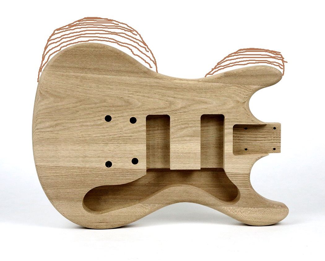

    Ex 2 is multi layers of thin (1-2mm wood stripes glued on top of the body). I geuss this is harder and that there will be a huge need of filler etc…?

    So, what is best in your experience, should I go for example 1 or 2?

    Personally option 1 looks easier and more reliable...
    +1 Top way would be better.

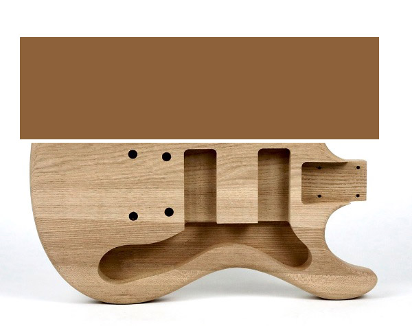

    However (if I may be so bold) I'd probably do it more like this.

    I would be inclined to go with Marks suggestion as well from a stability and easier glue up perspective.
