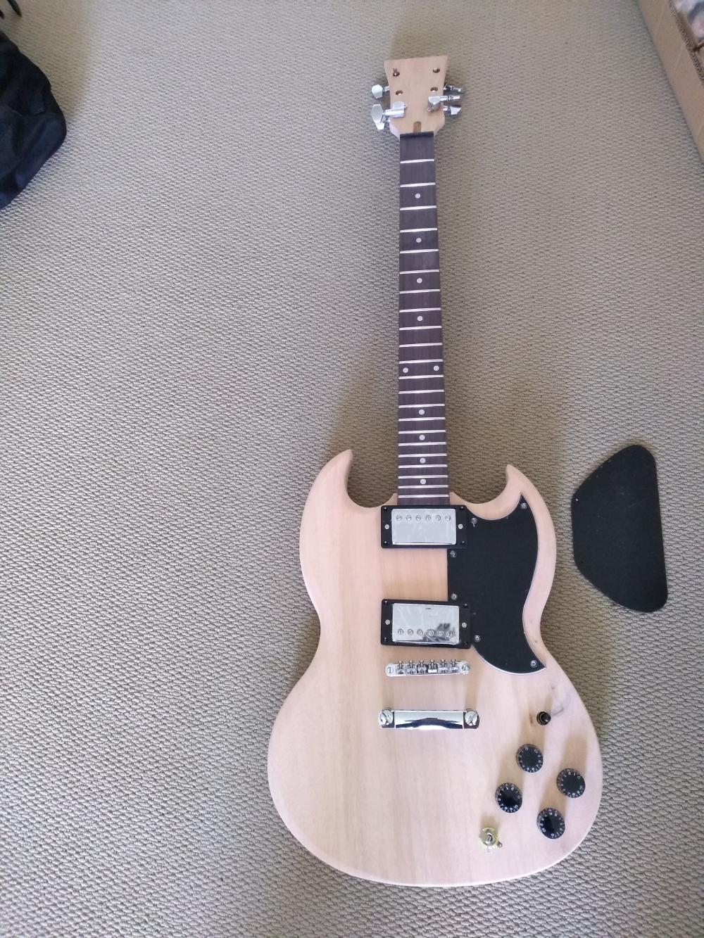

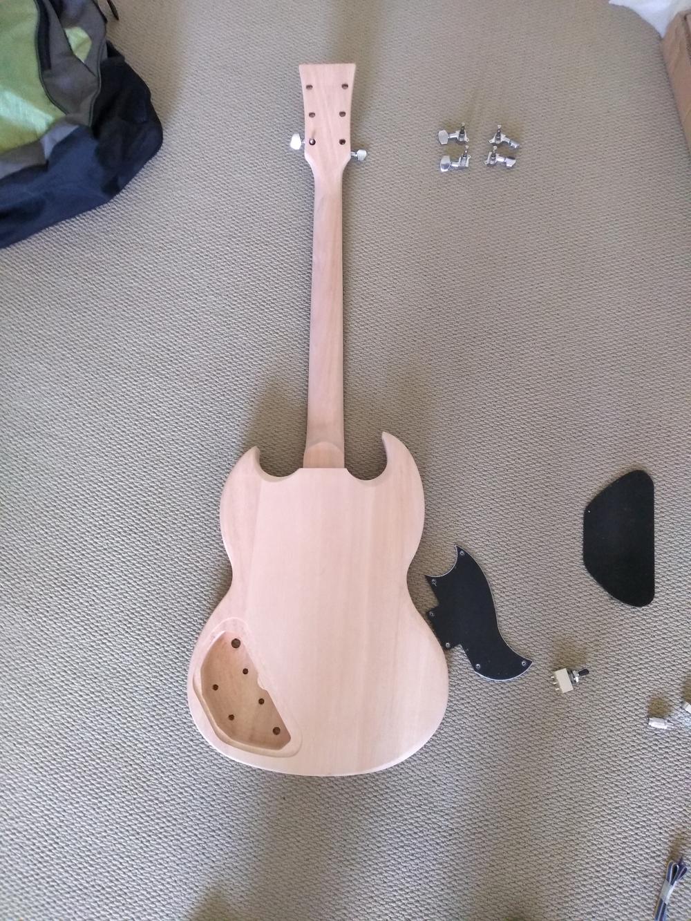

    AGM-1 My First Build
    Opened the box and did a mock build everything seemed to be there.

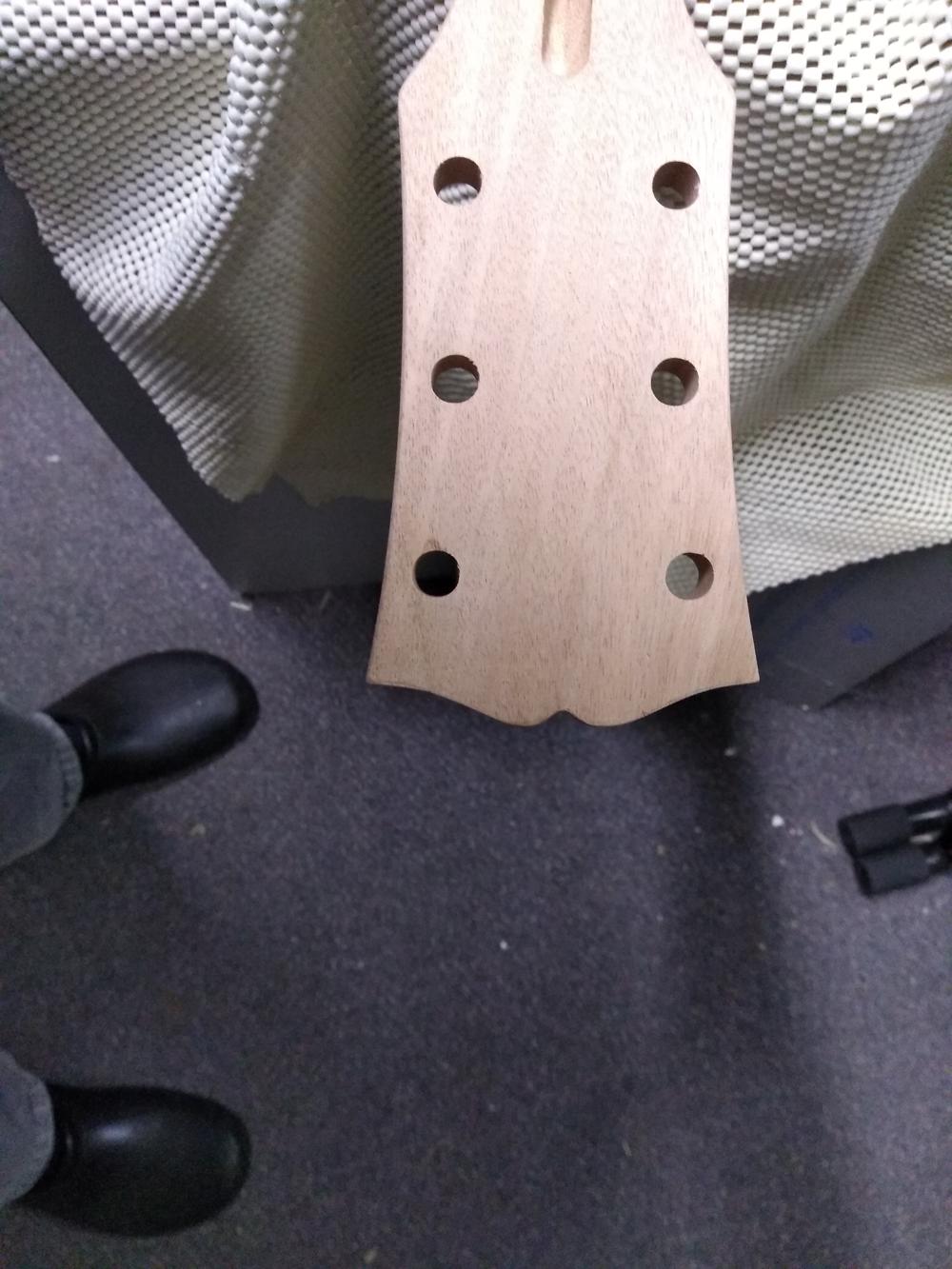

    Headstock Carved
    Carved a design in the headstock not as scary as I though it would be. Obligatory picture of my feet.

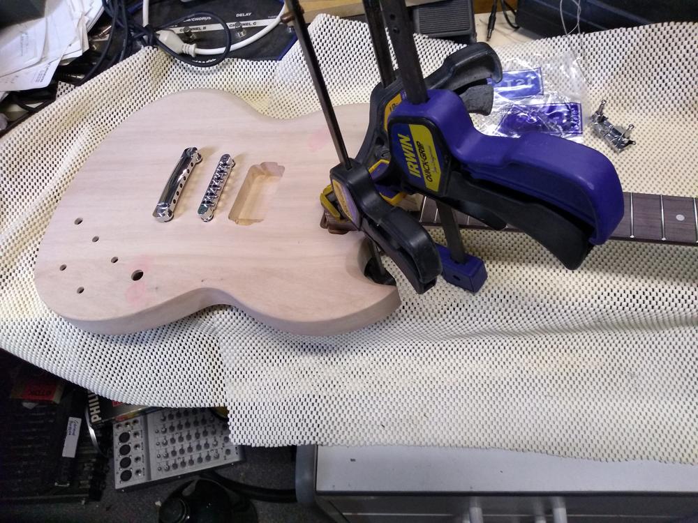

    Glued neck
    Checked the neck alignment by attaching both E strings and then decided to glue the neck in place with Titebond original glue. Had to put a caul and clamp on the fretboard as the clamps on the neck foot raised the front of the neck slightly from the body. Was happy when the glue squeezed out from the neck join.
    Nice work there, when you say you carved it, are we talking chisels? If so, much applause, it looks beaut!
    Member stansby40's Avatar
    Mar 2019
    Tasmania
    93
    Sorry no chisels but a band saw, bench sander, round file and sandpaper.
    Ooooh I have band saw envy....I’m still doing mine with a coping saw....🤬.
    not so bad on a headstock, but a penance for body outlines.
    wow already glued the neck!

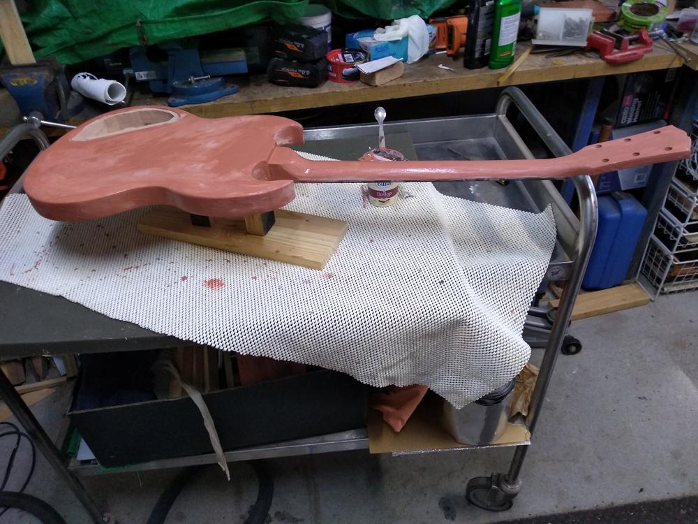

    Sand and pore seal
    Sanded with the random orbital sander and by hand then applied a generous coat of mahogany timbermate. Forgot to tape the fretboard hope it cleans up OK.

    Oops!!
    Had a disaster on the weekend. Didnt sand enough of the timber mate off so that after I applied the mahagony stain the appearance was very splotchy with many imperfections. Sanded off the stain again which took a lot of time. Then I realised that I hadnt shaped the body to look like an SG. The bevelled sides are way too narrow. Will now draw lines on the body and get the rasp out. Would have been easier to do if I hadnt already glued the neck on. Oh well you learn from your mistakes.

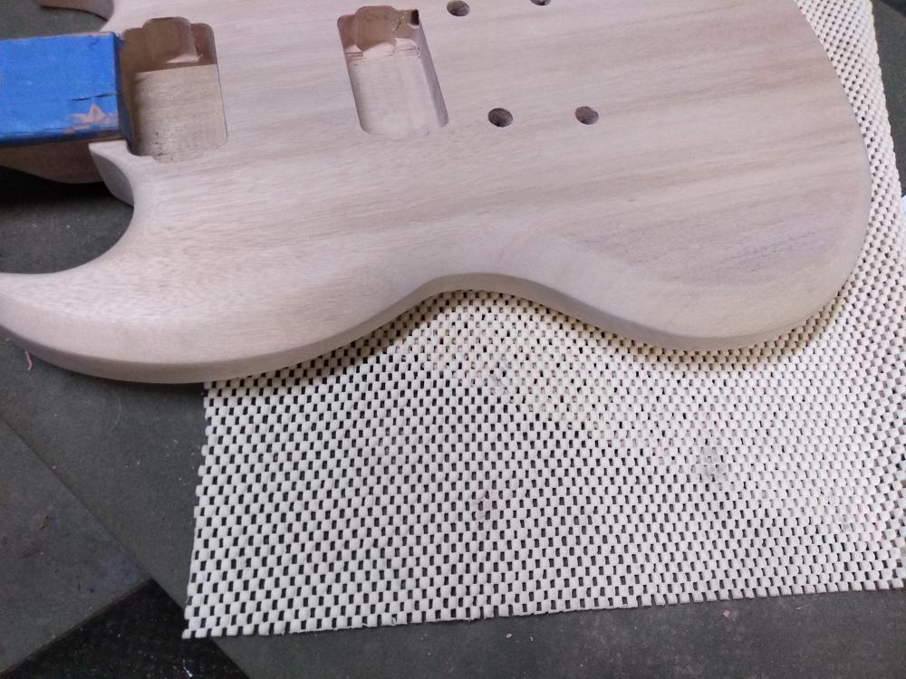

    Some Progress
    Had most of easter off doing family things but managed some progress and now have the bevelled sides looking more like an SG.
