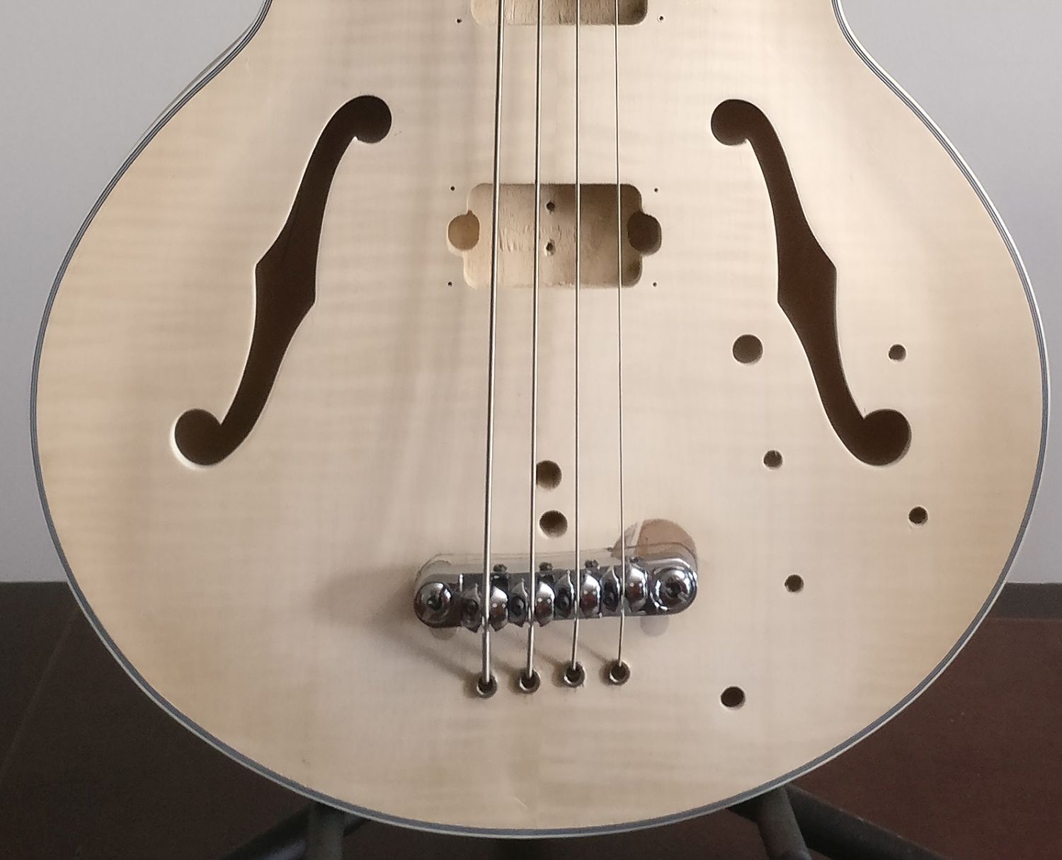

    I did not install it before because it is a bit too wide for an ESB-4 center-block. I ran into a similar problem on my current project. I had to move the bridge location a bit from where was...and the center block was no longer wide enough to accommodate. So, I did a little surgery...and it fit!
    So first caveat is that this bridge it TOO WIDE for the standard center-block on a Pitbull ESB-4 kit. It might make a nice alternative to the three-point on a solid body, however, particularly if you combine it with it's matching tailpiece...

    The bridge, however, is very nice on its own. more massive than a standard Gibson-ish tune-o-matic. As you can see, I used it string-through. I think it could also be used with a trapeze. You could even use it with a smaller Gibson-style or Warwick stop-tailpiece. However, even the smallest two-point stop tailpieces are too wide for the ESB-4 center block without some modding. On a solid body any of the above would work.
    This bridge is WAY more adjustable than a standard tune-o-matic. The saddles have quite a bit of travel. As with most 2-point bridges it is only adjustable for height at the ends. The saddles do not adjust individually for height. However, the ends are easier and smoother to adjust than most 2-point bridges I have tried. One cool feature is that once you get the bass intonated, the saddles lock into place with an allen-key set screw so they cannot move. Once the end-pins have been adjusted for height, the BB-100 end pins are also locked into place with a allen-key set screw. As a result, even though this is a two point bridge it feels very solid, and does not rattle or move at all, even with the strings off, once all the set screws have been locked down.
    It should work in place of a 3-point any of the PB solid body kits that use a three-point bridge if you get them un-drilled, an don't mind doing a little drilling. It's not taller than at stock 3-point, and it's easier to adjust. It might take some shimming to get it to fit on a fender-style bass. It looks a bit taller than a standard F-style bridge. Ironically the F style basses come undrilled but the three pointers would have to be ordered that way. that said, I'd go to the trouble in place of a 3-point. Especially with the massive BT-100 tailpice, this is way more solid than the OEM 3-points.

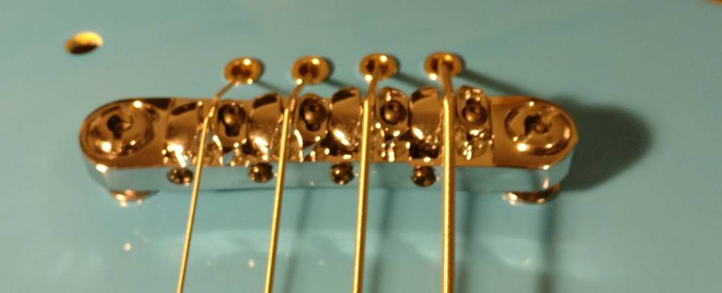

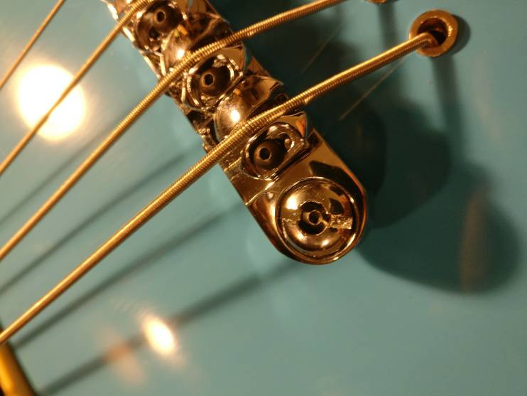

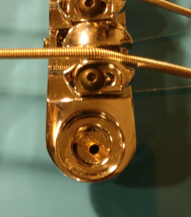

    Now that I have mine installed and intonated I have a couple of more observations.
    It is very easy to adjust this bridge. You take off the cap that covers the top the height adjustment screw to adjust the height. Once you have the height where you want you replace the cap and lock it down with an allen screw. This is super solid. The bridge will not move once it's locked down.
    The saddles have lots of travel, more than on any other two-point bridge I've ever seen. The saddles move very smoothly. They're also easy to adjust, in part because the adjustment screw is off to one side of the string rather than directly under it. This makes it easy to slip the Allen key between the strings to make the adjustments. When you have the string length set the way you want it, lock the saddle down with the Allen key and it won't budge.
    Overall I continue to be really impressed by this bridge. Click image for larger version.

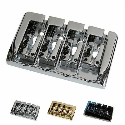

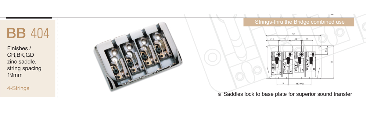

    On my next build, however, given how well I like the Sung Il on my hybrid bass, I am thinking I'll try a Sung Il BB 404:
    These are available for around $20 USD, and have been OEM on a number of basses--including some from Carvin (remember Carvin?) and Yamaha. For 20 beans they seem worth a shot. Of course $20 is about 5x more than a C-clamp, but these are also shiny ;-)

    That Sung Il bridge looks nice, but just check the string spacing is suitable, as 19mm between strings is quite a wide spacing. It got me looking at the 5-string version as a replacement for the one on my '80s Peavey 5-string bass, but that has 16.5mm string spacing (and I thought that was pretty wide!). I can't go any wider on that without the strings falling off the fretboard.

    I was actually looking for 19mm spacing, which I think is pretty standard on Fender-style 4 strings. Both my Precision and my Frankenjazz have that spacing. My hybrid with the Sung-Il two point bridge has 18mm spacing, and I don't feel a lot of difference. That said, one of the reasons I don't have a 5 string is that the string spacing always seems too close to me. Fat fingers I guess.

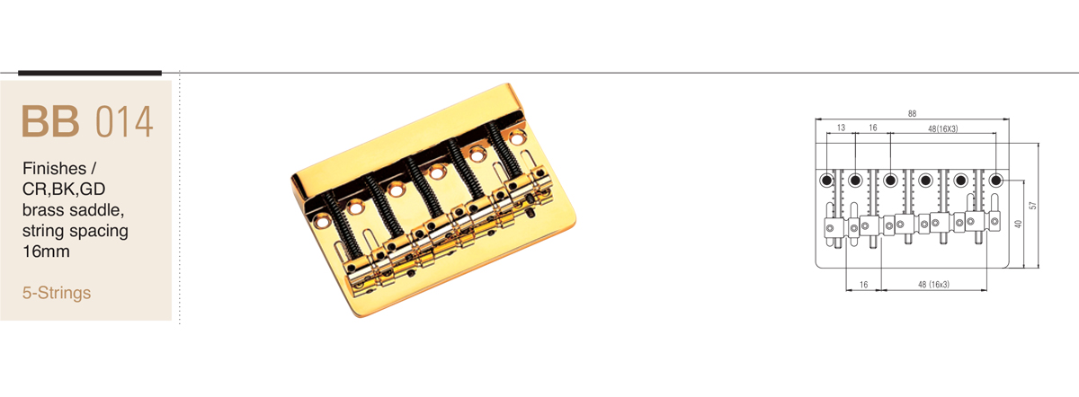

    ...these appear to have a grub screw like the G&L saddle locks and are also about $20 US. There are a bunch of 5 string bridges, but most of the ones I saw on their website that had lock-down saddles were for string-through basses. You might take a look to see if anything appeals. I saw some UK sites that seem to carry them.
