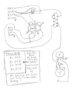

    So here's a sketch...did I get it right?

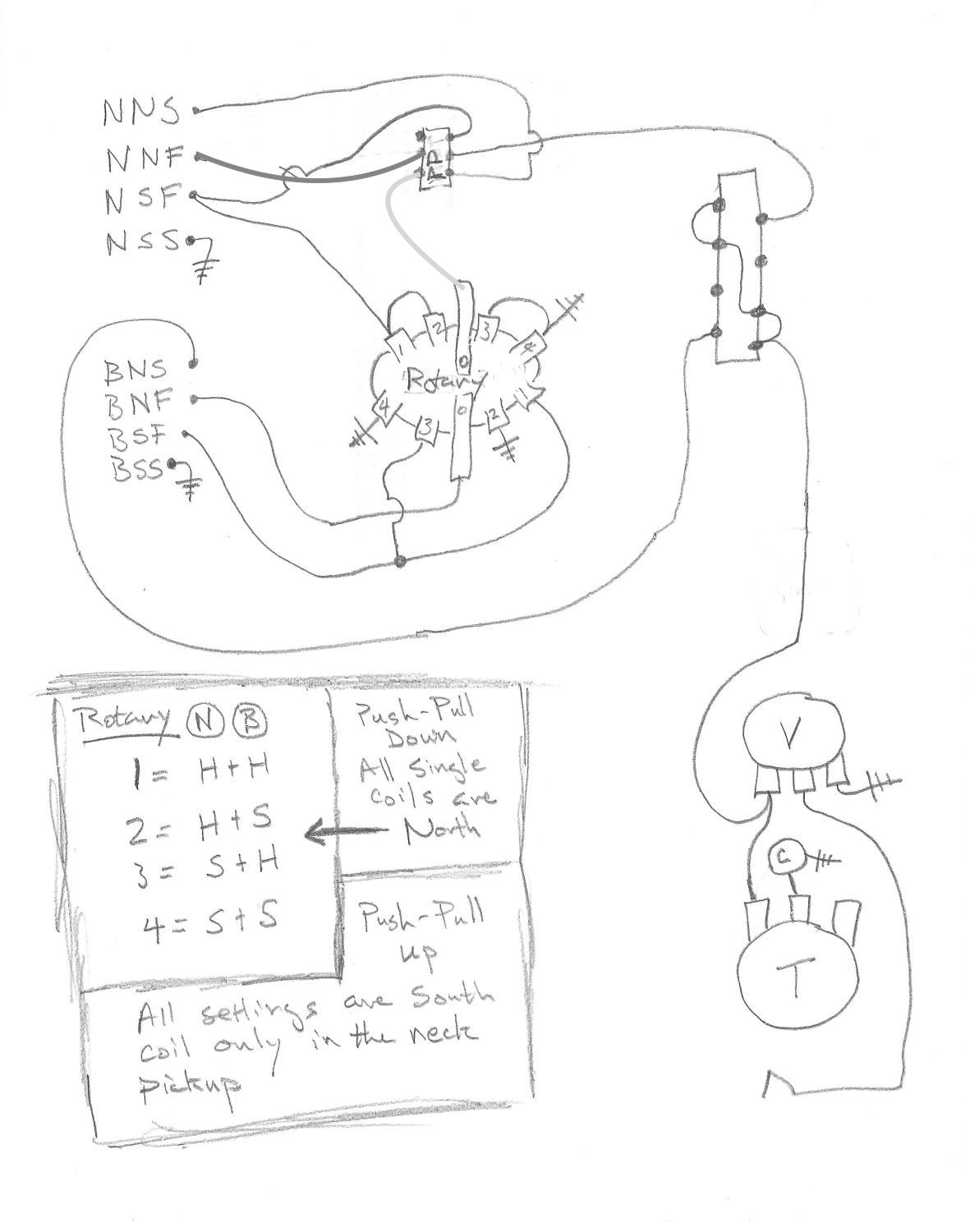

    BTW, I just realized the cap is wired wrong. It should be one leg to the center tone pot lug. The other leg to ground.
    3,100
    Oops. Meant to bump this thread...
    3,100

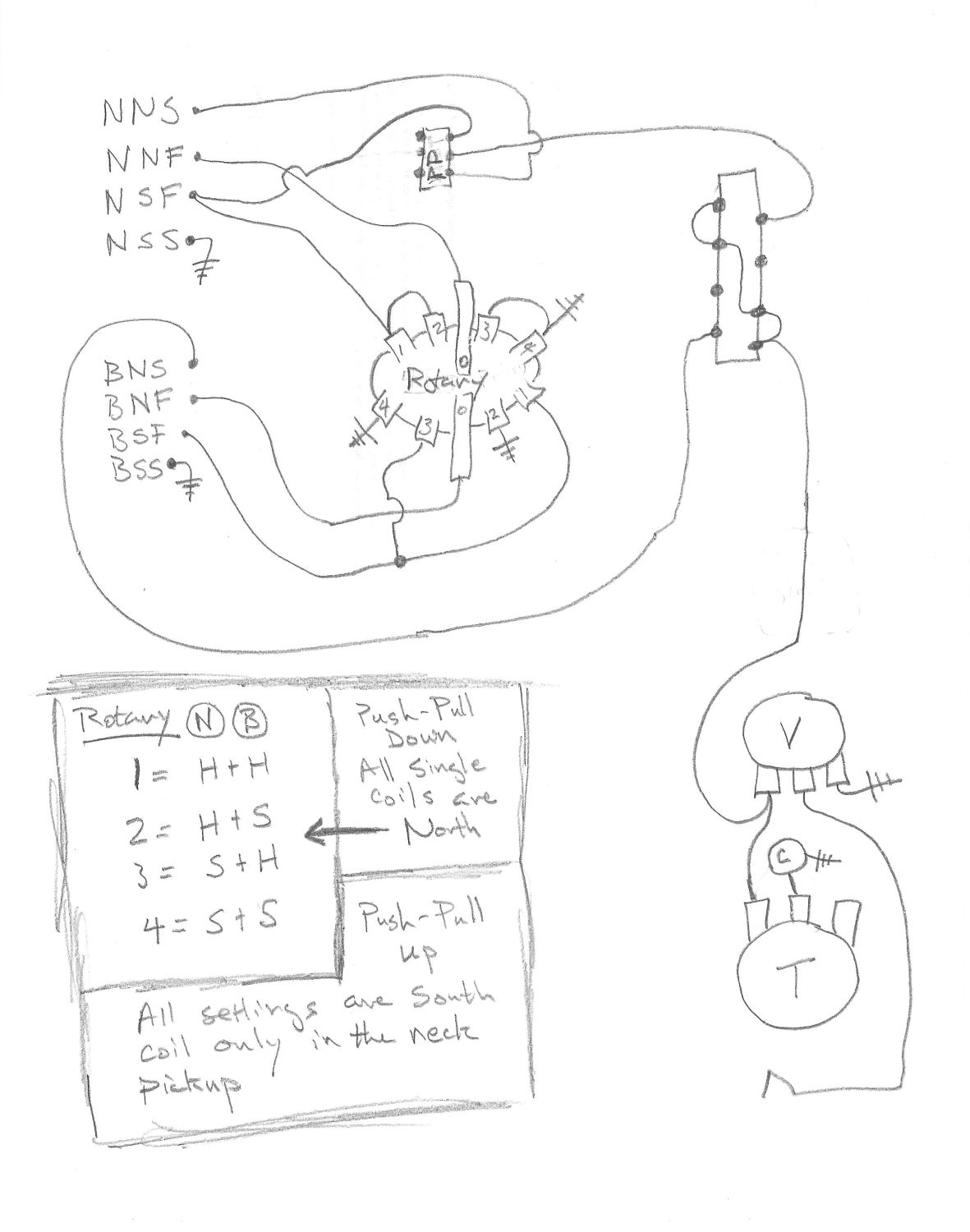

    Corrected the cap... would be grateful to have someone take a look to see if this will work. I suppose that there is no rush. I started this project in about 1986...

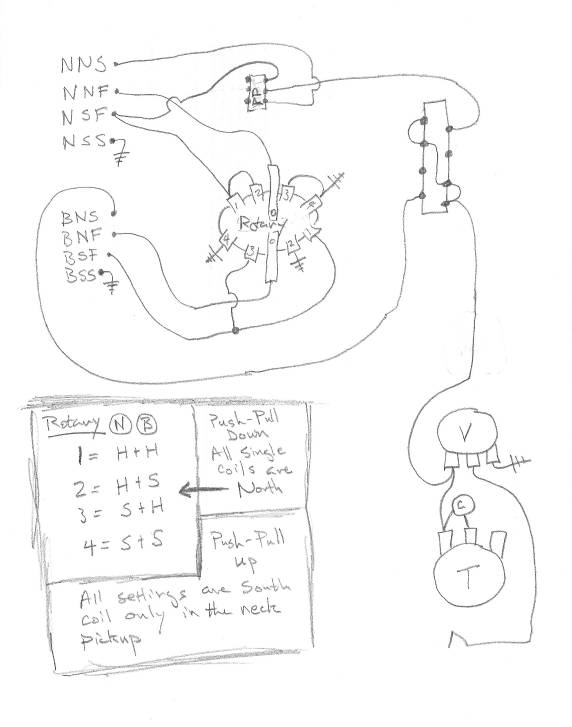

    Yep, that should do what you want. To help reduce possible noise when the neck is in south-single mode, you may want to switch the Neck North Finish link to the rotary via the push/pull too so that the north coil is not 'hanging' when the push/pull is up.
  6. Liked by: fender3x
    3,100
    Thank you! That makes perfect sense, and I am sure I would never have thought of it.
