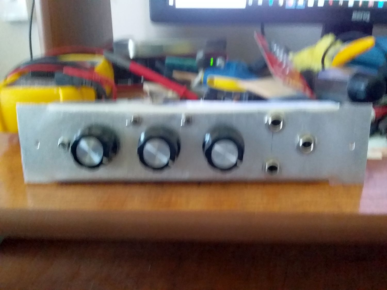

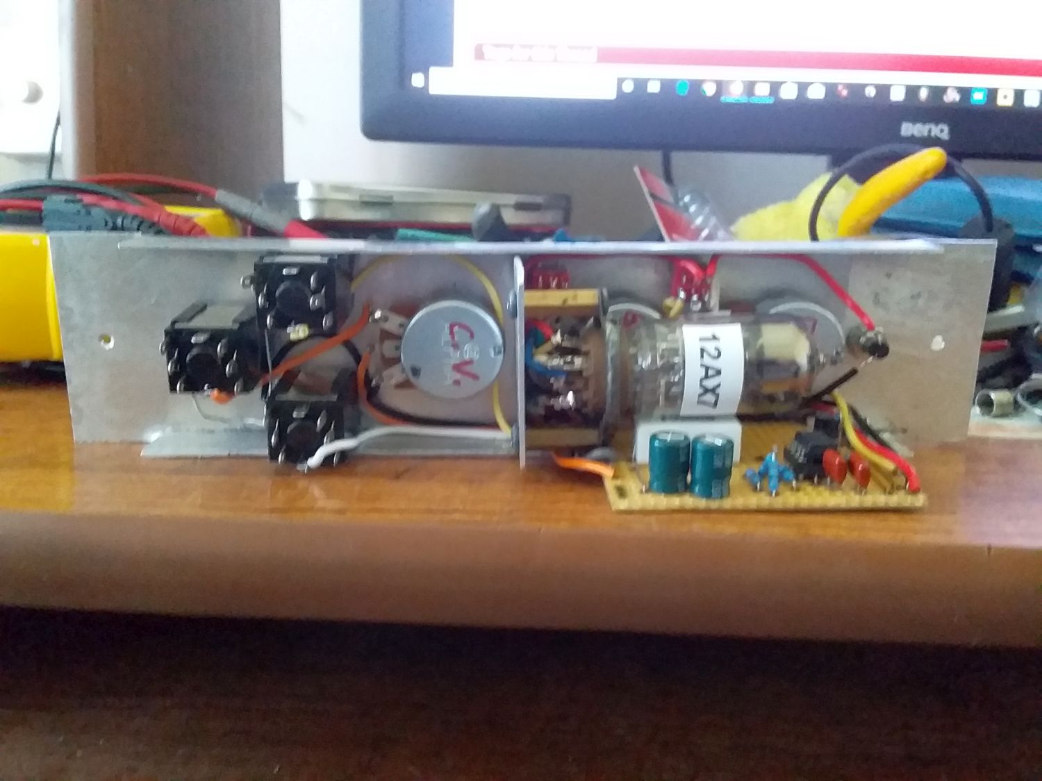

    Update:
    Just thought I'd do a quick update, anyway, I managed to finish making the first module that's going in my modular synth, it's a VCA (Voltage Controlled Amplifier) module with a twist, it uses a 12AX7 tube as part of the circuitry, here is a couple of pics of the finished Tube VCA module, note that I haven't tested it to see if it works.....yet:
Name:	Tube VCA 1_resized.jpg
Name:	Tube VCA 2_resized.jpg
    5,516
    So, "What's a Voltage Controlled Amplifier?" I hear you say, it's a specially designed type of amplifier in which the gain, or amplification it produces is controlled by a DC voltage applied to it's C.V. (Control Voltage) input, the higher the voltage, the higher the amplification, a Voltage Controlled Amplifier, or VCA, is typically used to control the dynamics, or loudness, of a signal in a Modular Analog Synthesizer, and to give the signal Attack, Decay, Sustain, and Release characteristics.
