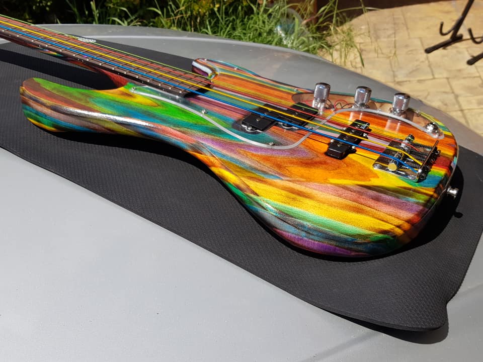

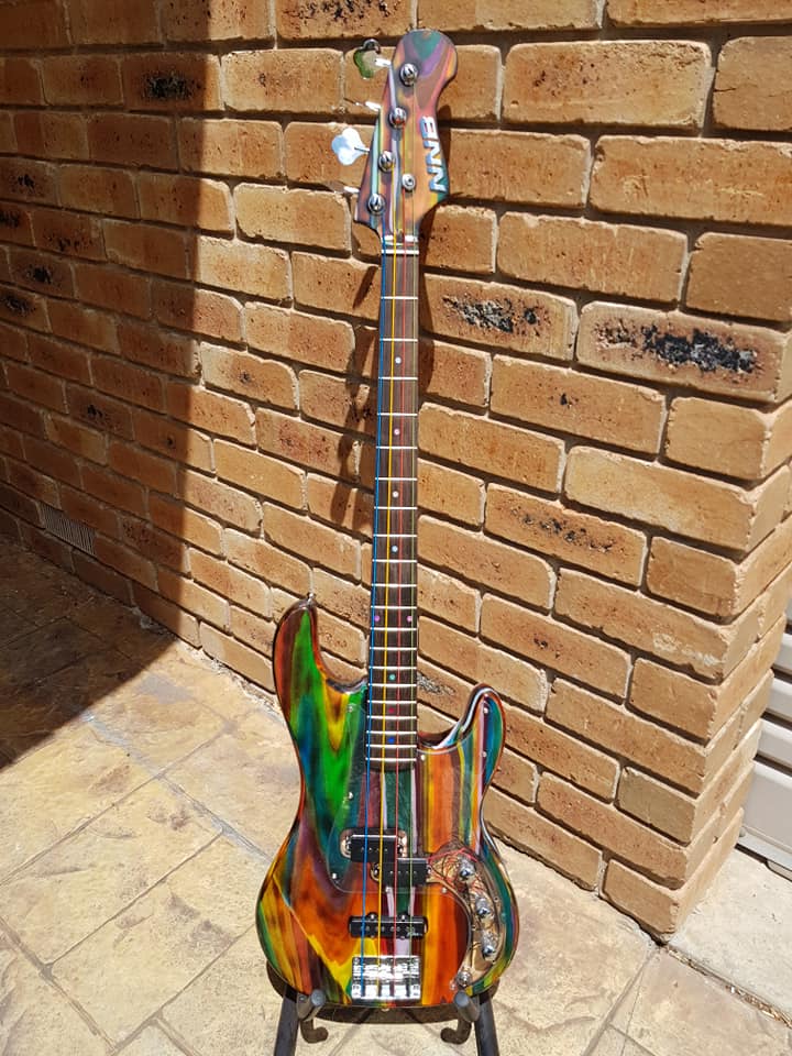

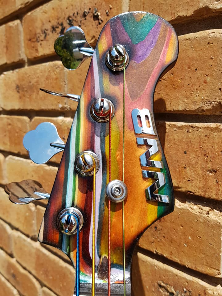

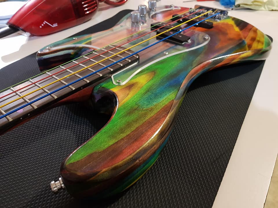

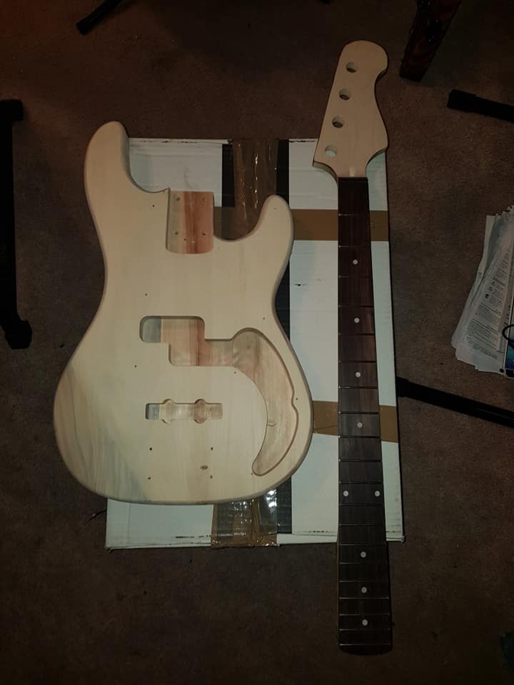

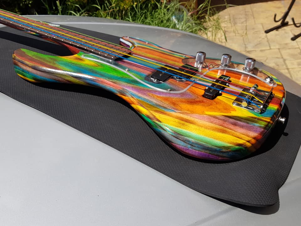

    Multi-Colored P Bass finally completed. Took time, but it was worth it in the end result. Shou Sugi Banned, then lightly sanded with 1200, then stained with art ink on cotton buds, then Scandinavian Oiled twice, then a light coat of poly ultra gloss to seal the color. Switched the pick ups to Squire P in the neck and BC Rich Jazz in the bridge. Swapped the pots to 500K and cap to .068. Plays and sounds great with a punchy low end with a trebley after tone. A lot of clarity and versatility with the pick up and tone combination. If you are interested, please check out and like my business page...https://www.facebook.com/NNBNoNaimBrand

    That looks really cool.
    Your basses make me happy. You’ve gotten really good at this technique.
    Dude that looks amazing!
