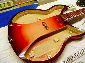

    From what i've seen online the pickup routes on ricks are tiny because they just sit on top of the body. if you have the kit you might be able to measure the cavities and compare it to the pup measurements to see if they would fit. Click image for larger version.

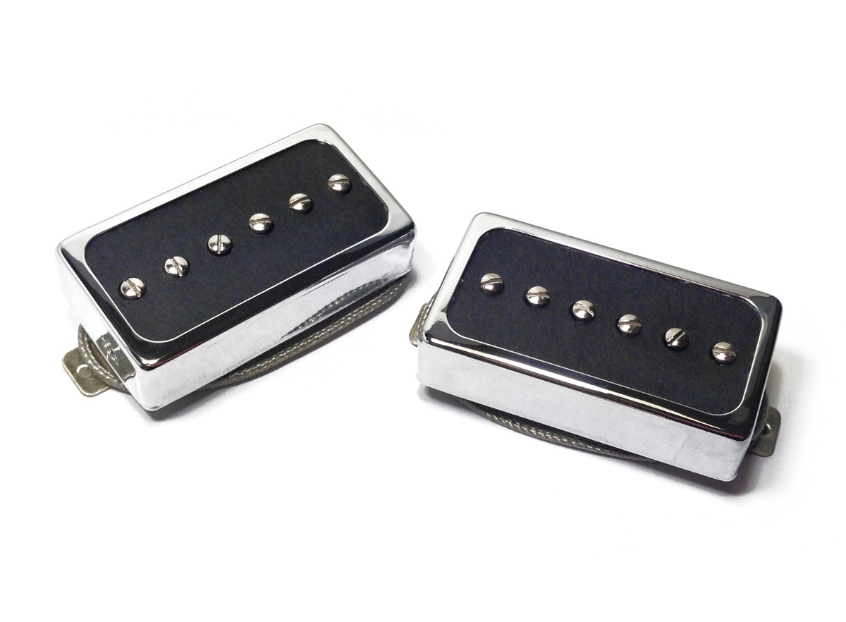

    Tend to think the PBG Ric kits come with standard Humbucker routing. A while back I had a serious look at doing RC1 and was leaning towards using Humbucker sized P90's with these ones looking more the part compared to Toneriders.... https://www.realparts.com.au/pickups...et-chrome.html

    The RC-1 is routed for 'mini' humbuckers (see pic), though the body rout fpr each one doesn't look to be much narrower than a standard humbucker rout at all.
    Dickybee007 used Allparts vintage single coil pickups with a chrome ring surround for his RC-1.
    http://www.buildyourownguitar.com.au...l=1#post100579
    If you want to fit real Ricky pickups, then you're probably better off either getting a custom order and routing the cavities yourself, or filling in the cavities on a standard kit and finishing off in a solid colour, e.g. Jetglow black, to hide the filling.
