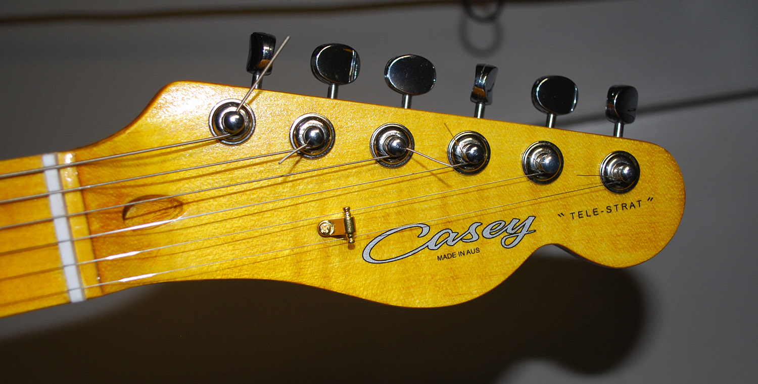

    I've been using Feast & Watson 'Golden Teak' Prooftint. It comes in a 50ml. bottle.
    First coat is more of a yellow but application of more brings more orange into the colour.
Name:	76 headstock.JPG
    cheers, Mark.
