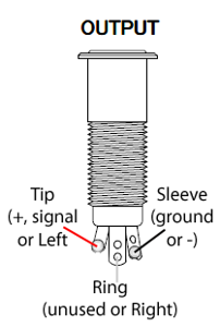

    If I’m remembering correctly, this kit has the long 3-lug barrel type jack(?). The two short lugs should be your ground and ‘hot’ (it’s non-standard), so check you’re connecting to those lugs... and, looking at the jack with the long lug at the back and the shorter ones at the front the left is the ‘hot’ and right is the ground (added image):
    If you can’t find the issue please post some photos of your wiring, it usually helps to track down the problem.
