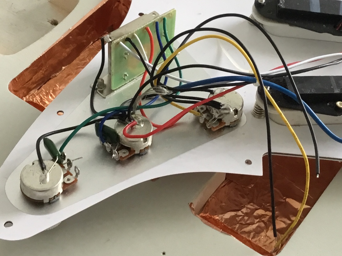

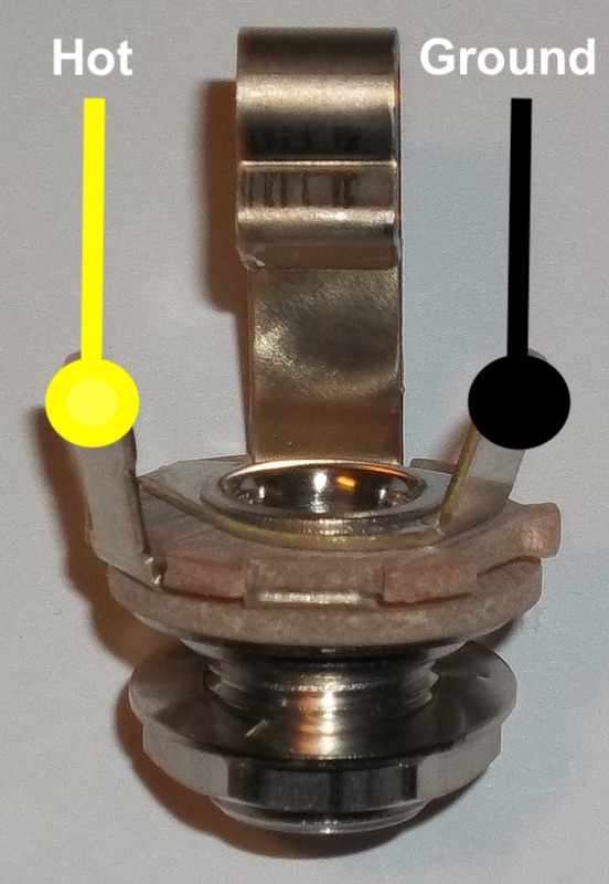

    Could anyone help with wiring please? I watched a video on wiring the st1 but it seemed quite old, i think the wire colours have changed since then. From what i gather from the wiring diagram, I need to attach the yellow wire to the hot tip on the output jack, this leaves me with two black wires that i dont know what to do with.
    The pre-wired scratch plate should mean that all you need to do is connect a wire (colour variable) from the volume pot’s middle lug to the ‘hot’ tip lug of the jack. And, connect a ground wire from the back of the tone pot through the hole in the trem cavity to the trem claw plate (the ‘bridge’ ground connection) and another wire from the back of the same tone pot to the ground lug of the jack.
    If you’re still uncertain post some photos of your kit’s wiring and we can maybe annotate them etc. as wire colours do change with different batches.
    Thanks for the reply Scott. The yellow wire is the one coming from the middle of the volume pot. But the two black wires also appear to be from the top of the volume pot, i also dont know what you mean by the trem cavity and claw plate.
