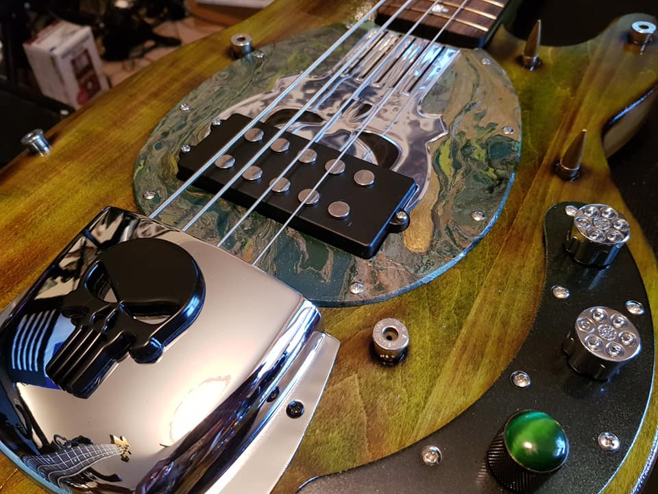

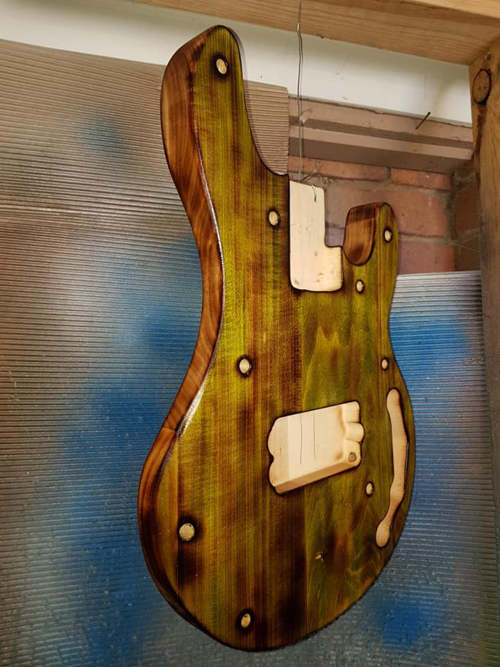

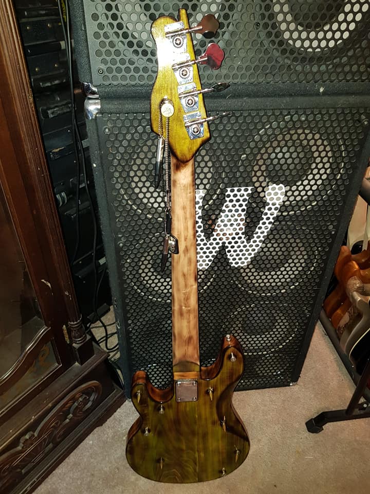

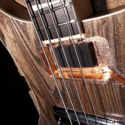

    One of my fave Bass builds to date...A Shou Sugi Ban, olive stained MM5(4) String Punisher Bass with actual 303 Winchester's thru the body and a .50 Browning thru the headstock.

    Almost like a mini bed of nails with those 303's poking through the back! Punisher is an appropriate name as I reckon anyone who attempts to play it will surely be punished.

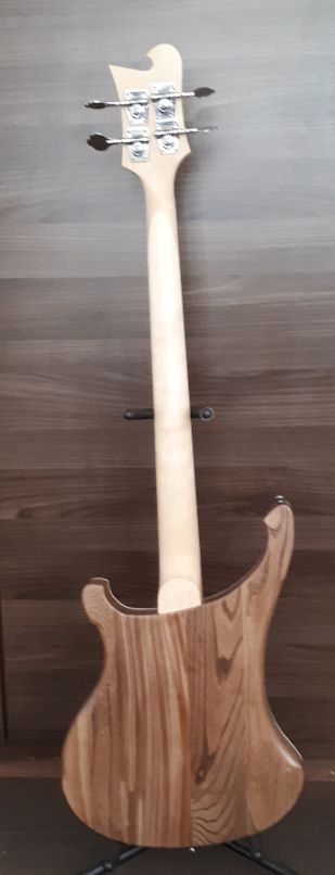

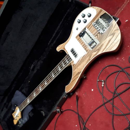

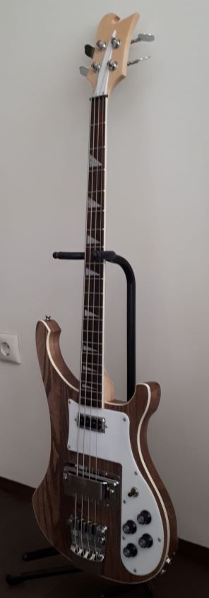

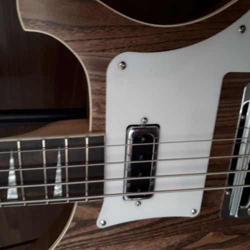

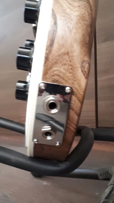

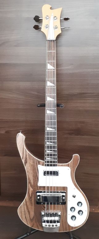

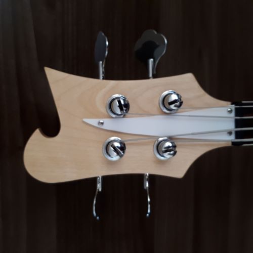

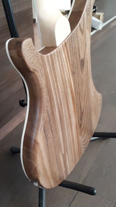

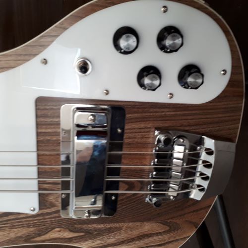

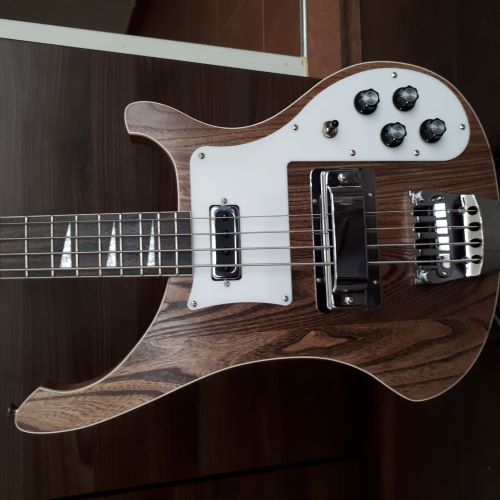

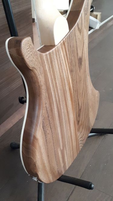

    Hello
    First of all I would like to give my special thanks to Pitbull guitars for the opportunity to
    work on two projects of RCA kit !
    Please find below some pictures and a specification of my second RCA project:
    *) Body - Ash ( Pitbull ) Oil wax satin finish
    *) Neck - maple + rosewood fingerboard - transparent semi gloss oil and wax ( fine satin finish )
    *) Pickups - Roswell ( both Neck and Bridge )
    *) Tail piece & bridge - All parts
    *) Tuners - Pitbull
    *) Pickguard and trust rod cover - redesigned by me. Made out of opal PMMA
    *) Toggle switch - Rickysounds
    *) Controls
    2 X volume pots - Alpha 250K
    1 x bass tone - Alpha 500 K
    1 x treble tone - CTS 500 K push/pull ( Changing Modern to Vintage sound )
    *) Nut - TUSK
    *) Output - Stereo + Mono
    *) LOGO - No logo by purpose !
    regarding the logo - my first project shown in Rocktober has got a comment that there is no any logo !
    Please kindly note that I feel unworthy to place any logo on such iconic model but if you wish to have a logo, then
    please consider it as "TOKO instrument")
    So far so dully Here comes the pictures:

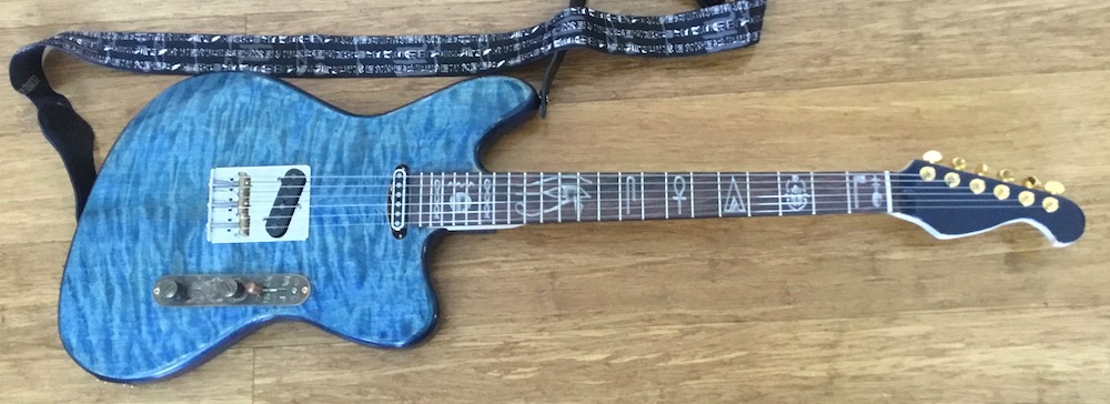

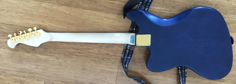

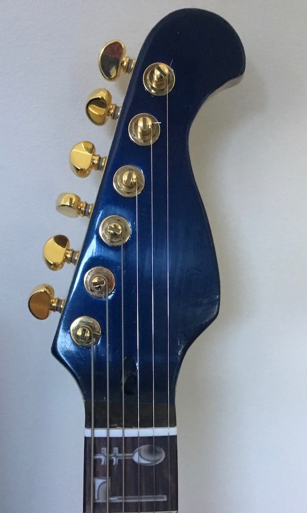

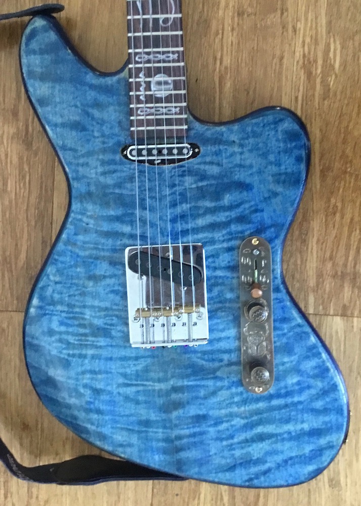

    Presenting .... the Sphinx
Name:	1 Front The Sphinx.jpg
Name:	2 Back The Sphinx.jpg
Name:	3 Body The Sphinx.jpg
Name:	4 Headstock.jpg
    Specifications:
    * A tele build into a Jazzmaster style body - Pitbull's JTL-1 with a quilt maple veneer
    * Gotoh InTune Bridge
    * Australian hand wound Sliders Nocaster bridge pickup
    * Q Pickups A3 in the neck
    * Grover locking tuners
    * Custom engraved control plate and neck decals
    * Hawks Head headstock
    * Dingotone Bondi Blue oil finish to front, Deep Blue finish to back and headstock, clear finish on neck back

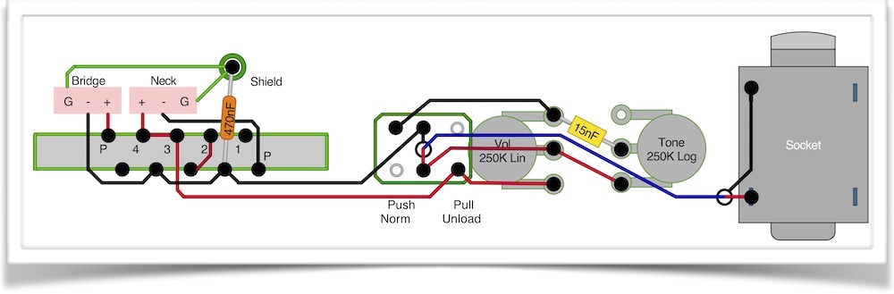

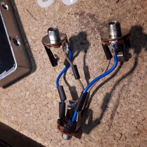

    The wiring scheme incorporates what I have though are the best elements of a tele build
Name:	7 Wiring.jpg
    * Lindy Frahlin wired 4 way selector (neck, neck/bridge parallel, neck/bridge series, bridge)
    * Fezz Parka tone circuit wiring using a 15nf orange drop tone cap (sort of like a treble bleed with greater tone travel)
    * Push/pull switch on volume to unload the pickups (wow! first time I've done this, it adds a whole new voice)
    * 630V DC safety cap separates hardware from cable negative
    What I love about this guitar is its tone and playability. The ash body gives nice warm sustain, and the Sliders hand wound pickup drips that early tele sound that no other guitar provides. Think Clarence Brown, Jimmy Wyble, the guys that inspired everyone from Clapton to Townshend to Richards to take up a tele.
