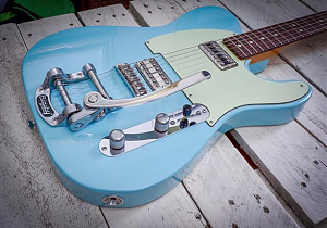

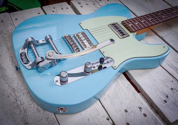

    take a look at other Tele's with bigsby's. Basically find and mark a centre line on the body ( put some tape down and mark the tape rather than the body) Measure and mark the centre of the bigsby and line it up. I found stringing it up with cotton string or fishing line allowed me to check that the strings ran straight to the bridge. As to how far back they usually go as far back as possible without hanging off.
