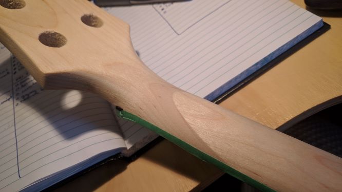

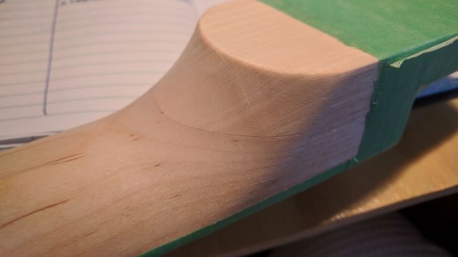

    Thank you Andy - the neck is made up of three pieces of wood (see attached pics) plus the tuning peg holes were very roughly cut.
    I was hoping to keep the neck natural, but visually the woodjoint is very obvious

    I think the joint at the headstock end is a scarf joint. Provides a lot of strength and I think more robust than one piece

    This is all completely normal.
    Many commercial guitars have this same scarf joint on the neck and extra piece on the heel. You can still finish it in clear, yes the joins will be visible, but that's just the way they are made. Not sure the scarf join add's strength, it's a bit of a known failure point on Gibson necks. I believe the main reason is to get a steeper string break angle past the nut.

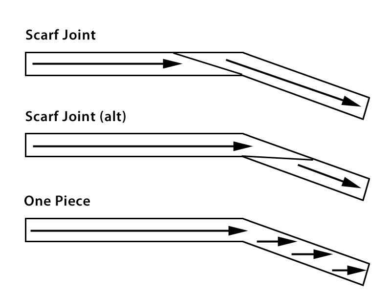

    The gibson method is to cut the neck from a single blank so that you end up with short cross grain through the headstock/neck transition.
    Scarf joints are much stronger than this as you've laid long grain structure in a much wider contact area. The long grain runs down the headstock perpendicular to the tuner shafts. see below:

    In all of the scarf jointed necks I've made, i use the top method as i feel its easier to achieve a strong joint this way, and its can be done from a 1' /25mm board, rather than a deeper block of wood.
    The G company uses the bottom method, which gives you that short grain weakness, then they cut a TRC adjuster cavity into that already weaker section. That is the genesis of G's reputation for headstock breakage according to everything i've read.
