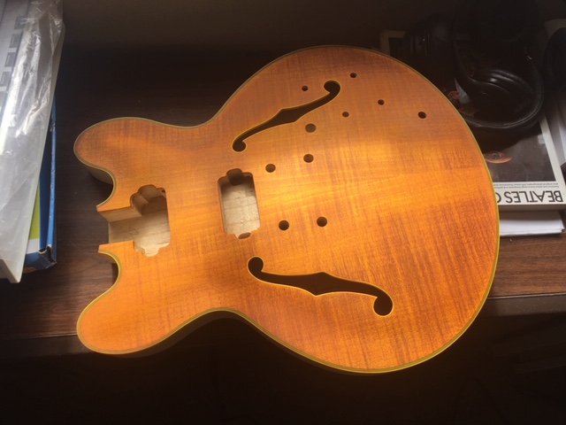

    I tidied up our back room last weekend and looked in the box and decided it was time to start. I had previously sanded the body and so gave it another run over and had a close look at everything to re-acquaint myself with the kit.
    My previous experiments didn't really produce the colour results I had in mind. I have since watched a lot of finish applications on YouTube so figured I would give it a go.
    I started with a diluted black stain to highlight the grain. Once dry, I sanded well. I then applied a coat of Vintage Amber Colortone, sanded and re-applied. Did this three times. Then I gave the whole top a couple of coats of lemon yellow, sanding in between each time. Then I applied the Cherry Red to the outer edges, blending as I went with the Lemon Yellow to remove the defined edge. More sanding in between coats and re-applying till I was happy with how it looked. Hopefully I will be happy once the clear goes on...time will tell.

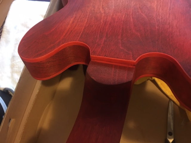

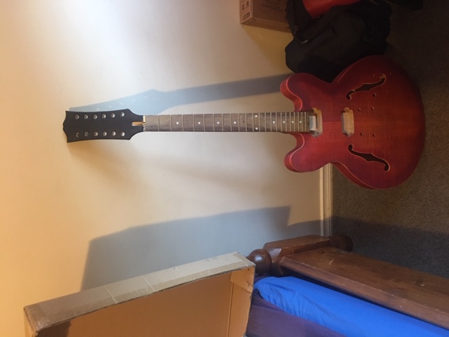

    I have checked scale lengths on the neck and also center line alignment. I was happy with these and so now the neck and body are one. I will do the frets and neck setup once finished and assembled.

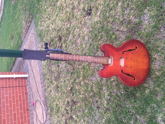

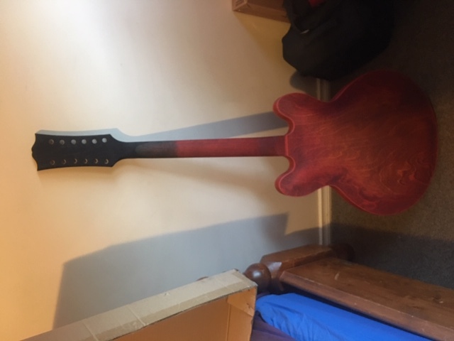

    I started staining the back and neck tonight and will post a couple picks when I am happy with the colour. Here are a couple pics of the progress so far. Neck to body fit was pretty good. I transitioned it with a very small amount of filler. It will be Cherry Red at the join so lack of grain because of the filler should not be obvious.

    Colour is looking good!
    #002 (WL-1)
    #005 (LP jr)
    #006 (TL-1A)
    'The TGS Special'
    Interesting how the grain texture looks more vertical directly below bridge and tail stop positions through to end pin location.
    Thats some nice grain and some wonderful colour coming through Roly.

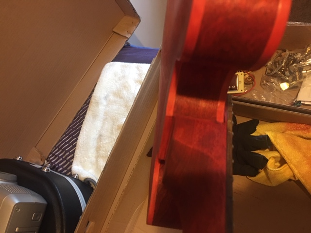

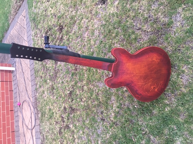

    A couple of pics from the first lot of stain applications last night. It dries pretty quickly so I got a couple of layers on. I will sand it and continue tonight. I am unsure whether or not to add black to the outside edges yet.

    Looking good.
    Member ILRGuitars's Avatar
    385

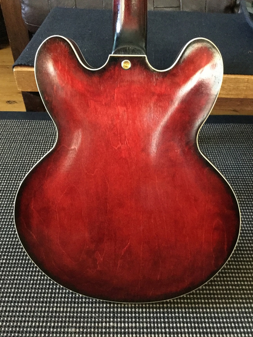

    I reckon adding the black would set off the black on the neck and headstock nicely. Just don't add too much.
    A thin line would be all you need. Here's the back of mine:

    From: Non Pitbull ES330 Tribute.
    Looks good ILRGuitars but I think I am not going with the black.

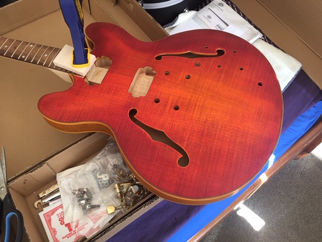

    This is getting pretty close I think. Tried to catch the last of the natural light.

    I am considering some MOP inlays for the neck and headstock. While applying the stain the nut dislodged. Is MOP suitable for a nut or should I stick with bone?
    Cheers
    385
    Bone for tone!
