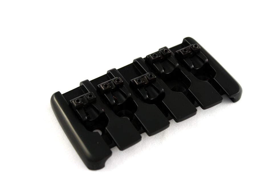

    Modern style quick release 5-string bass bridge. Modern locking saddle design.
    66mm centre to centre overall string spacing. (16.5mm individual)
    Black finish. Includes screws.
    https://www.realparts.com.au/bridges...dge-black.html

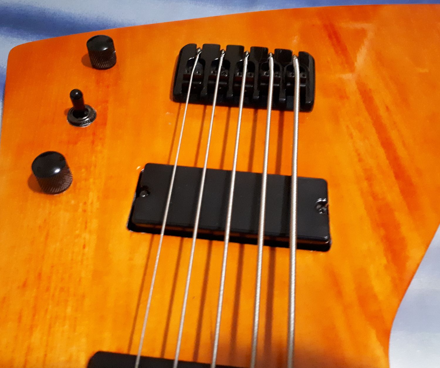

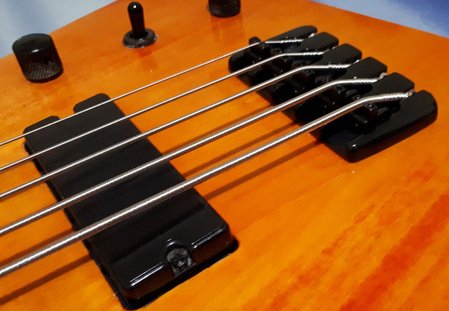

ID:	28703Click image for larger version.
ID:	28704Click image for larger version.
Name:	Bridge rear close up.jpg

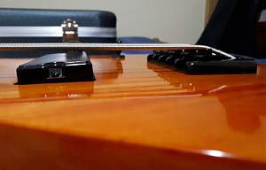

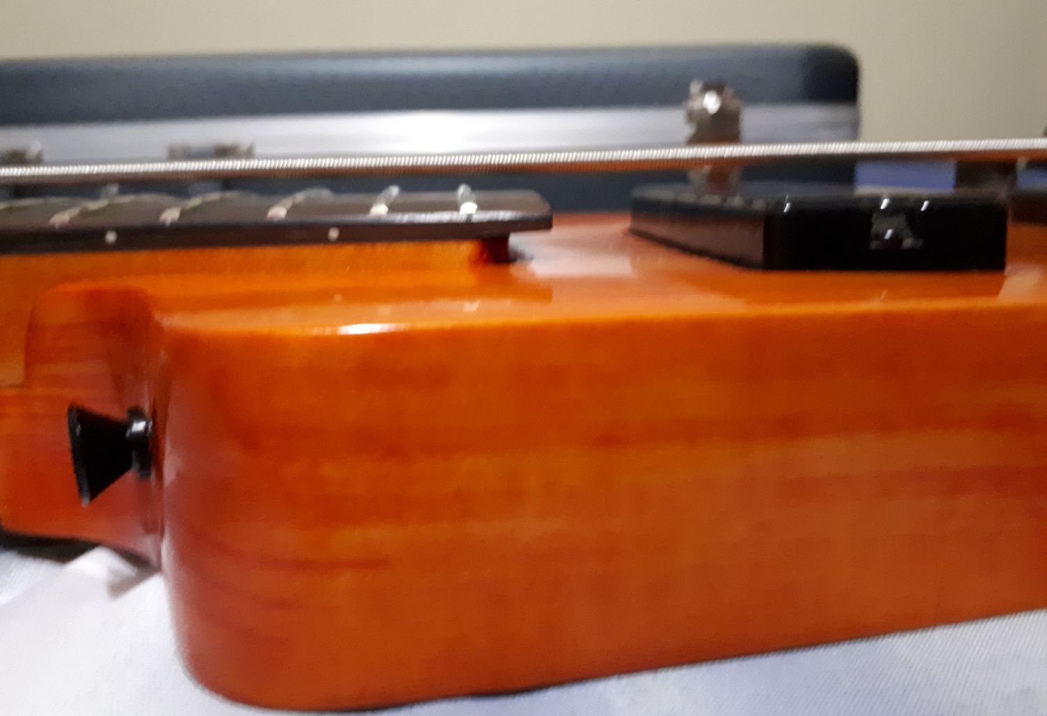

    This fiver has a huge amount of tension on the neck and even with truss rod fully wound up tight there is still a very slight forward bow up near the nut end. Main reason for swapping bridges was to achieve a lower action however this thing was buzzing all over the place on most strings and ended up with an action that is still a bit on the high side, maybe not quite as high as before, possibly 1 mm lower??? Not sure but this bridge is a better design with how strings are loaded and if you like to palm mute, as the old guitarist in me does, this bridge is much better for that too.
Name:	Bridge Action 2.jpg
ID:	28706Click image for larger version.
Name:	Bridge Action 3 at neck.jpg

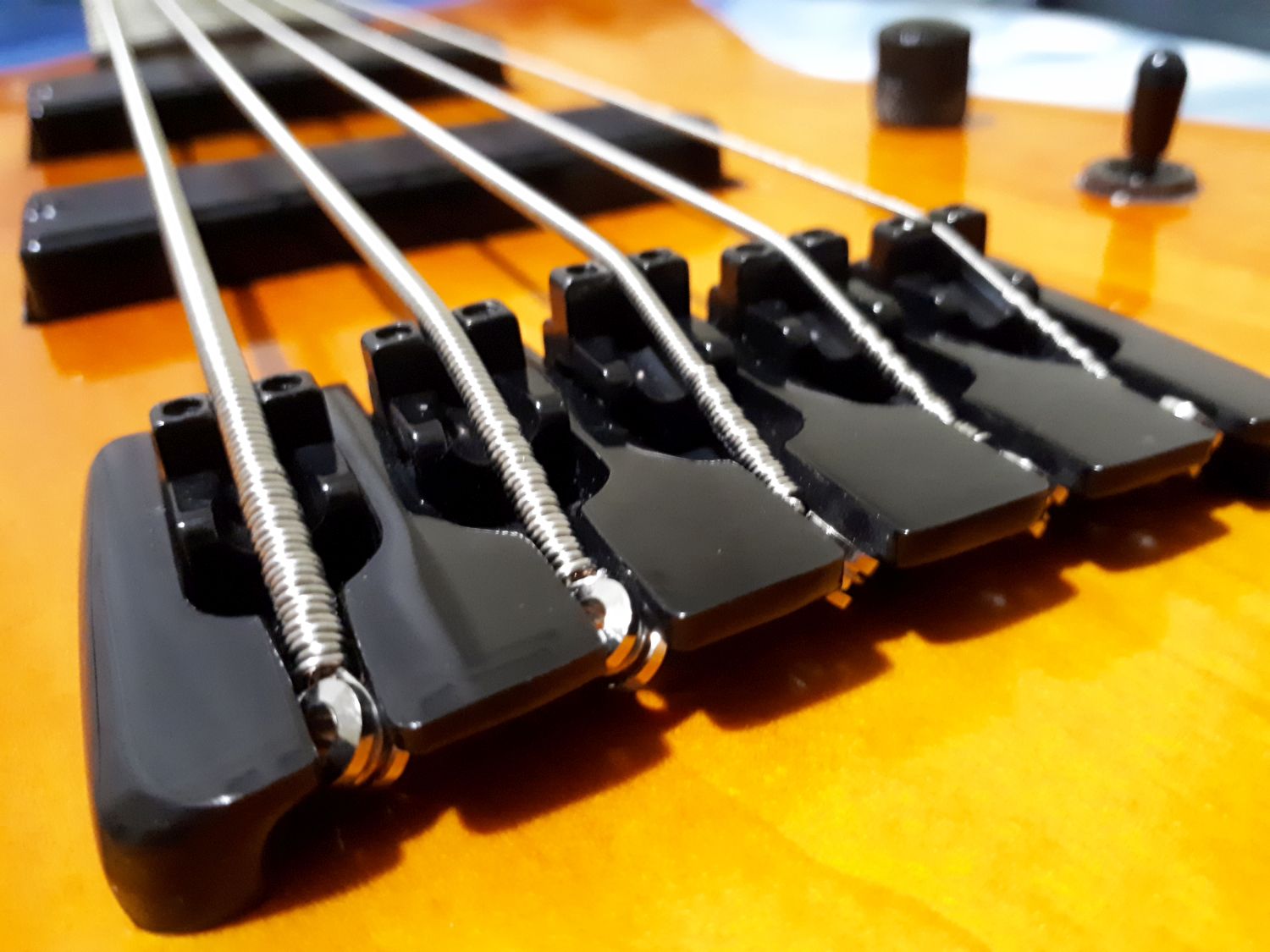

    Took a bit longer than usual with intonation as first I had to get height to stop fret buzzing, then adjust length to obtain correct pitch, then tighten the allen key grub screws to hold everything in place. Not so easy when strings are also in the way of where you need to turn an allen key wrench.
    Overall I am impressed with this better designed bridge and would recommend to anyone considering an upgrade..
