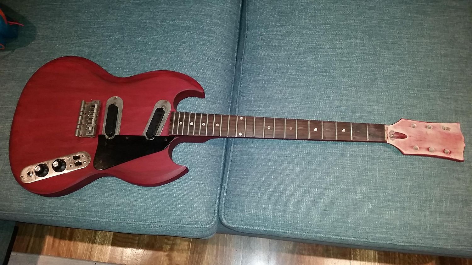

    This weekend I picked up my mates Gibson SGII that had been drowned in the floods a few years back to finish off the restoration for him, all of the bits are there so it's only a matter of a refin and rewire to get it humming again.
    The serial suggests it was build 70-72 or 74-76 in Kalamazoo, but he was playing it in 1972 so it has to be the earlier build window.
    The pickups are the much unloved Gibson single coils so we'll see how it sounds when finished, the only non original bits are GOTOH tuners that are identical to the broken Gibson original that he couldn't get genuine branded replacements for.
    The originals are marked Gibson Delux on the gear covers and this is the only detour

    Time to start thinking about the finish.
    Wes has used Wattyl Mulberry wood gel interior stain which is about the right colour but it's a bit patchy so a rub back will be required, I'll see if I can find a bit of similar coloured mahogany at the local joinery to test some finish options on.
    I'm thinking Tru Oil over the stain is going to be the go but open to suggestions

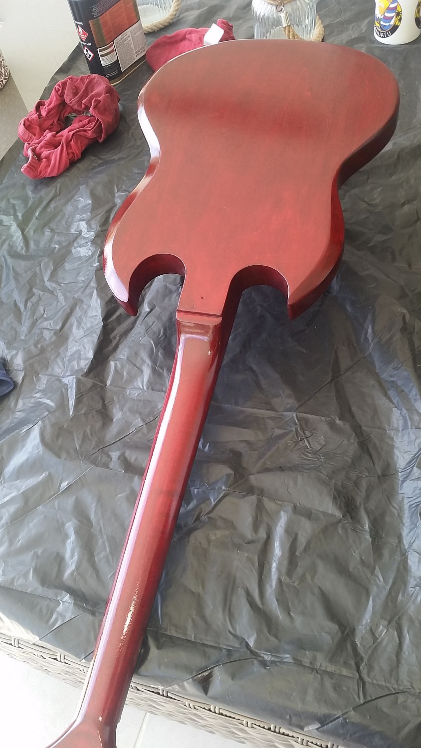

    After moving house and what seems like a lifetime of inaction and fighting with the stain I have finally reached the stage where I have one more coat of Feast Watson wipe on poly to go and then I'll let it sit for a week prior to cutting, buffing and rewiring.
    Much to my surprise it has come out an almost identical cherry red to the Gibson original colour, except for a couple of lighter spots on the front of the headstock ( naturally ), definitely not a glue issue the stain simply wouldn't darken right up.
    Given that the SG 100 & 200 came with either body colour or black headstock I suggested to the owner that we should go black but he was adamant that it had to be the same cherry colour so it is what it is.
    Watch this space
