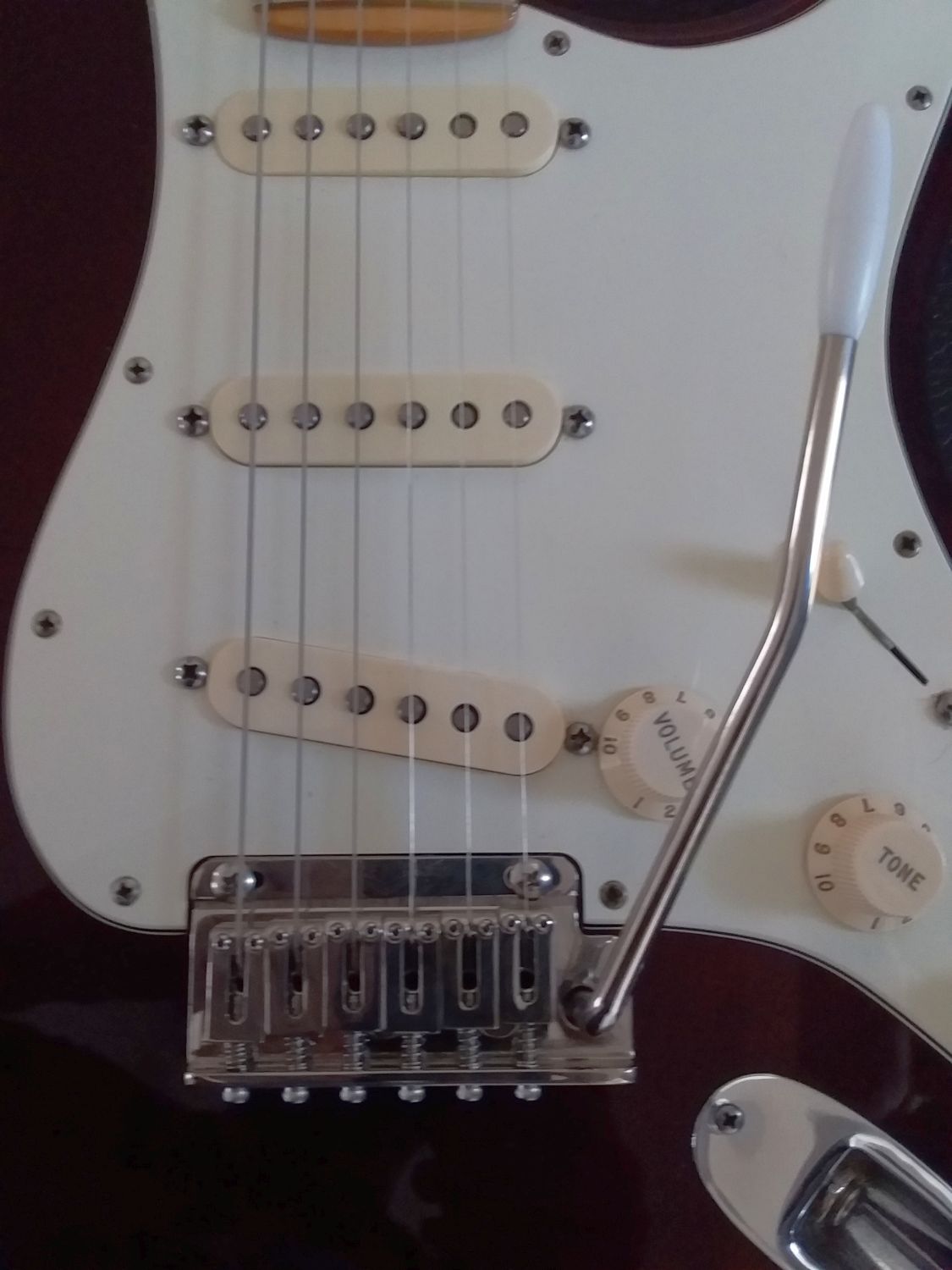

    Okay, here's a pic of the new Bladerunner Bridge installed on my Fender USA Strat, I ordered an extra longer trem arm with a plastic tip on it, which you can see:
Name:	Bladerunner Bridge_resized.jpg

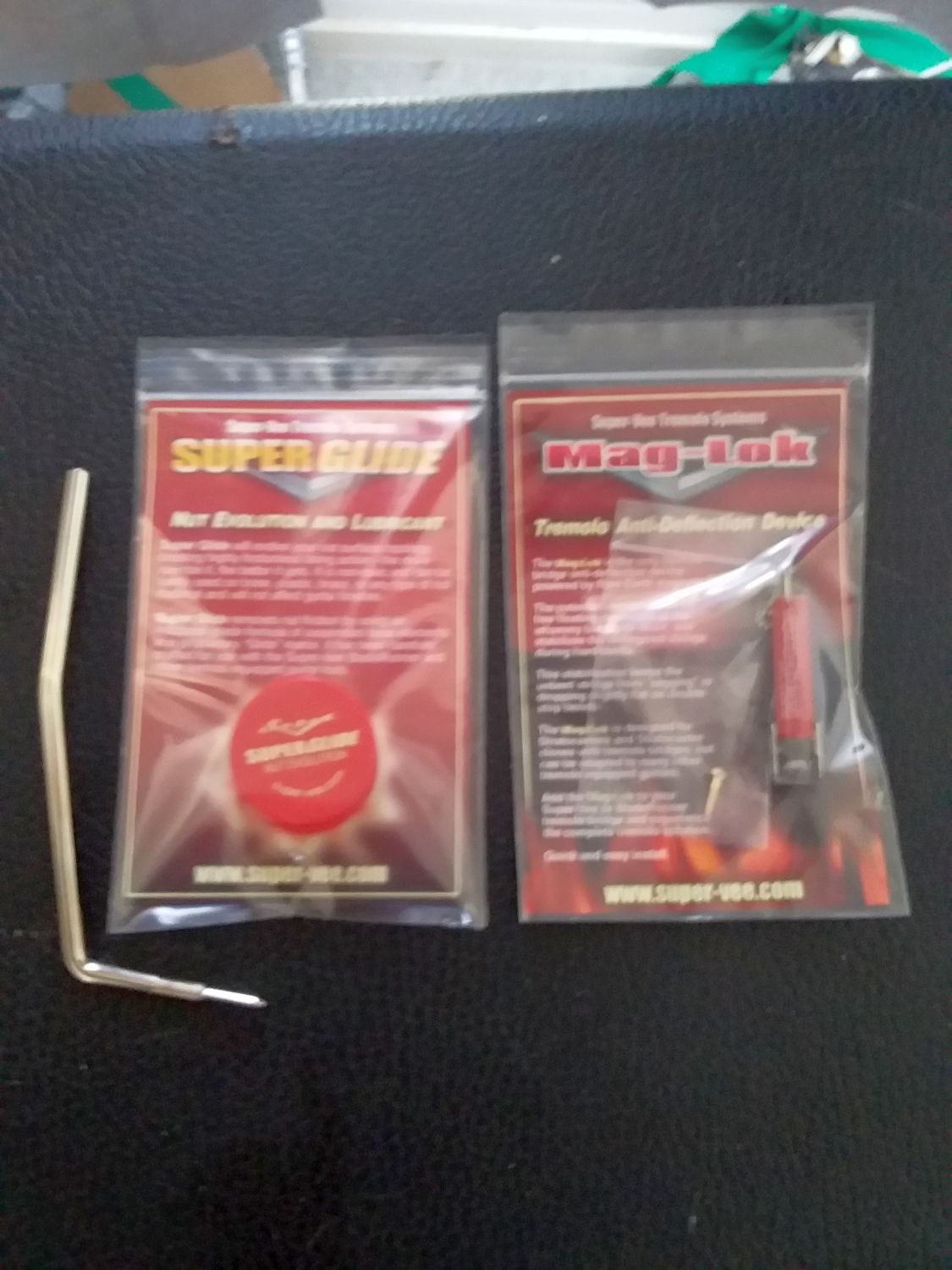

    Here's a pic of the Mag Lock and Super Glide, note the trem arm that comes stock with the Bladerunner Bridge is next to them:
Name:	Mag Lock And Super Glide_resized.jpg

    Rightio,
    The installation of the new Super Vee Bladerunner Bridge was actually pretty easy, no more difficult than to install/un-install the original stock bridge, since the new Super Vee Bladerunner Bridge is virtually a drop-in fit, practically no modifications whatsoever were needed to be made to the guitar, all I had to do was remove the back cover for the trem springs, remove the stock springs, remove the stock bridge and the two pivot posts, then insert two brass adaptors in the threaded pivot post sockets, the two brass adaptors allow the bridge to be fixed to the guitar body via two screws, then it was just a case of installing the three new springs supplied with the Bladerunner Bridge kit, there's also a new spring-claw supplied in the kit but I chose to use the stock one as it was still perfectly good.
    So, what's different about the Super Vee Bladerunner Bridge compared to the original stock one, well there's a couple of things different, firstly the bridge attaches directly to the guitar body via two screws, secondly the bridge pivots via a thin piece of spring-steel rather than two knife edges, the advantage with that is that the spring steel completely eliminates any tuning issues due to friction caused by worn knife edges, and since spring steel is immune from wearing out, the whole system should stay working properly for a very long time, and should always come back to it's neutral position.
    I did notice that the new Super Vee Bladerunner Bridge felt a bit more spongier than the stock bridge, you don't need to move the trem arm on the Bladerunner Bridge to get a lot out of it, it also came from the factory with the intonation settings roughed-in, it only needed some minor tweaks to get everything dialled-in.
    Incidentally, SuperVee.com also sell a version of the Bladerunner Bridge that mounts on a guitar body via four wood screws, these are a drop-in fit for the stock bridges found on made in Mexico Fender Strats that use vintage style bridges with six wood screws, you may need to order an extra shorter sustain block while you're at it.
    Personally, I'm happy with the new Super Vee Bladerunner Bridge I ordered, it has made my Fender USA Strat a much nicer guitar to play, and, if my ears aren't deceiving me, it has improved the tone a bit too.

    Okay, so what on earth is it, and what is it for?....the Super Vee Mag Lock is an anti-deflection device that stops the bridge from moving forward under string-tension when you play double-stops, sort of like a device called a Tremsetter, but the Mag Lock is SuperVee's take on the basic idea, it uses a couple of strong rare-earth magnets and a felt pad to stabilize the bridge when doing string-bends or double-stops.
    And finally there's the Super Vee Superglide nut-slot lubricant, have you ever noticed how sometimes when you're tuning the strings on your guitar, there's a slight "Tink" sound, or that the string seems difficult to tune up to pitch?, well 99% of the time I've found that's caused by the string binding in the nut-slot due to friction, the Super Vee Superglide lubricant is designed to reduce the friction due to binding, all you need to do is put some in each of the nut slots, it pretty much does what graphite from a pencil does.
