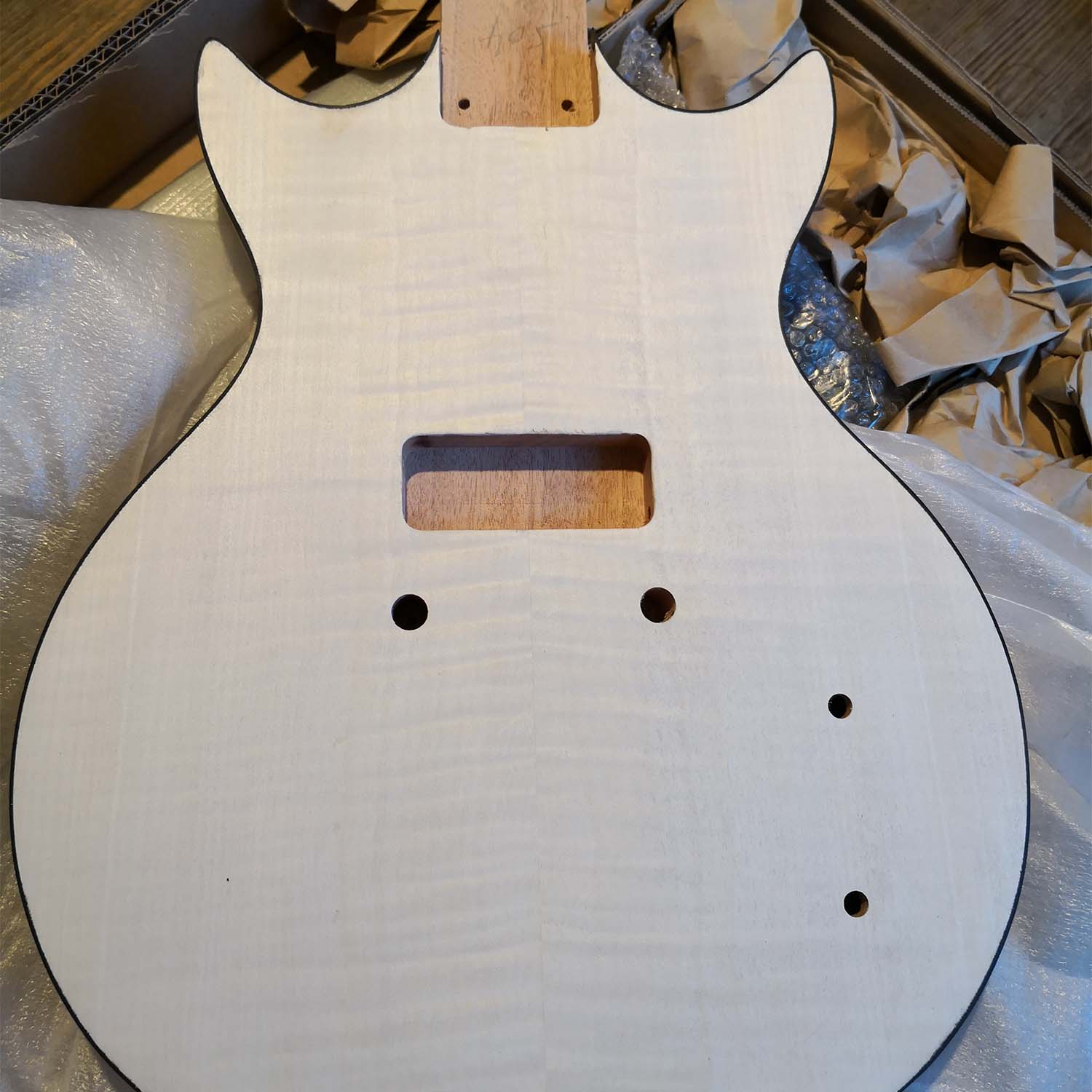

    First thing to note – the top veneer is really nicely matched, so that's one decision made for me. I'll be using a natural finish, no stains.

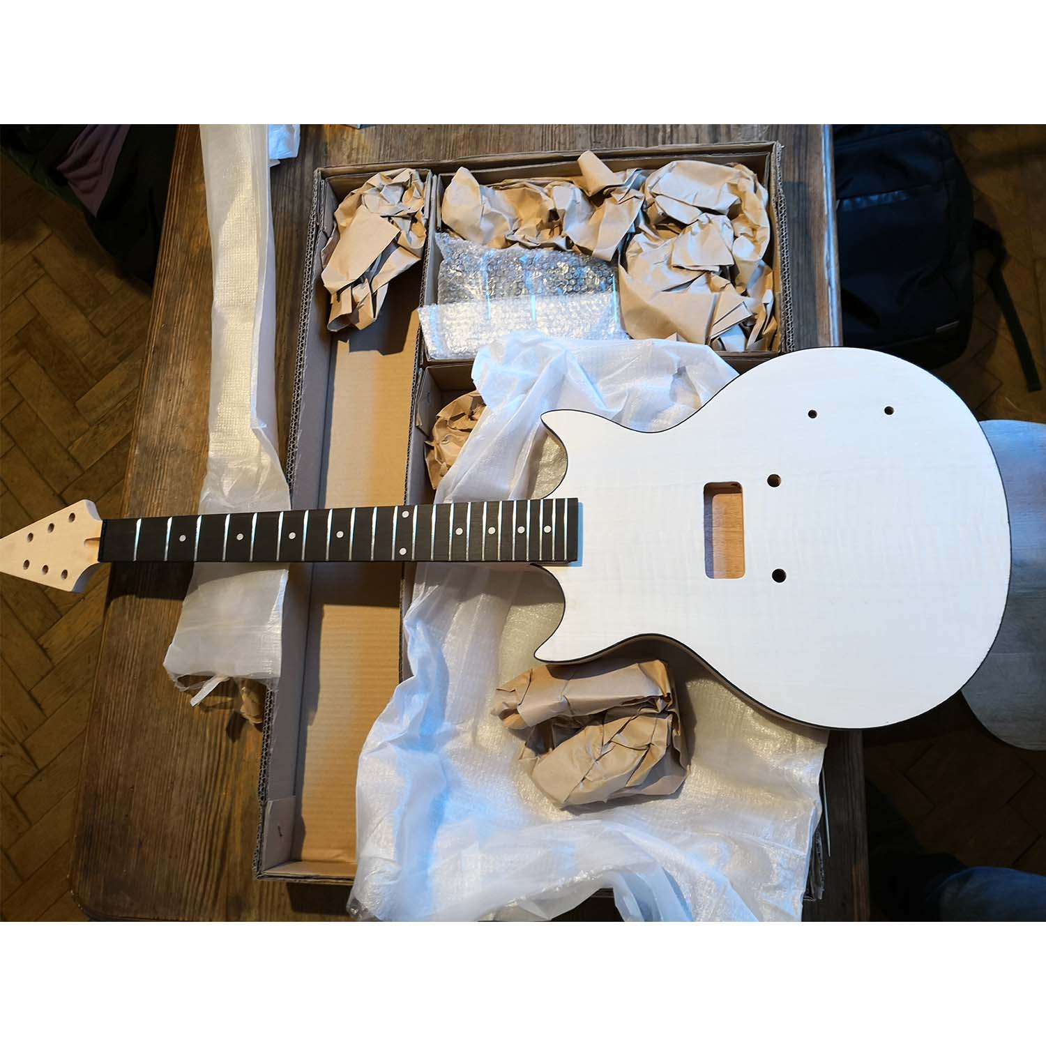

    The neck fits into its pocket with a very slight intereference.

    Nice looking kit. That veneer will come up a treat.

    Have to agree that is a nice looking veneered top plus neck also looks good too.
