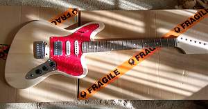

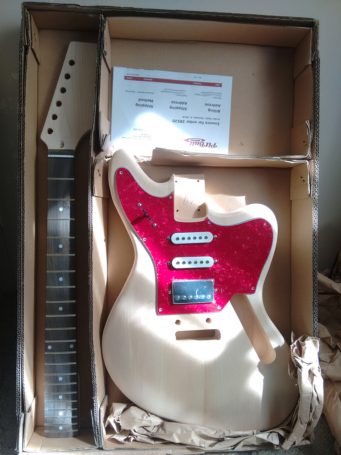

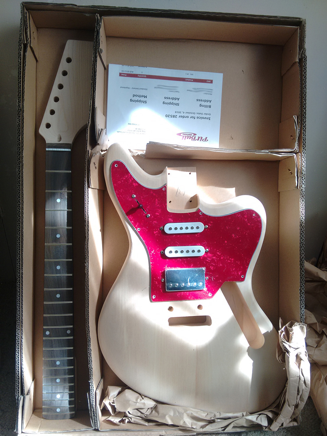

    It looks like a JM-1
Name:	03 mock up one.jpg

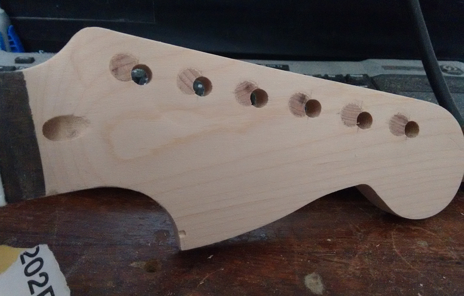

    Neck has some interesting blemishes that will form it's character.
    cheers, Mark.

    Looking forward to seeing how this one goes.
    Me too, mine is one of my favourite guitars. Is that a basswood body? Should help a bit with weight, mines pretty heavy.
    So natural or solid finish?
    Cheers, Colin.

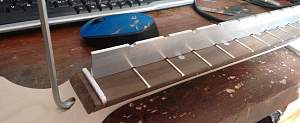

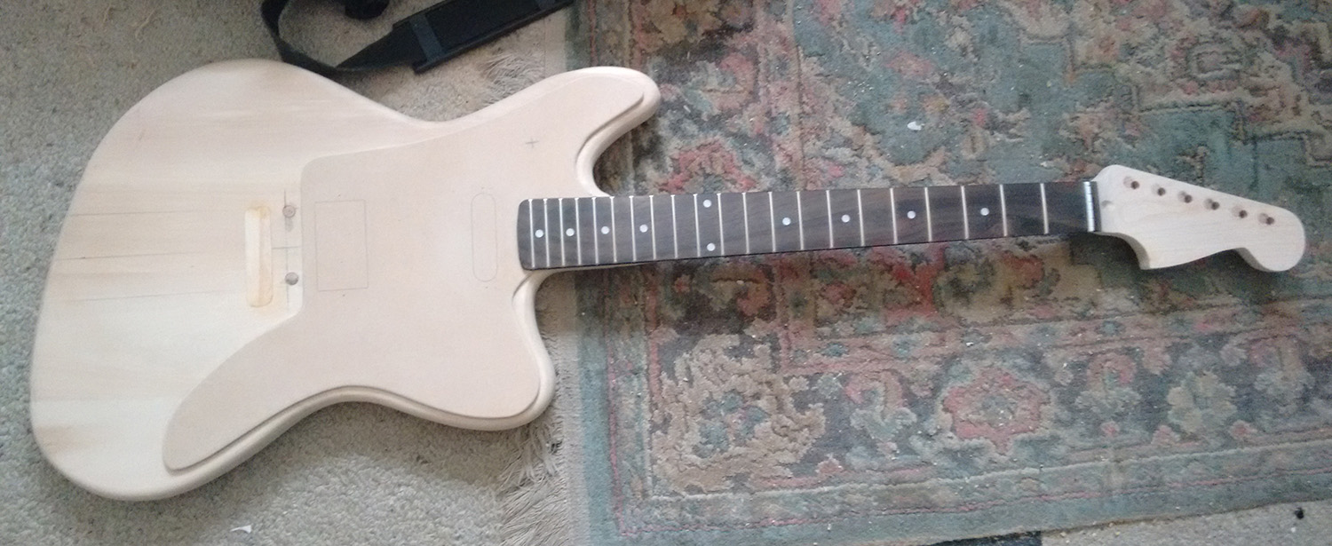

    Bursting through the gate...first off, let's sort out the neck.
Name:	04 straight neck.jpg
    Let's get it straight.

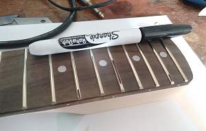

Name:	05 neck rockers.jpg

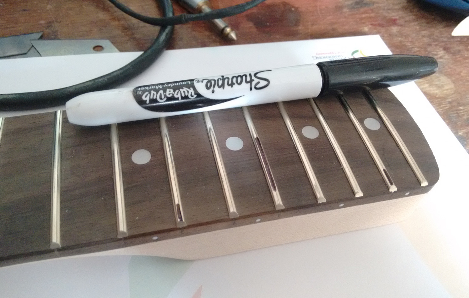

    Custom made fret rocker guages

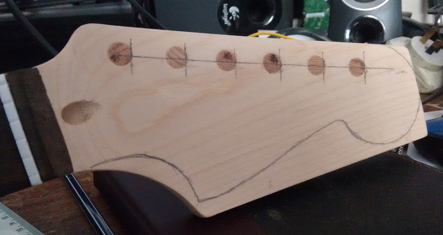

Name:	06 Marked the highs.jpg
    Marking the high spots.
    edit: notice the inappropriate use of the laundry pen...I'm gonna be in the dog-house if I'm not careful.
    cheers, Mark.

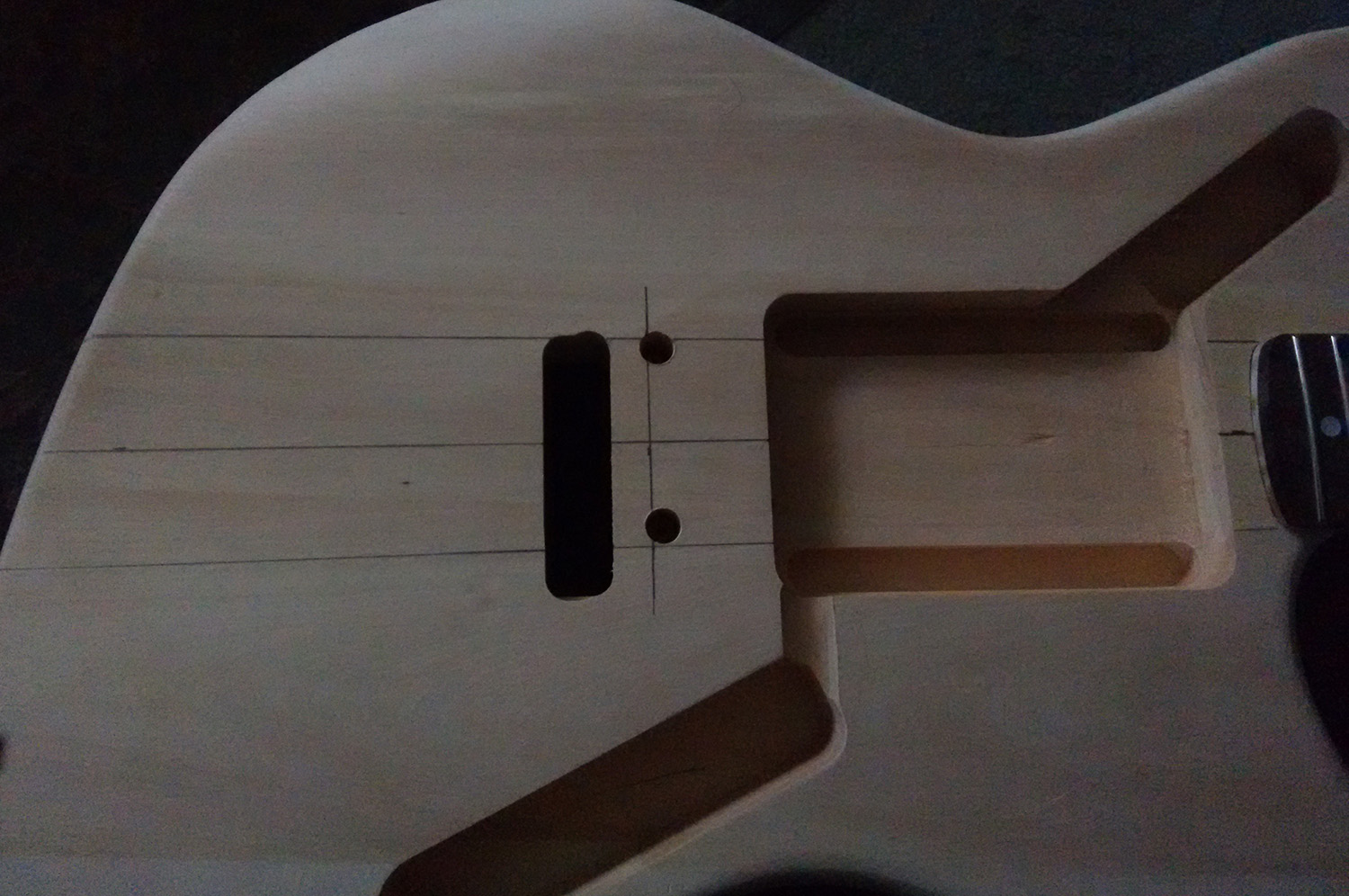

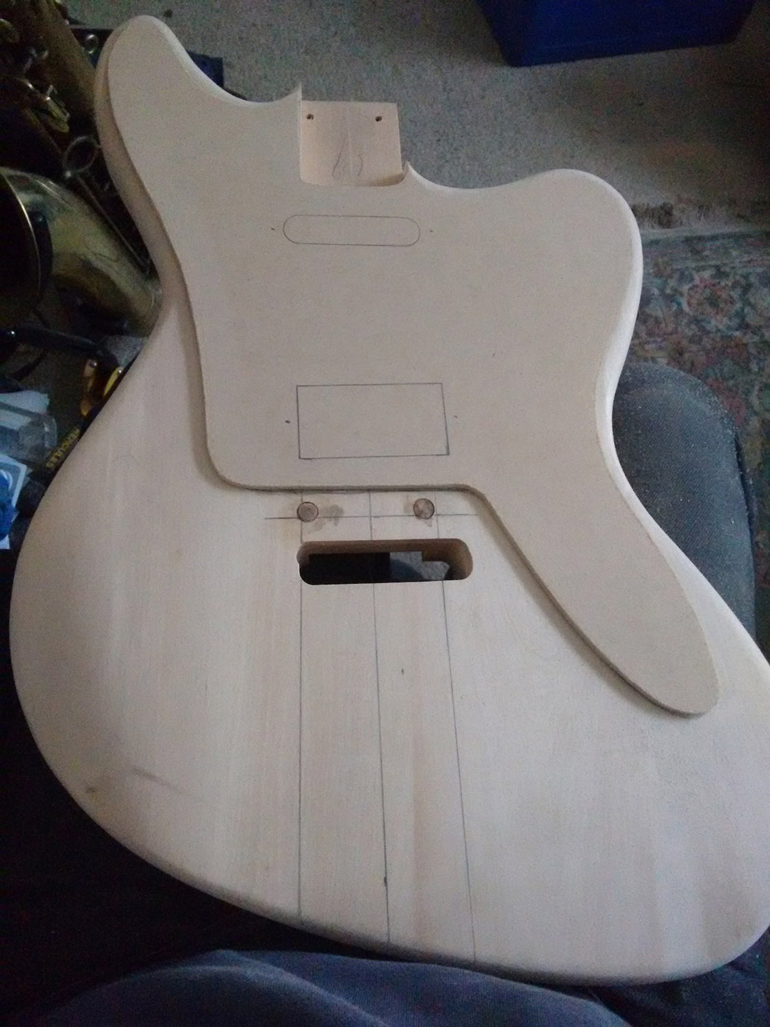

    One observation of this model is the pickup placement.
    I only play with fingers and no plectrum so the centre pickup will go.
    I'll shift the bridge pickup position further back so some routing is coming up.
    Another deviation from the standard is a Mustang/Jazzmaster tremolo.
    I'll probably follow nitroburner's tutorial and fill the tremolo cavity.
    So I'll be replacing the pickguard.
    I do have a blank sheet of brown tortoise similar to my strat/tele so that will get a trial.
    cheers, Mark.

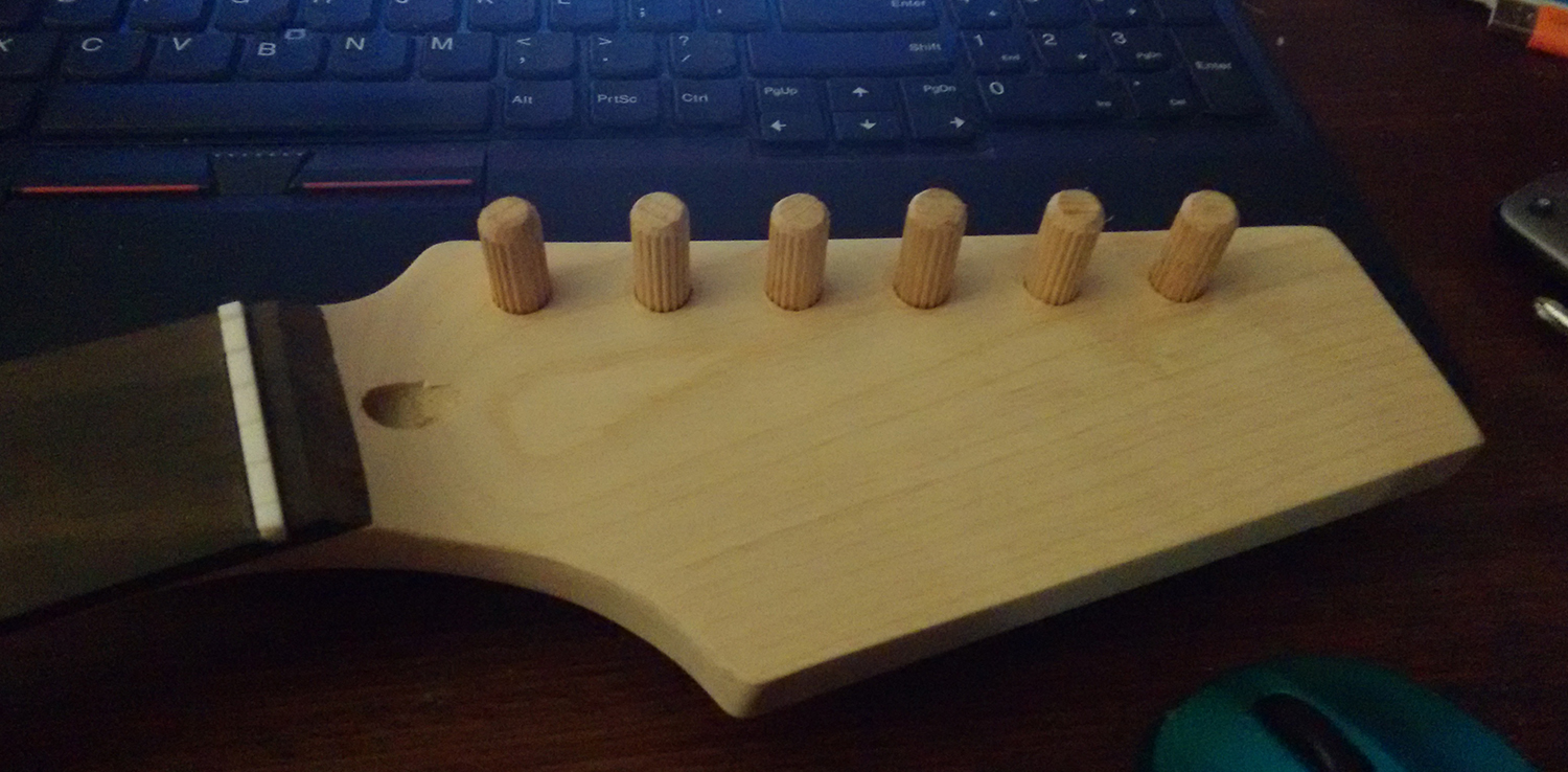

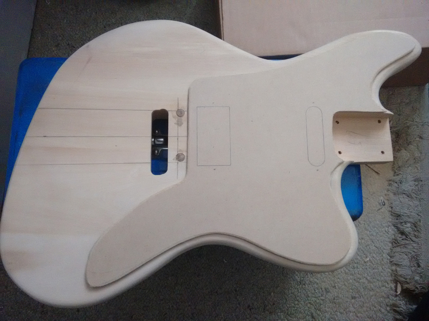

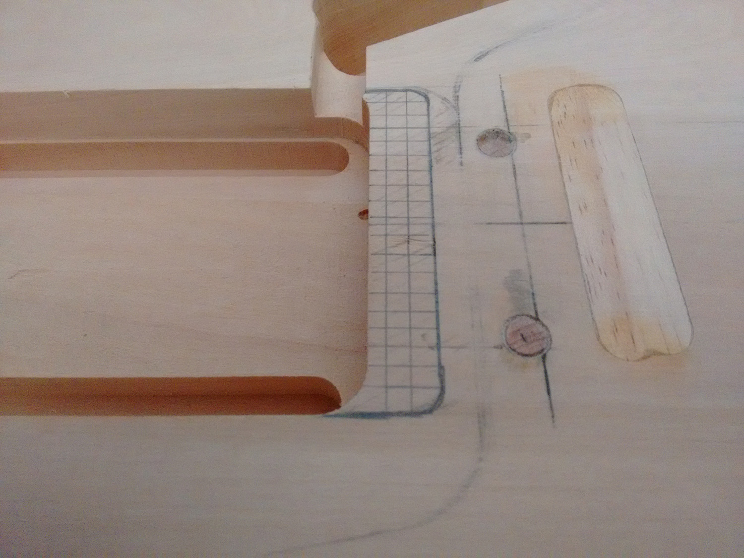

    Meanwhile....that sense of de-ja-vu.

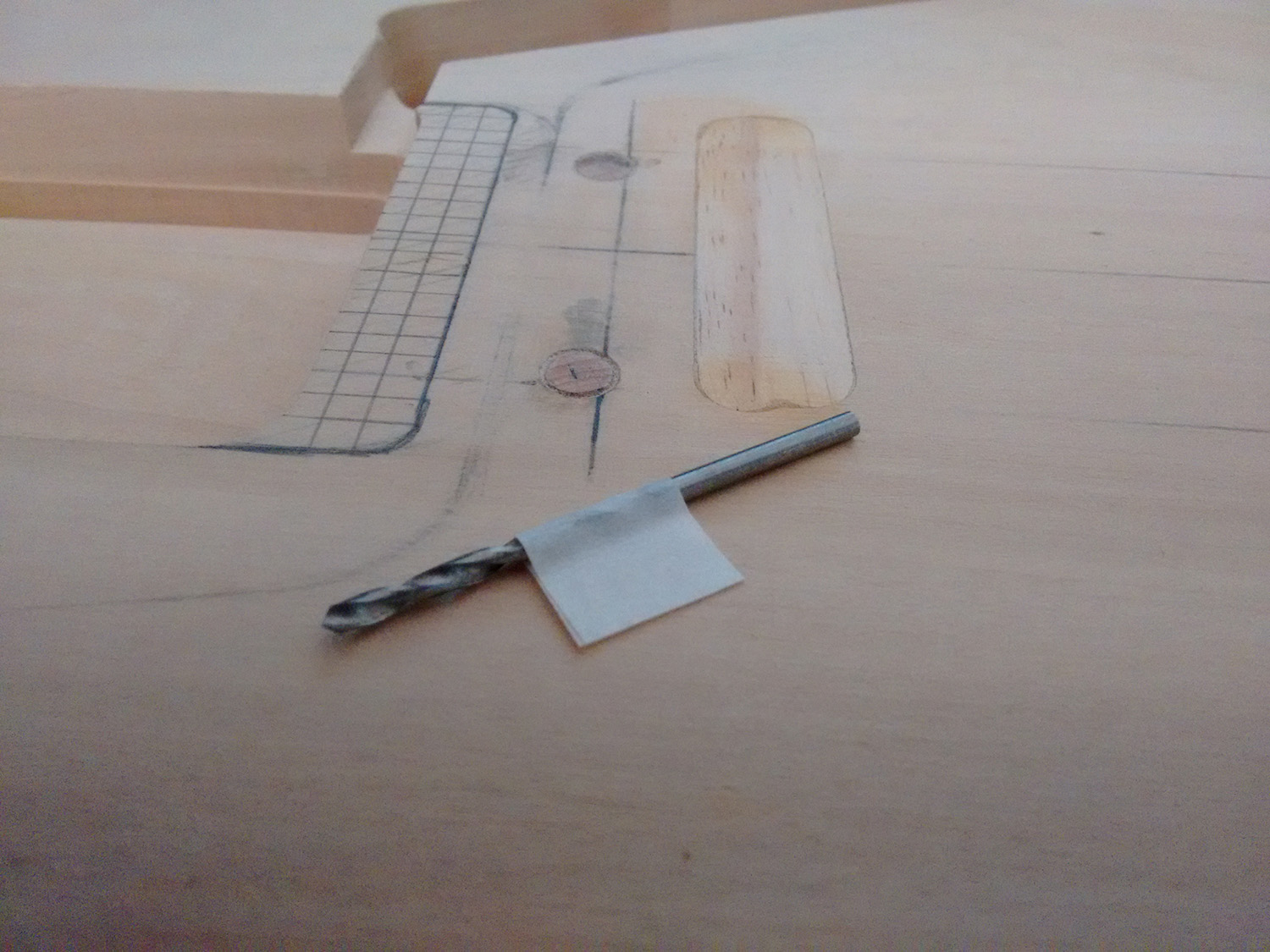

    edit: Discovered that these 10mm dowels (with a small amount of sanding) fit nicely into the JM-1 bridge post holes.
    cheers, Mark.
