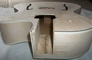

    Pic of a GR-1SF from when they were first added:

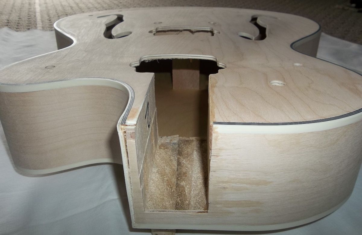

    Through the bridge pup rout towards the neck & cutaway:
    There may be a difference between current kits and the one in the PBG photo then. Might be worth dropping Adam an email to double check, and he may want to take some more photos for the web page if it's the case.
