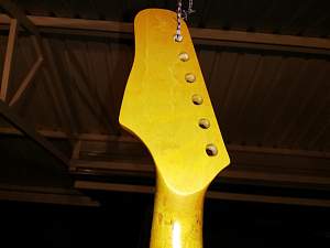

    i have noticed a few small beads of neck finish on my guitar headstock after a second coat of the stain ( maybee i put too much on at once) should i lightly steel wool the head stock before applying the finishing coat to the neck? with that smoothen it out? or a fine sand?
    5,666
    Can you post up a photo?
    you cant see it on the image i dont think it looks like very small granules and i am sure its not dirt. i used the same container to put my second coat of stain on the neck and the container had dried up...i should have used a clean container so i think ive put some dried up stain granules on with the second coat. any idea how to smooth it out or remove it please Frankenwashie?
