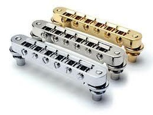

    Traditional ones....

    Sometimes we need to ponder the form over function concept as not all bridges have good mechanical design elements yet they may look super cool or become a must have thing to achieve that mock-up or retro look.
    Together with Nut & Tuners the Bridge is next most vital piece of hardware that can make playing and tuning your guitar a pleasure or a source of frustration due to poor design or adjustment limitations.
    The humble G style Tune-O-Matic has been around forever and I have never swapped one out or upgraded on any kit or store bought guitar. Usually there is just enough fore & aft travel to do string intonation but sometimes flipping the direction a saddle faces can provide a few extra mm's to play with. Biggest limitation is everything being held rigid in one plane where the only vertical adjustment is from outer posts at either side.

    I really like changing out the knife edge Gibson style bridge for the roller ones which are available very cheaply on eBay
    https://www.ebay.com.au/itm/Locking-...8AAOSwC6haqc6K
    Are they the same size posts and positioning or is dowel & re-drilling required?
    Mentor Andyxlh's Avatar
    1,206

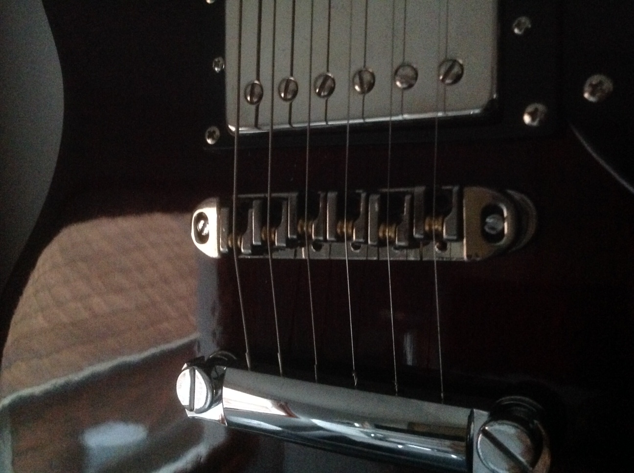

    The posts are smaller, but you can use the kit posts and use the threaded inserts from the bridge which have the same thread.
    Here's a pic of it on my SG kit. I think it's a huge upgrade. The posts holes themselves have grub screws to locate on the pin, and gives some additional back and forward adjustment.

    I've replaced the bridges on a couple of basses with higher mass ebay bridges. Biggest downside is that at their lowest, they are still higher than the standard bridges. This has led to needing to shim the necks on two basses so far.
    Yeah, know how you feel Brendan as the online measurements don't always cover every relevant bit and have also found this out the hard way. Hopefully they didn't cost too much?
    Moderator Brendan's Avatar
    Apr 2013
    3,444
    About $20@ and have used them all - just need to be aware that you may need to do some extra work on the kit to get the action right.
    I bought a cheap TOM style roller bridge of eBay. Won’t do that again. The rollers jammed pretty much immediately. If you are going to upgrade a bridge you may as well pay the bucks get something that you know isn’t made of mystery metal.....
    Yup Fretty, the ebay roller bridges look the same as the better quality ones until you have it apart and find the saddles are either wedged in tight or overly sloppy. I think I spent the best part of a morning with small files and a dremel making 1 good one out of 2 on my last build. Also the post spacing on them can vary enough to make it an issue. You can be lucky, I have bought a couple which were fine, I guess there are a few companies out there making them.
    Used Schaller bridges and tail pieces on a few and give them a thumbs up, bit pricier but nicely made.
    I've had good experience with Wilkinson strat trems, the block is actually steel rather than chitanium and a definite step up.
    I've used Bigsby's, licensed Bigsby and chinese bigsby and don't see any difference to speak of. Again, if you want to spend the $ ...Duesenburg, the Les Trem is the best trem system I've used bar none.
    I'm a big user of Tonepros bridges and tailpeces. I believe they are made for TP by Gotoh. I like the grub screw locking mechanism that helps stop them moving around. I do try and get all my posts as tightly fitting as possible using PTFE/plumbers tape or copper shielding tape (though that can be a very tight fit at times). More rigidity = something less to move and put strings out of tune.
