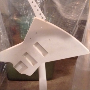

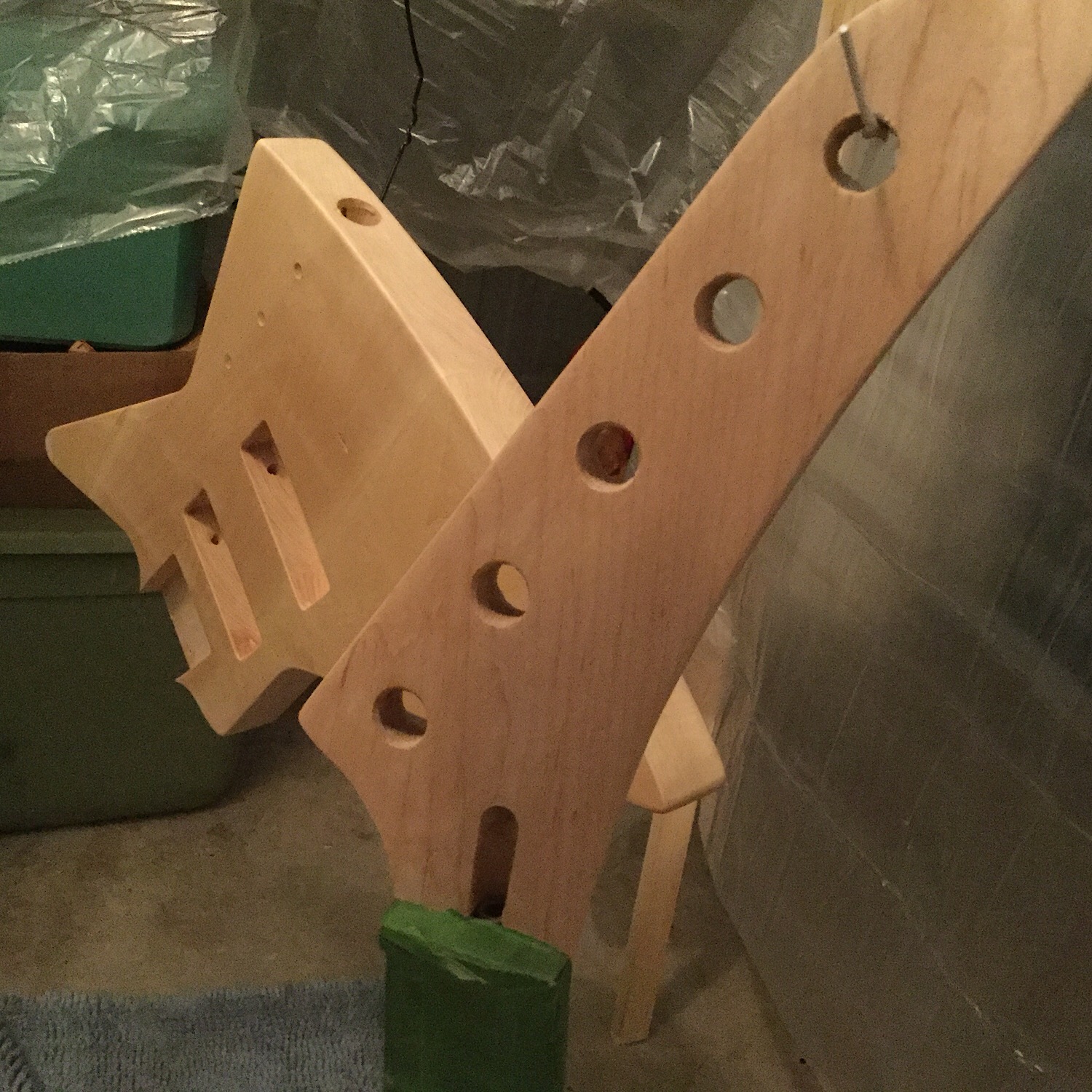

    My EX-5 bass kit has been sitting unbuilt in its box for a year and a half! I didn’t want to start on it until I could see the project through. Now, I’m ready!
    I’m going to sand and seal the body and neck today and let it dry all week.
    I also need to plan for the bridge mounting with a test fit. Here’s the 1st question:
    Do I NEED a drill press to drill pilot holes, or can I get away with using a hand drill?
    I was going to buy a dremel drill press but I don’t think it’ll reach and doesn’t look like it’s necessary.
    I’m going to take careful measurements for the bridge placement.
    The finished project should resemble an LTD EX-104 except with a natural clear finished neck.

    If you're using something like the bridges above - you should be right with a normal drill and being careful - have done it so far with a couple of basses with no issues. Check out the how to place a bridge for a bass guide here: http://www.buildyourownguitar.com.au...ead.php?t=3048

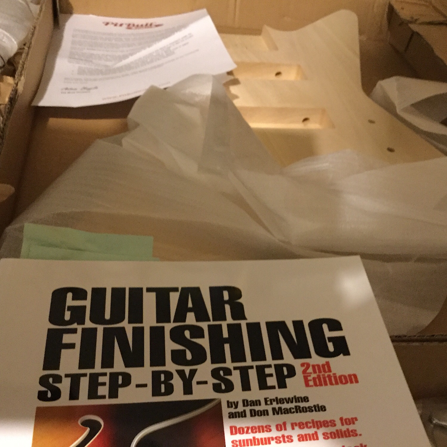

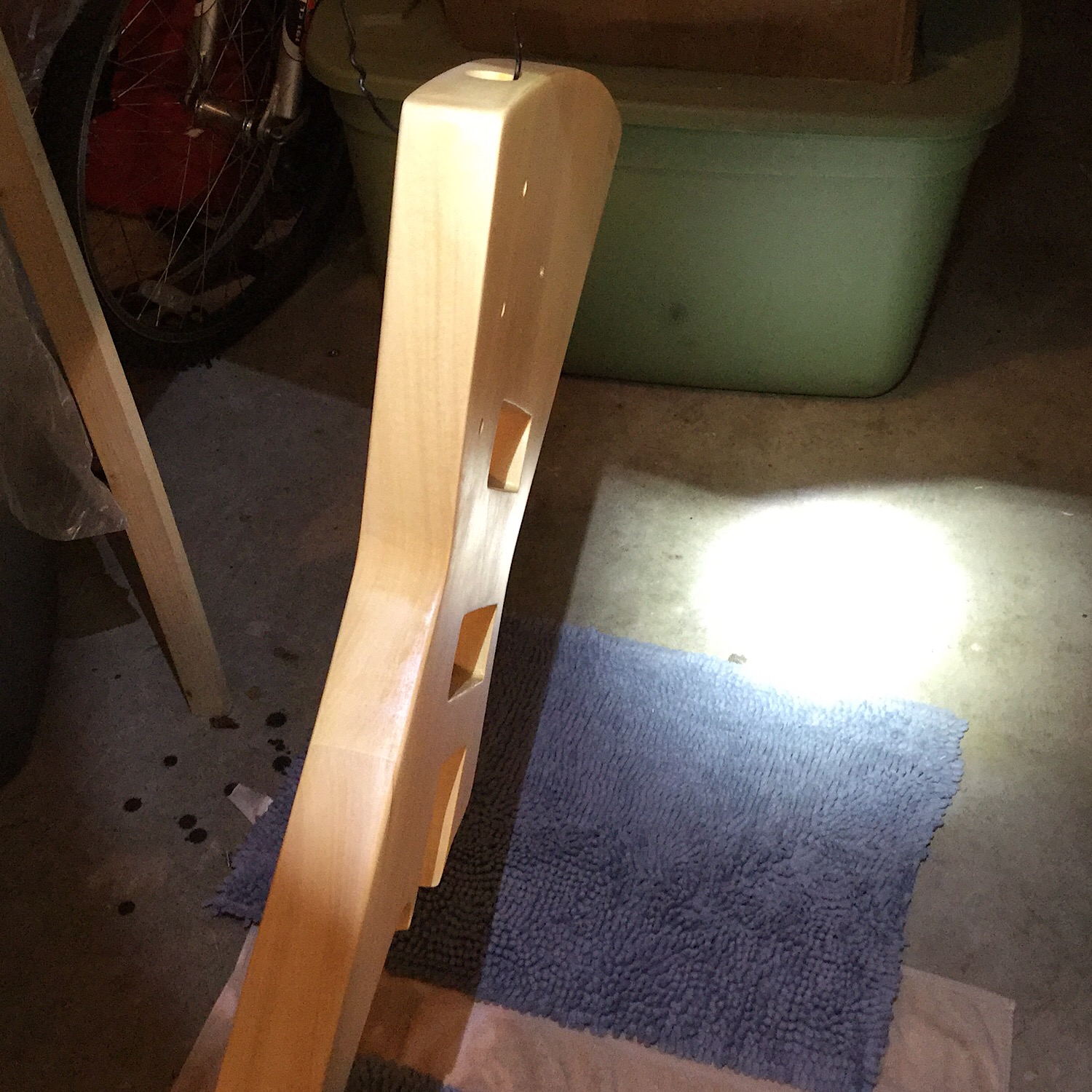

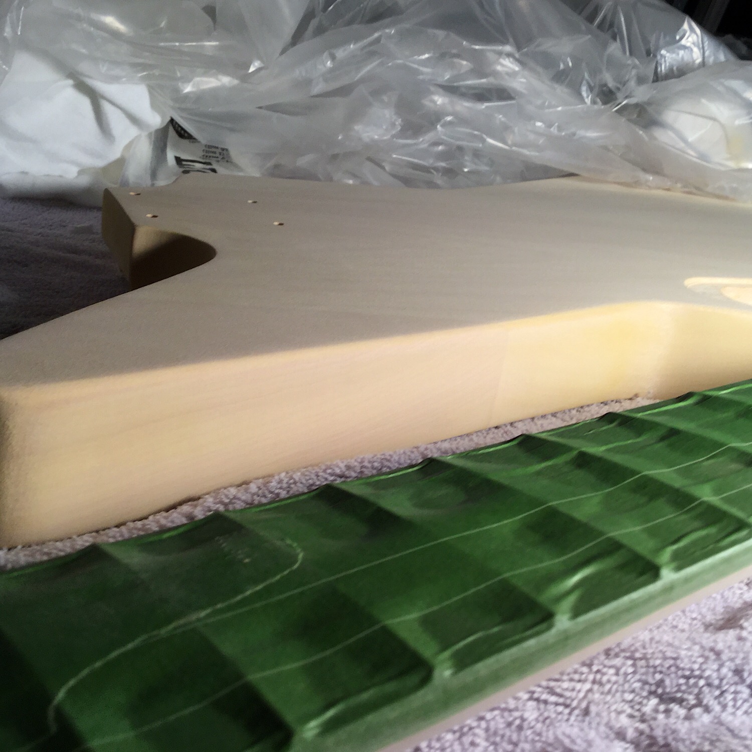

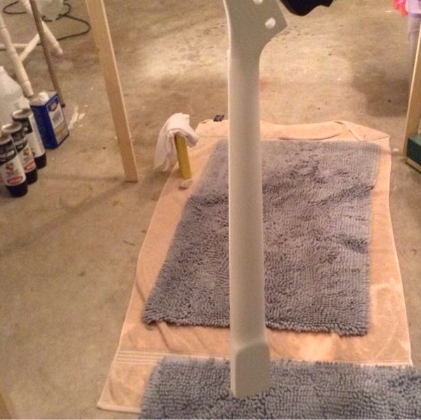

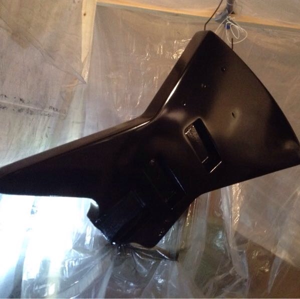

    Ok, I’ve built this guitar about 10 times in my head and believe I finally have a solid build plan. Last weekend I read the Guitar Finishing book from Stewart-MacDonald. I bought a lot of stuff too:
    1. Naphtha to degrease and de wax the wood
    2. Mineral spirits to remove any silicone left from the saw blades.
    3. Ammonia to be mixed with water to clean the naphtha and mineral spirits.
    Ok, that’s what the book says for wood prep before beginning.
    Here’s this weekend’s plan:
    Clean the wood, sand and sand some more stopping at 220 grit so the sealer and paint will have something to “grab” onto. Use grain filler, sand some more. Use sanding sealer, sand some more. Only after close inspection will I spray the first color coat.
    Sound ok?
    There’s a 3 day weekend approaching and I hope to get the color coats on then. Stay tuned...
