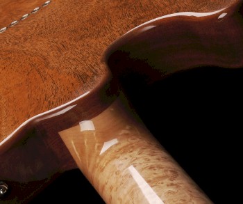

    I’m shooting for a similar result as is shown in this pic:

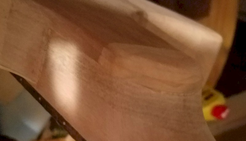

    There's a few that have done this, I did it with my EXA, built the heel up so that there was no step and then also profiled it for better feel playing higher.
    Adding material is probably preferable, if you have the means and the Mahogany. Given that the DC shape already has the neck out there a ways any removal might prove disastrous in the long run.
