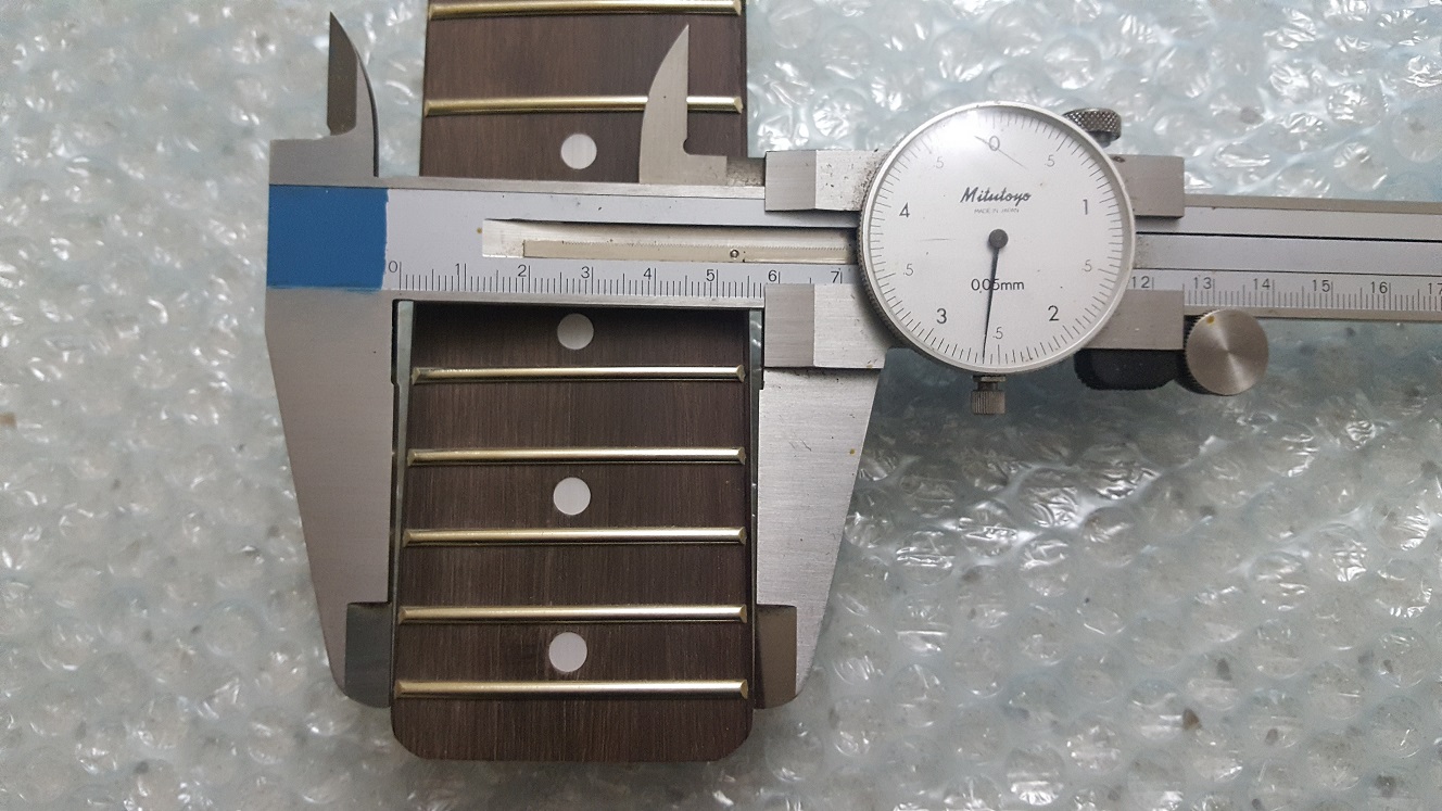

    At nut = 46.8
    At 12th fret = 55.0
    At heel ... not exactly sure what you want, at 21st fret I have = 57.6
    EDIT. I also have a maple 12 string PB neck, I can measure that one tomorrow if you like.

    Heard the call, ventured out to the shed in the dark of night... got you some figures Dave that hopefully set you in an appropriate direction...
    Have both a Tele 12 and a 35yo acoustic 12 so will pass on both sets of figures... Mostly so you have something (another 12 string) to compare it to. My Tele build is a Maple fretboard and there is a build diary which I think shows a few photos.The acoustic is a bound Rosewood.
    PBG TLA-12
    Nut 47.53mm x 22mm
    12th 54.91mm x 23.42mm
    heel 56.52mm x 27.31mm
    Strings at nut 41.17mm
    Strings a 12th 48.2mm
    35yo Eston acoustic 12
    nut 48.85mm x 24mm
    12th 59.7mm x 25mm
    heel 60.5mm
    Strings at nut 41.43mm
    Strings at 12th 47.8mm.
    Hope it all helps...
