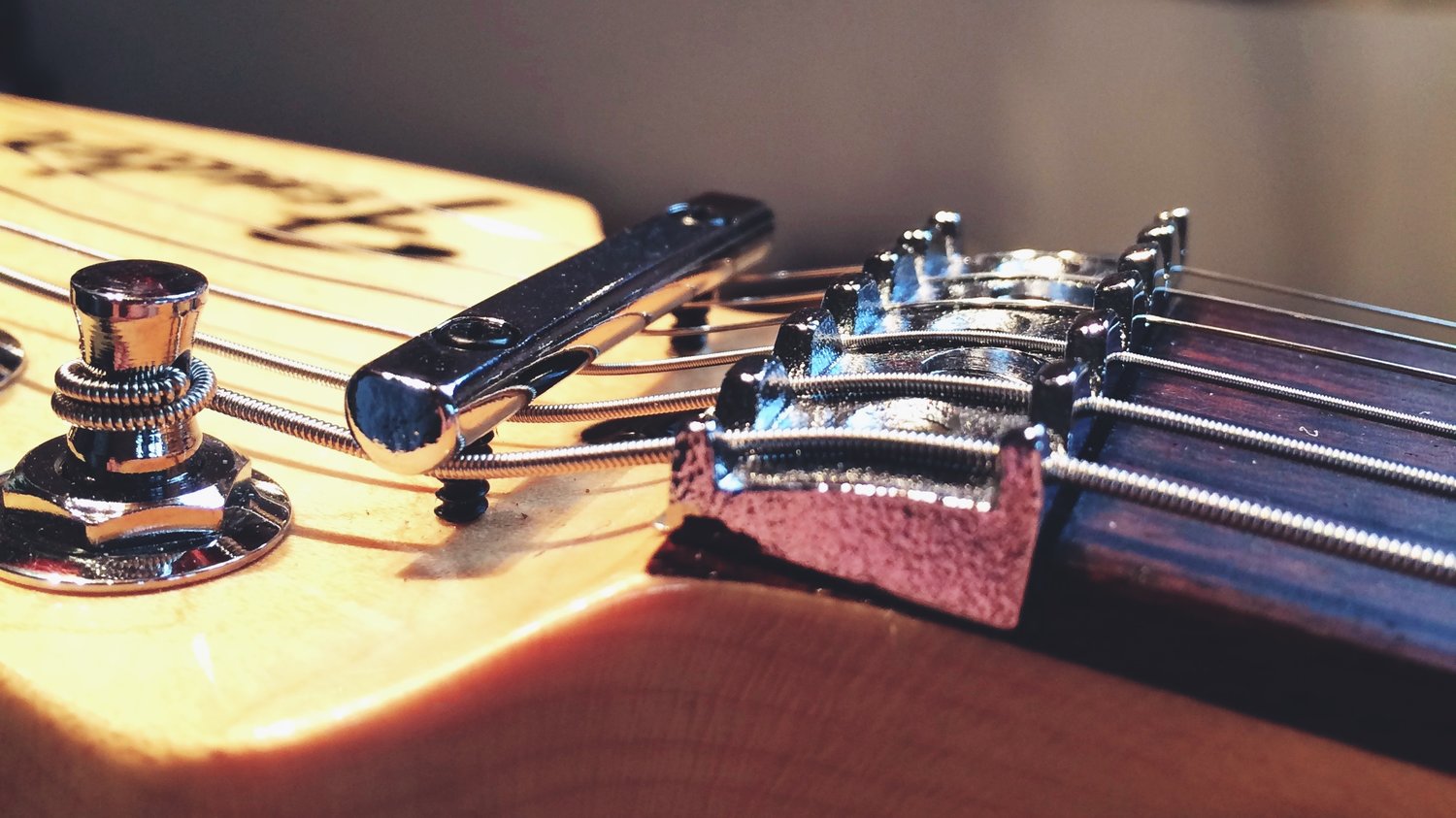

    I'd also suggest buying and fitting a string retaining bar for the headstock. Obviously you'll need a 7-string version. This fits behind the nut and should be set low enough to pull the headstock end of the strings flat across the nut itself as shown in the picture. They only cost a few $ and are easily found on eBay.
    This lets the string clamps work 100% on keeping the string from moving, rather than also having to try and press the strings down onto the nut at the headstock end, which is never as effective at stopping string movement.

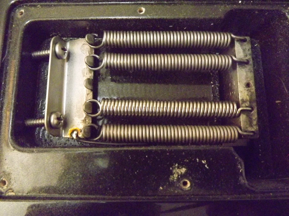

    Some good advice so far. Tony's suggestion, change the springs, I would suggest using 4 instead of 3. From Simon, Fit a string retainer, I've never seen or worked on a Floyd without one. Check Dr Nomis' suggestionsClick image for larger version.
Name:	Fender Heartfield Talon II.JPG
ID:	28222. I'm assuming you're in standard tuning adding a low B, also that the post mount holes were drilled precisely in the first place, and the bridge is level. It's double locking The only points of contact should be the knife edges against the V grooves in the mounting posts. Without physically checking the guitar, it's difficult to come up with anything else that it might be other than a poorly made bridge. Don't set it up until it's locked down and don't lock it down til the strings are fully stretched. I'm sure collectively the four of us have covered almost every possibility Evan. Just sorry your kid hasn't got his dream guitar yet.
