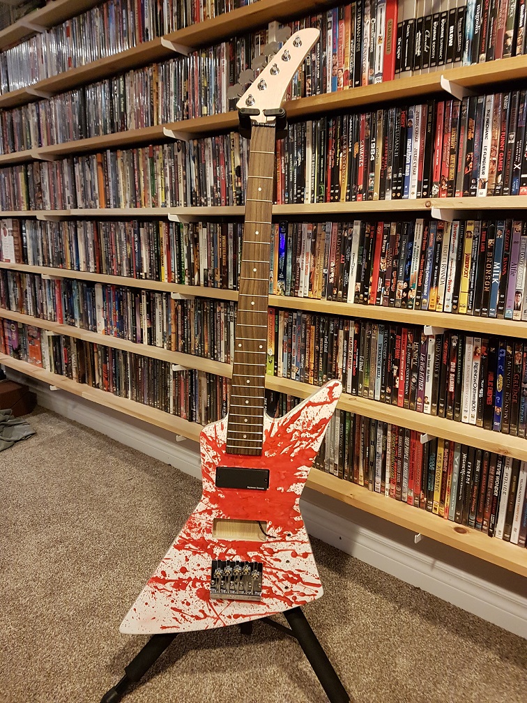

    Any progress photos yet for forum members to look at?
    EXA-5 blood bass
Name:	EXA-5 VH Blood bass.jpg
ID:	27977 Here is my take on Michael Anthony's Charvel blood bass - a work in progress.

    Haha, love it!...and that’s some book collection.

    Nice progress on the guitar.
    Your DVD collection rivals my wife's, actually you may have edged her out :-)
    Thanks guys! I've got a couple of coats of Tru-Oil on the neck and it's really coming along nicely. Really looking forward to having this thing playable! I've got 4 basses that I'll be using for the VH tribute - two detuned a semitone and two in standard. This will be one of my detuned guitars for the Roth era stuff. I'm also using a Yamaha BB detuned. Still trying to screw up the courage to scar it up like Michael Anthony's old warhorse. Lol... For the Hagar stuff in standard tuning, I'm using a Fender Mex Jazz and my Lace Helix as backup. As the Lace is not terribly "gig-appropriate", I may build another kit - perhaps a replica Jack Daniels bass!
    By the way, those DVD shelves are actually 18' long. I've got about 2500 titles - mostly purchased prior to the advent of Netflix and streaming video. Who knew?!
