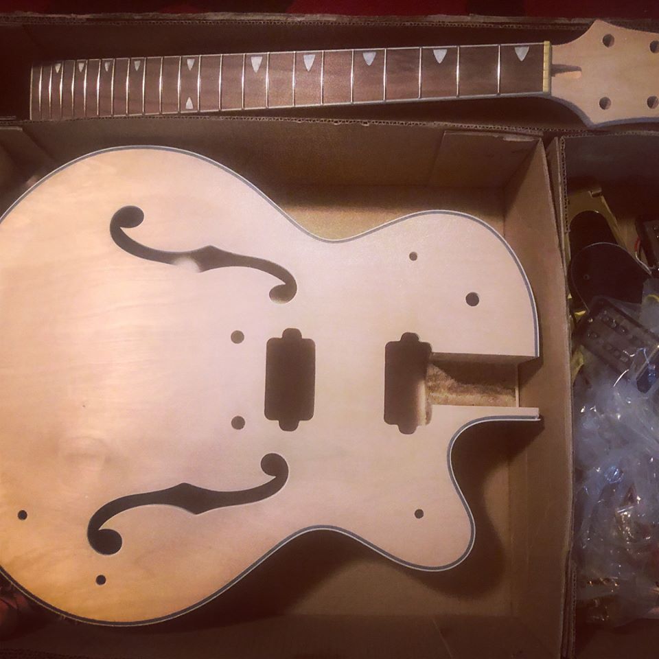

    Got the kit yesterday and couldn't be happier with components. Nice tight fit on the neck. Might need to fill in some very small gaps but thats fine with me. Almost immediately regretting getting a hollow body as i can seen a lot of swearing happening trying to get the electronics in there wired up.
ID:	27396   Click image for larger version.

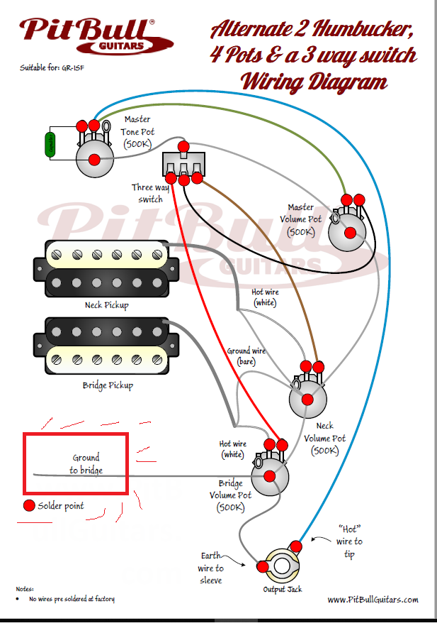

    Just wondering how people have been connecting the bridge to ground on these guitars.
    I understand i have to drill a hole into the body but is there really a cable that comes out and gets soldered to the bridge. I imagine on this style guitar that would be very visible.

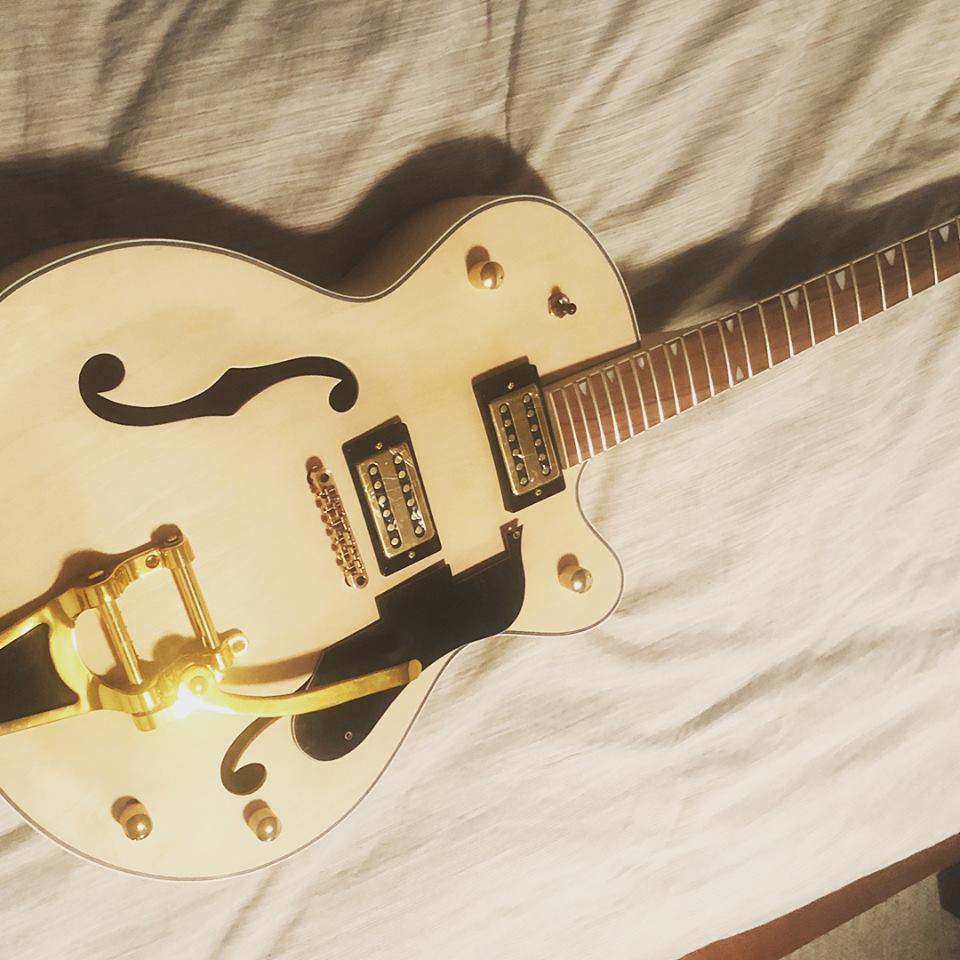

ID:	27438   Click image for larger version.

    Quote Originally Posted by 36 24 36 View Post
    No no no....you don’t have to do that.
    On a hollow body I made....and a number of others here....and in the Wiring section....you should find a helpful tip to just thread an earth wire out from inside the body through a drilled hole under the metal mounting points of your bigsby. The bottom end...next to one of the mounting screw holes is often used. Then strip a section of the insulation....fan out the wire nice and wide and flat and lay it underneath and with full contact with the metal body of the bigsby.
    That makes much more sense. Thanks for that.
